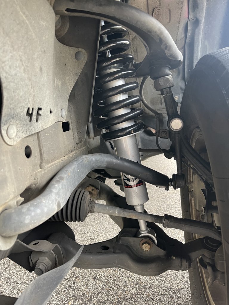

    Post pictures of the install homie.

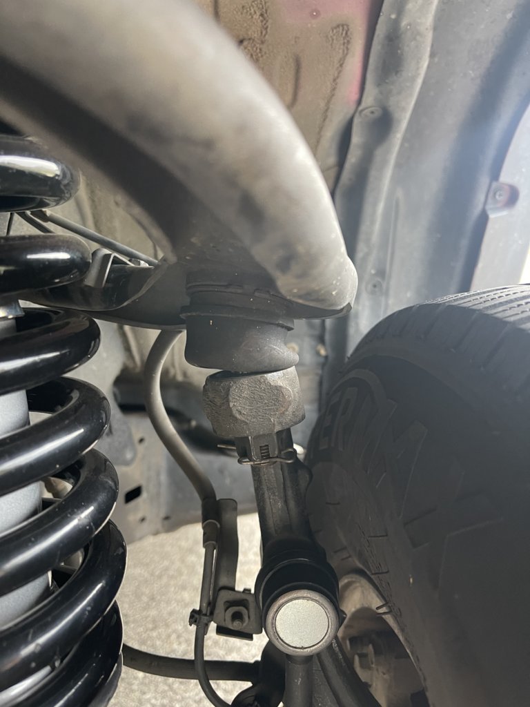

    Ok here are some pictures of how it’s sitting and the control arm ball joint.

    im just concerned about both control arms being squeezed together and not allowing the suspension to do its job.

    :eek::facepalm:agreed

    That upper ball joint doesn't look too happy now.......
    Look at that angle....
