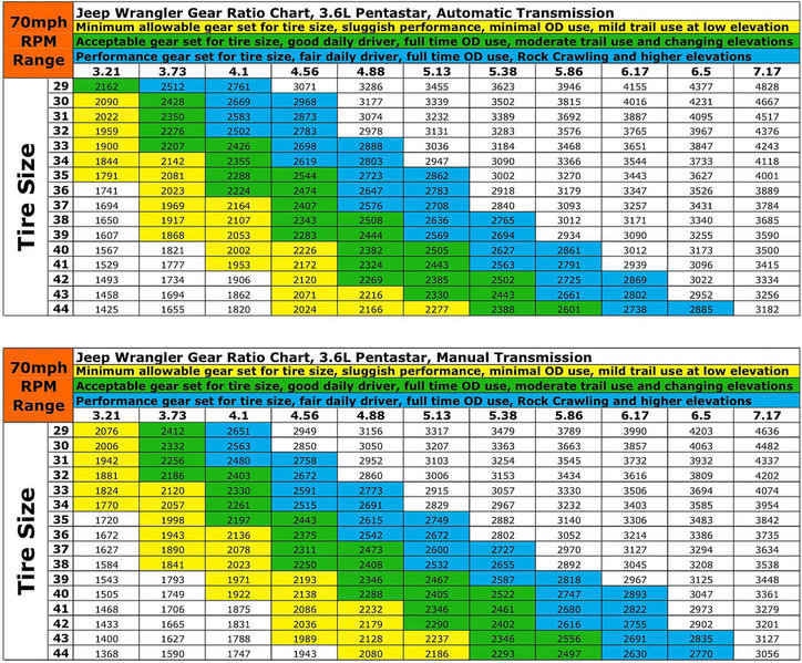

    Anyone got a chart identical to the Jeep JK gearing/tire calculations? Haven't seen one for the 3rd Gen Tacoma. Granted, other gears not yet available, but for reference.

    Yes,
    It's
    4.88s for what ever tire size you have because the don't make 5.29s. Lol

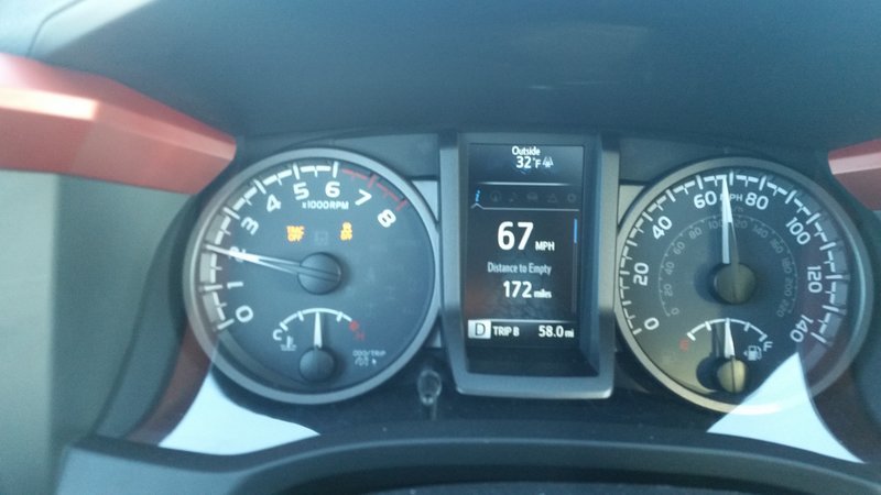

    Wow, your RPM's are quite a bit higher on the manual than on my auto. On the auto, we have that 6th gear, so about 2000 rpms at 67 mph.

    @joeco, if you have an automatic, get off the fence, it's 4.88 for sure!

    We have a 6th gear too, but its a diferent ratio.

    I need to pay more attention to my speedo I swear at 2k RPM I am 80mph haha. I need to check this, I am all stock.

    67 mph @2000 rpm looks good! Plus, I take it the speedo hasn't been calibrated yet?
