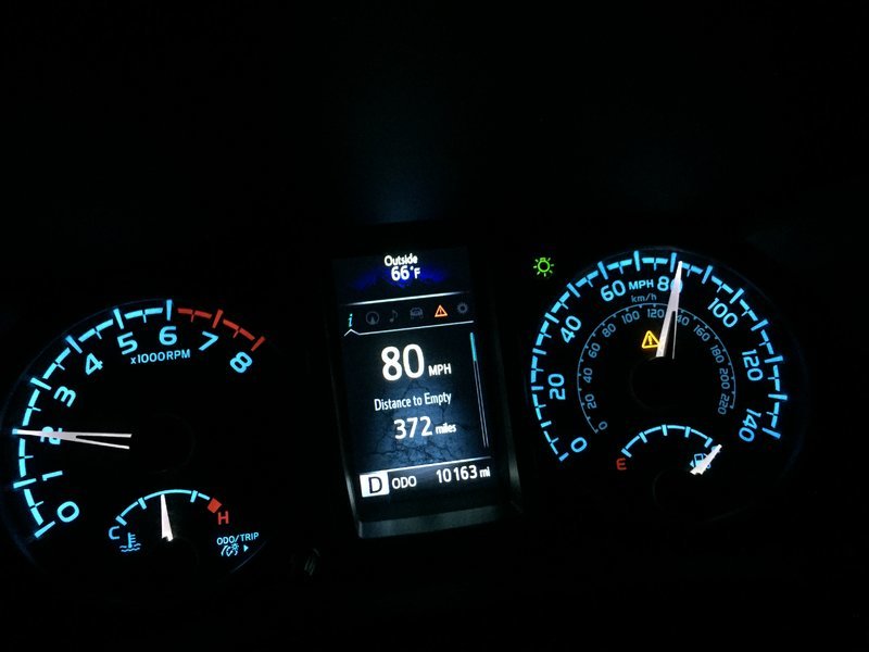

    2,000 RPM at 80 and it maintains it fine with our current socal conditions. High wind, it may downshift to 5th. I would rather have a gear setup where 2k is about 75mph as that is my average highway speed.. Unless the heavier tires etc cause the truck to struggle etc.

    Is your speedo calibrated, if not, you're actually doing more like 85

    I am all stock. Unless window tint counts as a mod.. I am just on here so I know what to gear my truck to when I do put wheels/tires.

    I'm not calibrated. 295 70 17. 33.5?in tire.

    So you are really doing like 85+ then? Because that is not really that bad..
