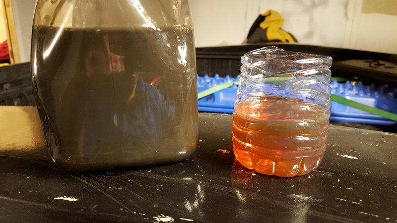

    Is it supposed to be this dirty? This is a year old fluid, from new 4.56 gears.
  20. Feb 15, 2017 at 7:17 PM
    #580
    mrnoodley
    mrnoodley Well-Known Member
    Oct 3, 2016
    #198854
    168
    Michael
    Toms River, NJ
    2017 Quicksand TRD OR
    That looks like it has some moisture in it. Not the worst I've seen by a long shot, but it's good to replace that with nice fresh fluid.
    Is this the first oil change, or did you change it at 500 miles on the new gears?
