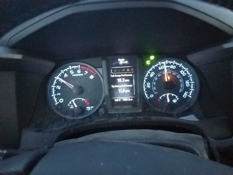

    For a few that doubt and for the others that have questions. Here is a shot from my drive home. The picture shows my RPM around 1700 @60mph . This is on a slightly up hill trip home. So on flat I'd say rpm would be a bit lower. Again this helped tremendously with the Hunting for gears. I would have posted higher speeds but my exit was coming fast when I figured it was a good idea to take a picture to share.

    Calculator puts you at 1,772 rpm @ 60 mph in 6th...
    You had it re-calibrated or confirmed with a Hypertech?
    I thought it was unnecessary; as the speed sensors are in the wheels.

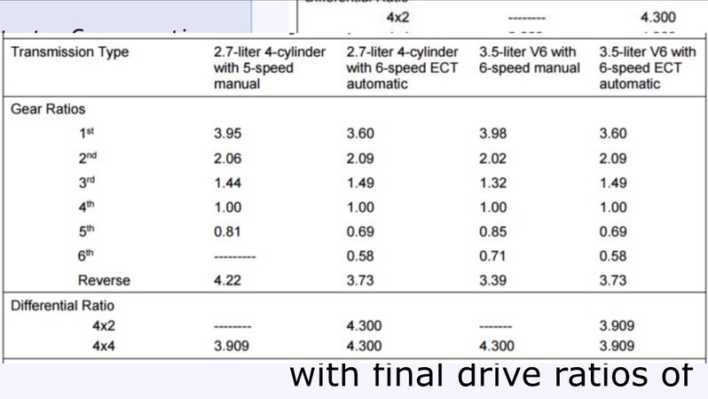

    Notice the overdrive gears (5th and 6th) when comparing mt and at... 6th gear in the mt is a tad lower than 5th gear in the at ....then take into consideration the differential is also a lower ratio (4.3) in the mt.
    4.88's in the at is most likely going to equate to similar rpms the mt will have in 5th and 6th overdrive gears at any given mph.
    A big question will be if the at with 4.88's will be able to tow in 5th. Will it be able to hold rpm's at 65mph in 5th while towing (reasonable weight)...4th gear (1to1)could be rendered too low with 4.88's unless you want to cruise 65 mph turning 3400rpm or so.
