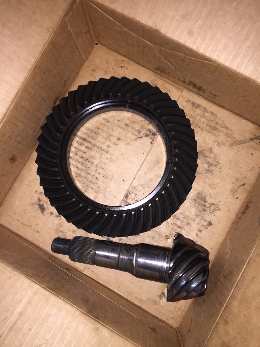

    Still have a set of 4.30 gears up for sale, buyer just backed out. $500 shipped in the CONUS.

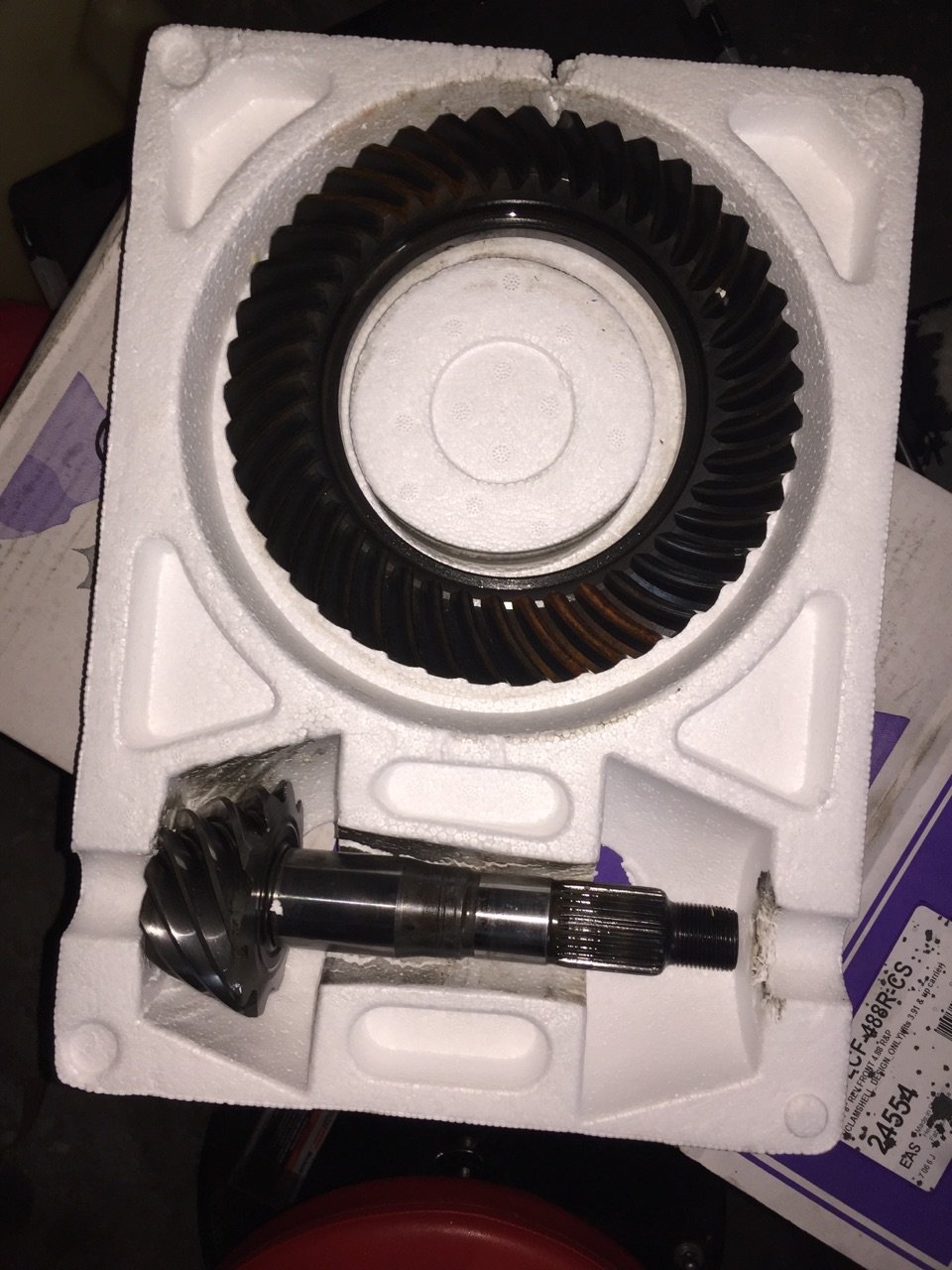

    More later on this since I’m in Oaxaca now for Christmas. Timewise, shipping is your deal both ways to Oklahoma City and the price for the service is $77/set. So, $154 plus shipping.
    The time for the service was just a couple days for me. I’ll post company and address later when home or sooner if I can find it searching with this iPhone

    Here is the information for the service of the REM process surface finish:
    ACG Enterprises
    c/o: Curt Geatches
    8600 S I-35 Service Rd Ste D
    Oklahoma City OK 73149-3101
    (405) 634-8656
    See earlier post #1005 for a link to a graphic video on the process.

    Is that all you shipped x2? Or the whole master kit
  8. Dec 23, 2017 at 12:21 PM
    #1008
    jomopdx
    jomopdx Well-Known Member
    May 30, 2016
    #188267
    281
    jomo
    2016 Tacoma Sport
    Yes, that’s it. Pack it well.

    I would ship it in styrofoam like the other one. But that is it. You would need a mini install kit to put them in a truck.
