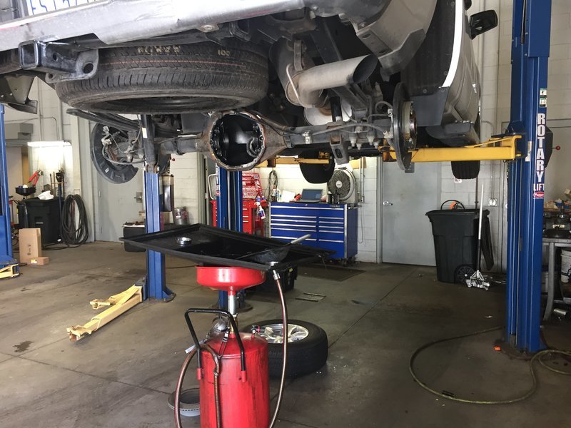

    I guess I am waiting on a crush washer!
    My shop told me the last guy that did it, is extremely pleased.
