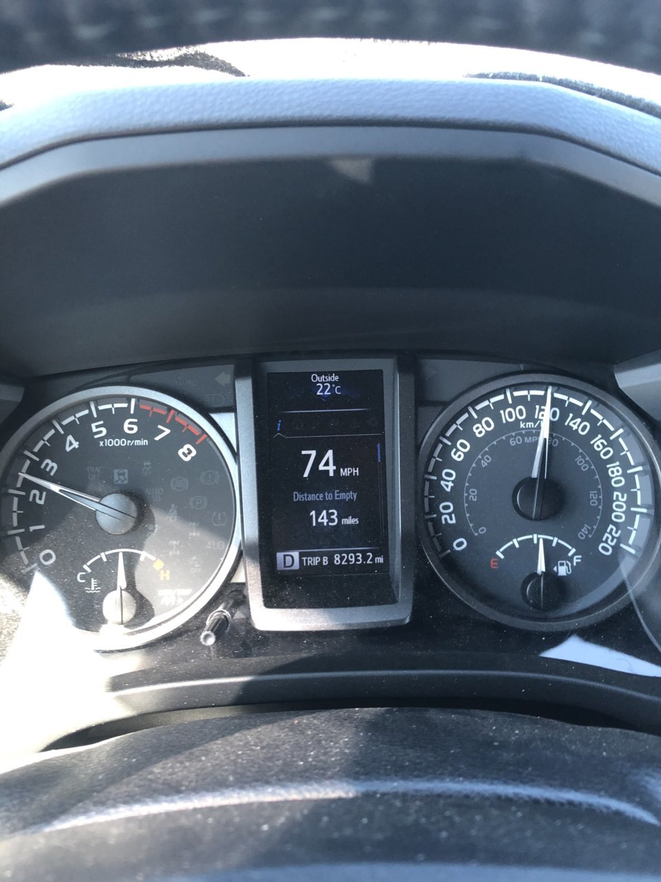

    So looking at that your at 2500 rpm at roughly 75 to 80 mph...
    That’s about 500 rpm higher then I am all stock, so at that rpm your in a better power band and not lugging.
    I understand that there are a lot of factors, driving style etc but what have you noticed as far as mpg is concerned..?
    Thanks for taking the time to post this for me as I really appreciate it.!!!
    Also I just noticed the reading on your dash is 74 mph.

    The dash is in mph for the yanks, but the truck is in kph. I am currently in the US, so having mph on the dash is handy from time to time as well. I generally have it set to the mileage screen.
    what I have notice so far is I am getting better mileage since I got the 5.29 gears. I believe this has to do with the AT using 6th gear more often. I found before it would switch between 5th and 6th all the time. Along with this, I have notice that the truck is better at getting into traffic when needed. It will never be quick, and it still has the same small delay in throttle response, but when it kicks in it goes. I will not get the throttle tune or what ever it is called, as I don’t feel it is truly needed. But each to their own. I will spend my money on some other silly thing I am a sure.
    I don’t baby my vehicles, but I do not bag it either. It is still a daily driver for me. The plan is to keep this truck for a very long time.
    I do not regret the re-gears one bit. I think Toyota should re-gear the AT to the same as the manual at a minimum. What would be better is to bring the diesel over to NA. I would sell this truck in a heart beat of America :) for a new taco diesel.
