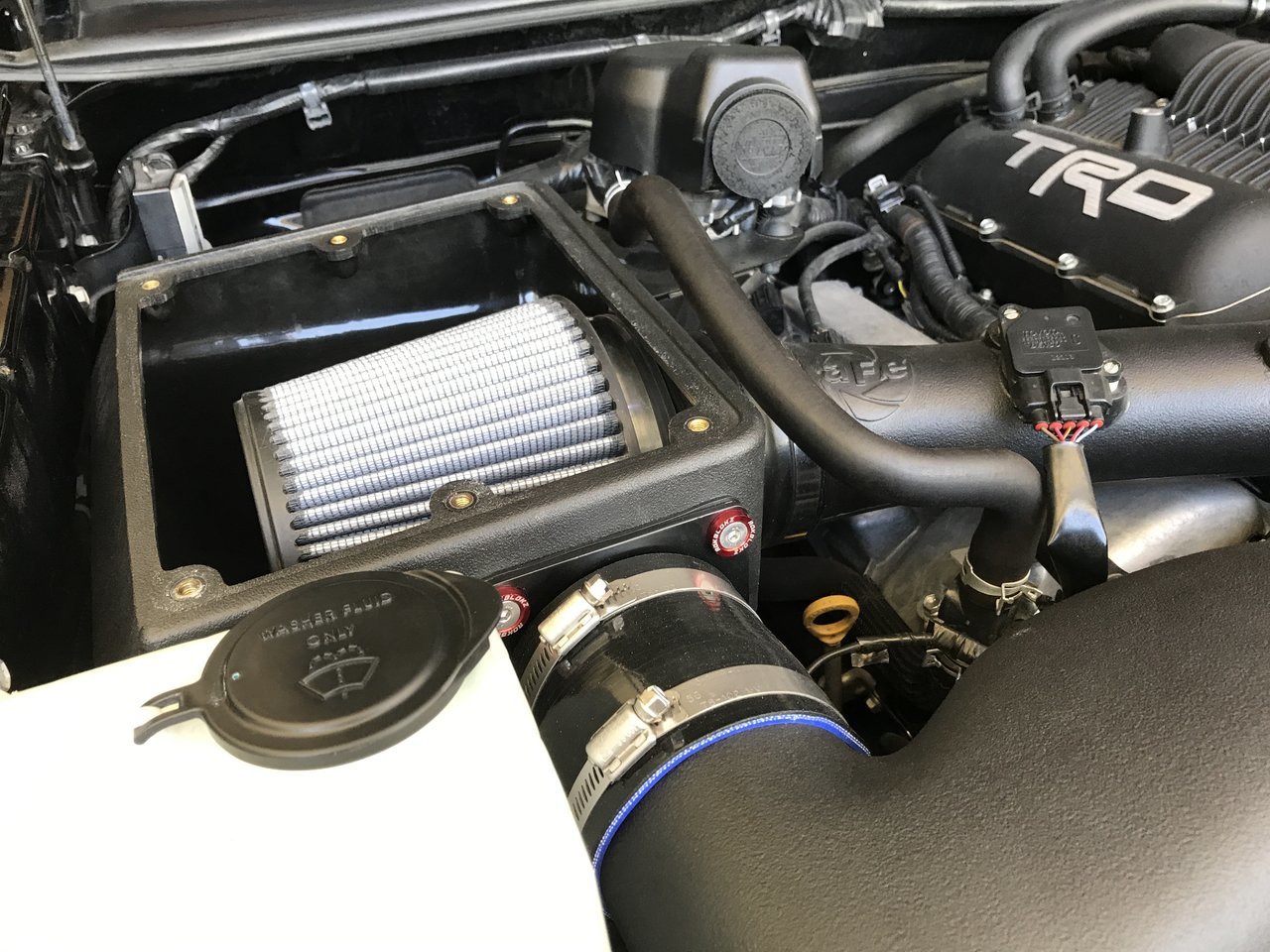

    So I decided to install a AFE Stage 2 Si intake with the Volant air scoop. All credits goes to a great guy by the user name of Murderface on XRU. My thoughts.... It definitely lowers the drone sound from the Gibson cat back I have on and that exhaust is already quiet as is. All setup for the blower down the road :thumbsup:

    Hey just curious on how you fit the Volant ram air on the AFE?? I want to do the same!

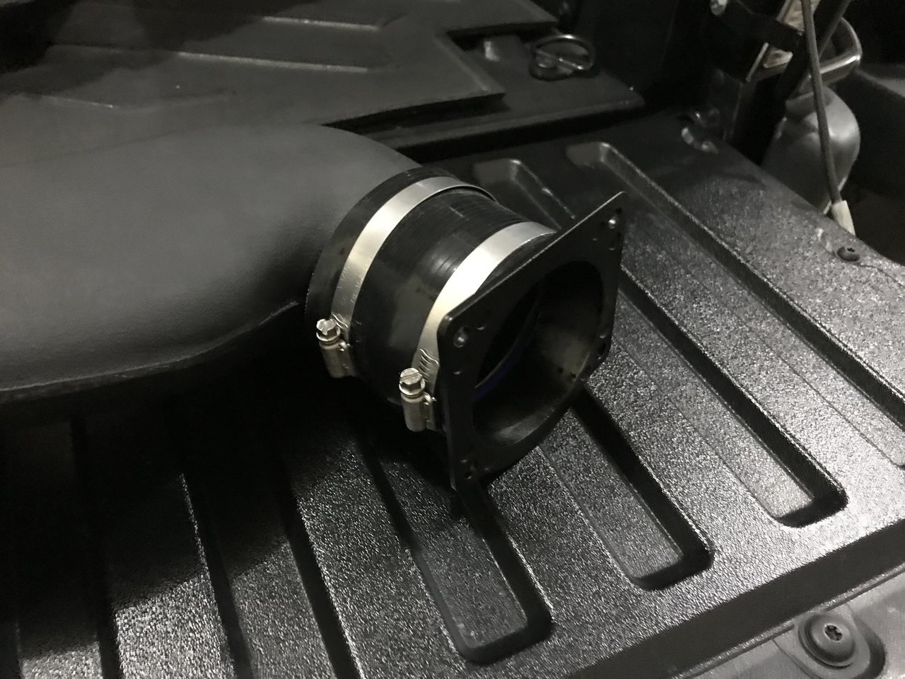

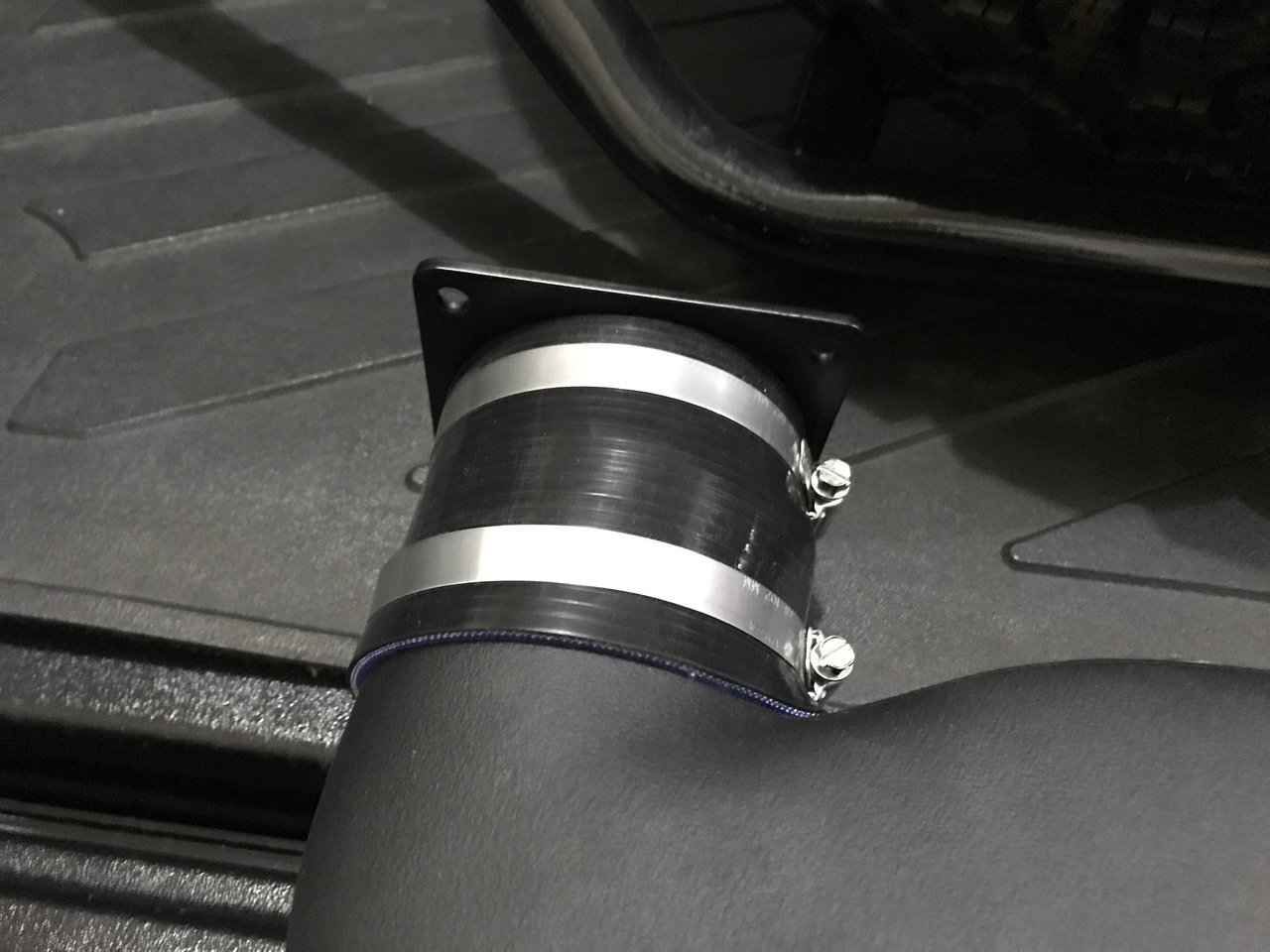

    1) cut a big f'ng hole in the front
    2) find PVC that fits in hole or something like this:
    3) screw in place with layer of RTV in between
    4) fit together using appropriate sized Home Depot PVC adapter or similar sized Silicone hose
    5) Marvel over destruction you did to your $350 intake

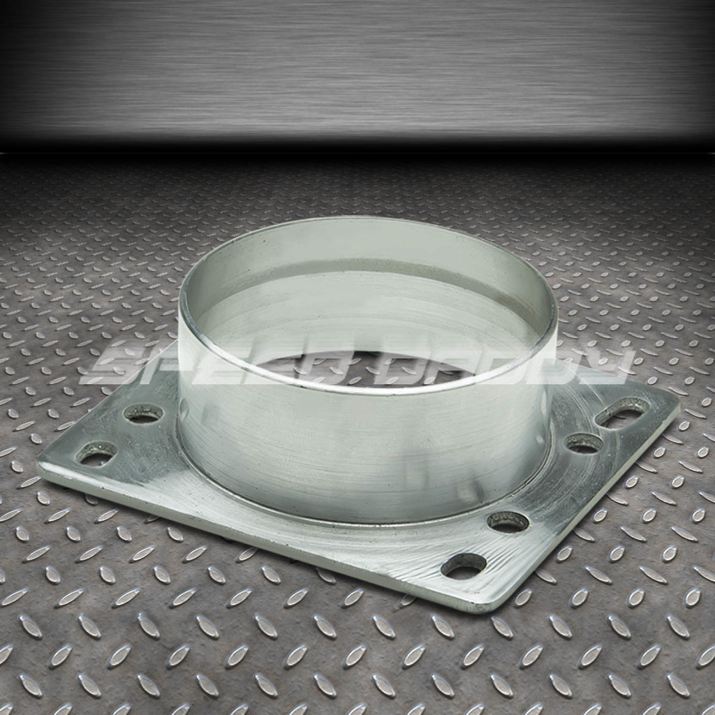

    I found that aluminum part on eBay, Would it work due to it being 3" or do I need a 3 1/4"?

    It should work. IIRC the hole saw I bought was 3 1/4" to drill the hole out and fitted a PVC union coupling of 3" it's been awhile so don't quote me on that. Just measure the outside diameter of the Volant air scoop hose and transfer the info to the air box. It's not really rocket science to it.

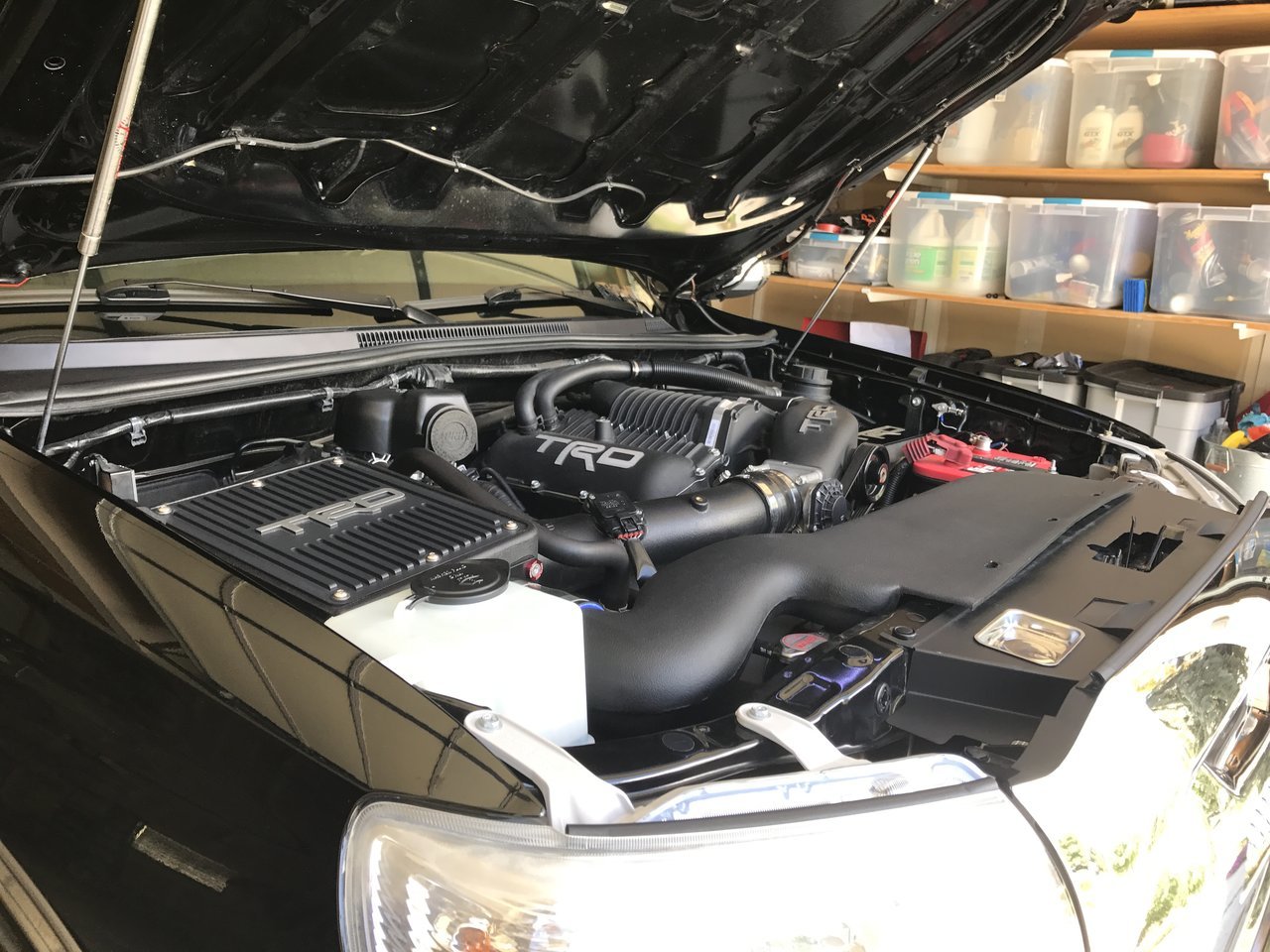

    Finally got the Volant Ram installed!!! Need to get some new plastic retainers as I broke all of them lol!

    where did you get that TRD cover for ur filter box? things legit and now I want one lol
