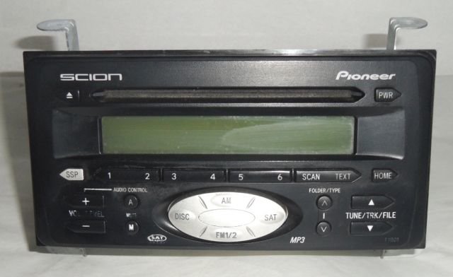

    I put a double din from a Scion in my truck when I first got it. It bolted right in & the plug was the same. Only thing I had to do was trim the border/lip on the back side of the radio/ac vent bezel. Did not affect anything cosmetically. I think it was from a 1st gen xB. Got it for $50 & only reason I ran it at the time was cause it played MP3 CDs. Damn thing was kinda ugly though. I eventually got rid of it though & got an Alpine.
    EDIT: This is the one I had.
    The Driver[OP] likes this.

    That is exactly what I was looking for! Thanks ace!!!

    Also, IIRC, you have to use the brackets from the stock radio, they bolt right onto the Scion radio. But then again, not sure if the Scion uses different brackets, I got the Scion radio with no brackets at all.
