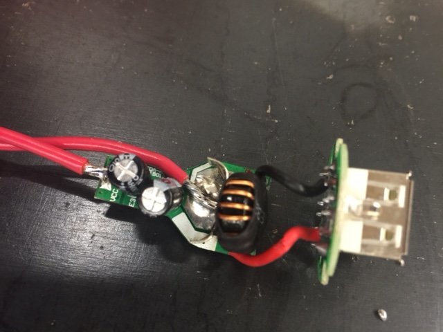

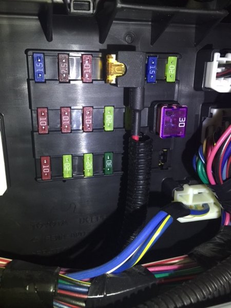

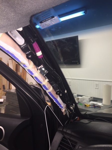

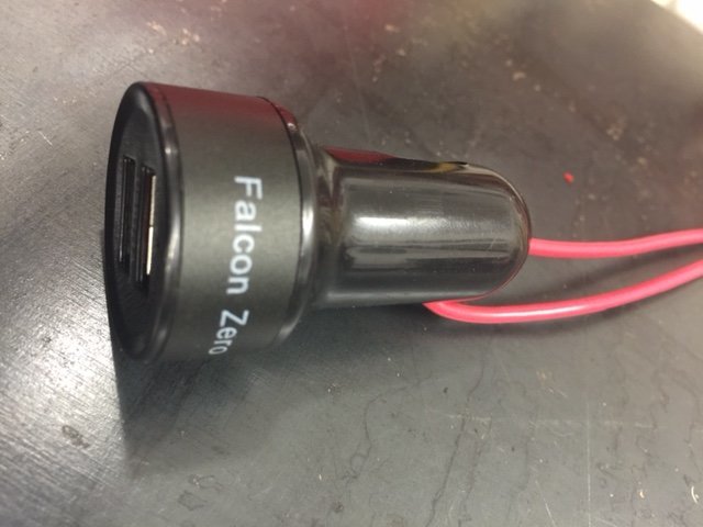

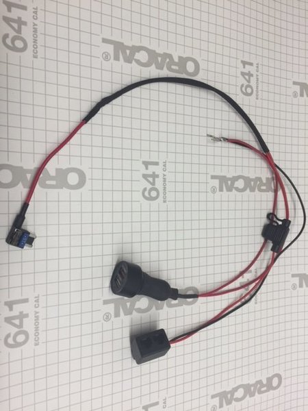

    For the installation, I hard wired both accessories utilizing an add-a-circuit on the interior fuse panel (tapping into the ACC slot). The V1 takes a 12v source, so that was a pretty straightforward connection. The Falcon Zero dash cam is powered with 5v and utilizes a USB connection. For this, I converted the 12V to 5V USB adapter to a hard wired unit and tucked it in behind the driver side kick panel under the interior fuse panel (to the left o the parking brake - that cover) after running both wires for the V1 and the camera along the inside of the headliner and down the pillar.

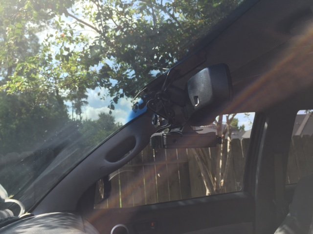

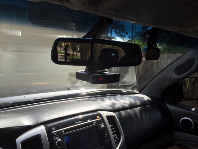

    The camera is mounted using the suction cup mount that came with the unit. For the V1, I purchased a rear view mirror mounting bracket. That works out very well in fact.
    Wires being run down the pillar:

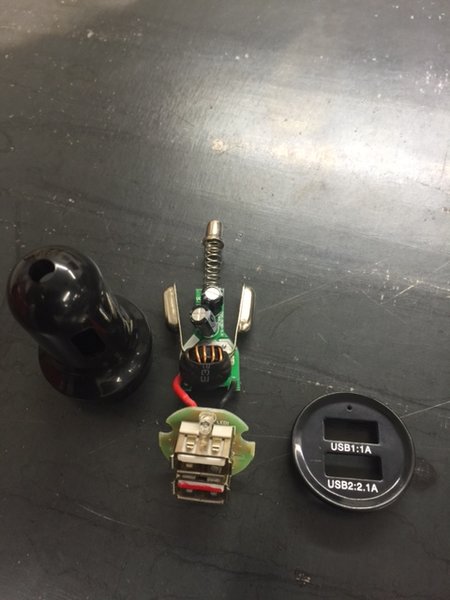

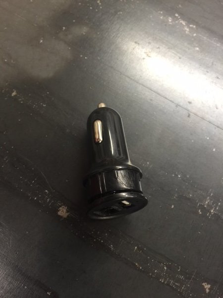

    Falcon Zero 12v to 5v USB adapter before:
    Adapter taken apart:
    12v outlet contact points removed and replaced with soldered wires:
    Adapter reassembled:
    The add-a-circuit wired to both the V1 and the Falcon Zero power plugs:
    The add-a-circuit placed in to the Tacoma's ACC slot:

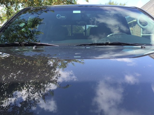

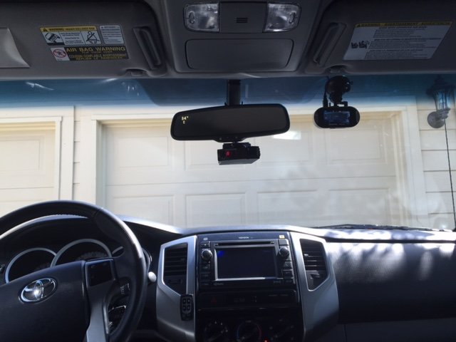

    View of the new accessories installed:
    What these look like from the outside of the truck:
    View from the driver perspective:
    Showing the V1 mirror mount:
