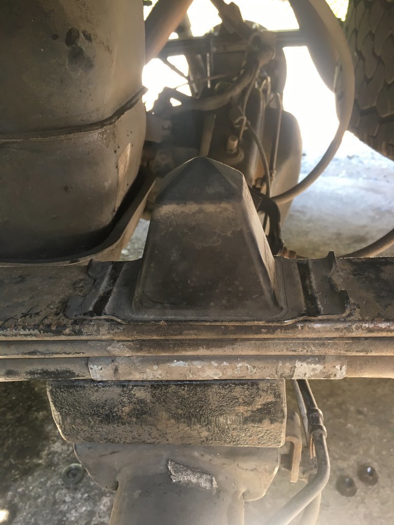

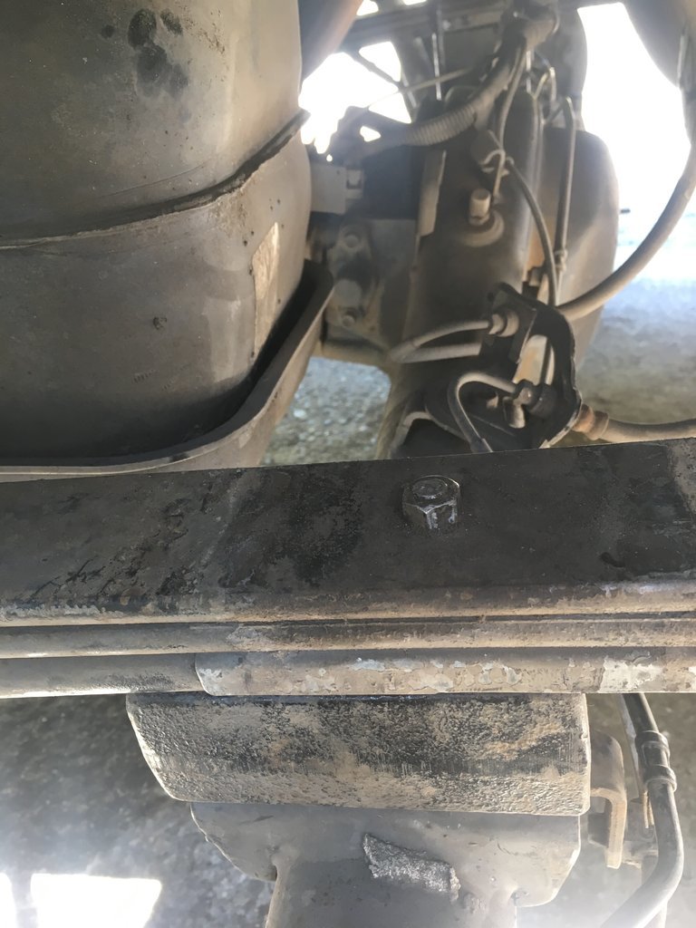

    No problem. Does anybody know if this is normal? The centering bolt doesn't look center. Left drivers Side
    08tacobear[QUOTED] likes this.

    Another pic with the bump stop it doesn't look right

    Theres your problem man.... that axle is a solid inch off center.... pull the block out and make sure you actually have it installed properly. There are probably voids in the top of the block other than the centering hole that the leaf pack is currently in.
    Something like this
    And the pin of the leaf is in one of the square holes when it should be in a center small hole designed for the center pin.
    ALSO NOTE, those blocks look tapered. Put the SMALLER edge to the front to point the pinion up.

    Nope...centering pin isn't in the hole...check to make sure the block is ok...you need to lower the axle and align the pin
    MattScatt28[OP] likes this.

    Yup! That's what I figured too. It's in the void haha thanks guys! Really appreciate it!

    And like stated, make sure that block has its smaller short side at the front (tapered smaller forward facing on the truck) ON BOTH SIDES.
