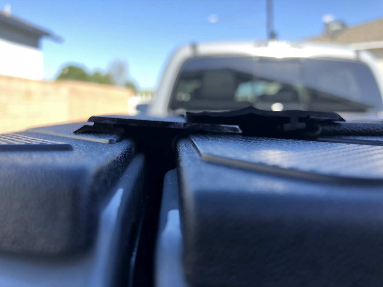

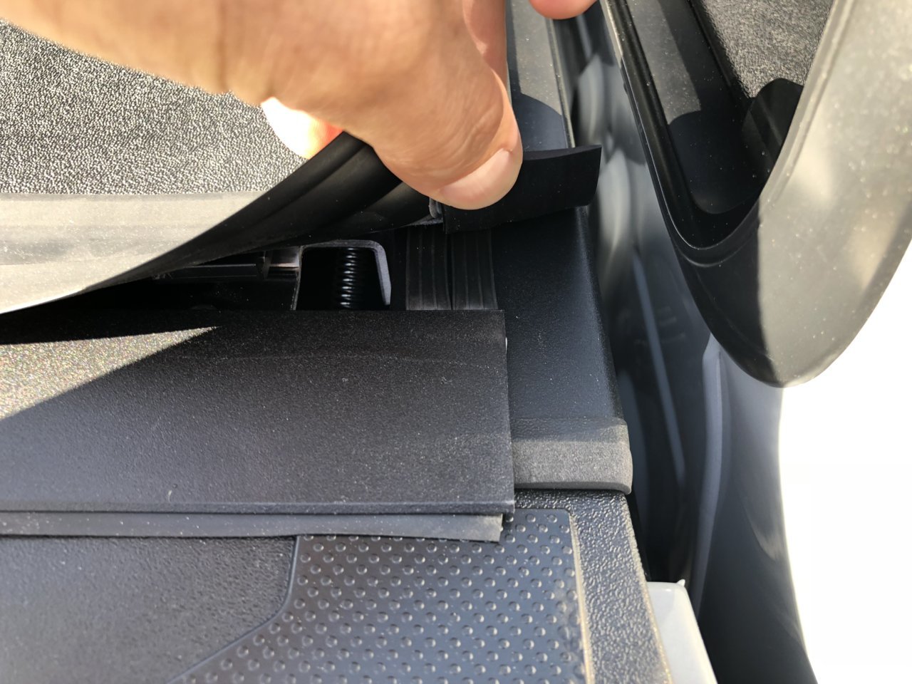

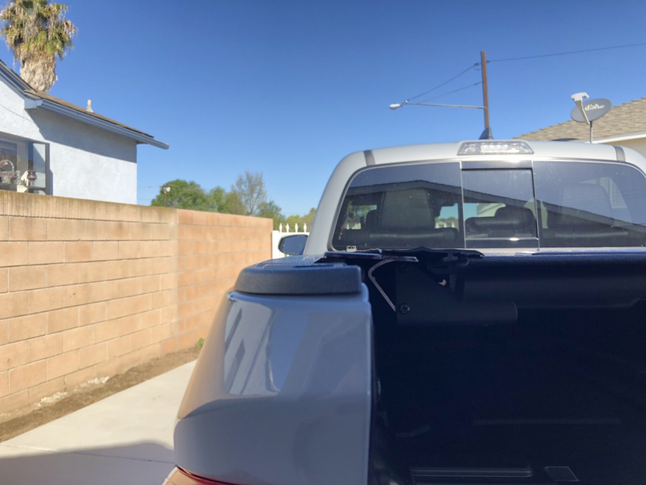

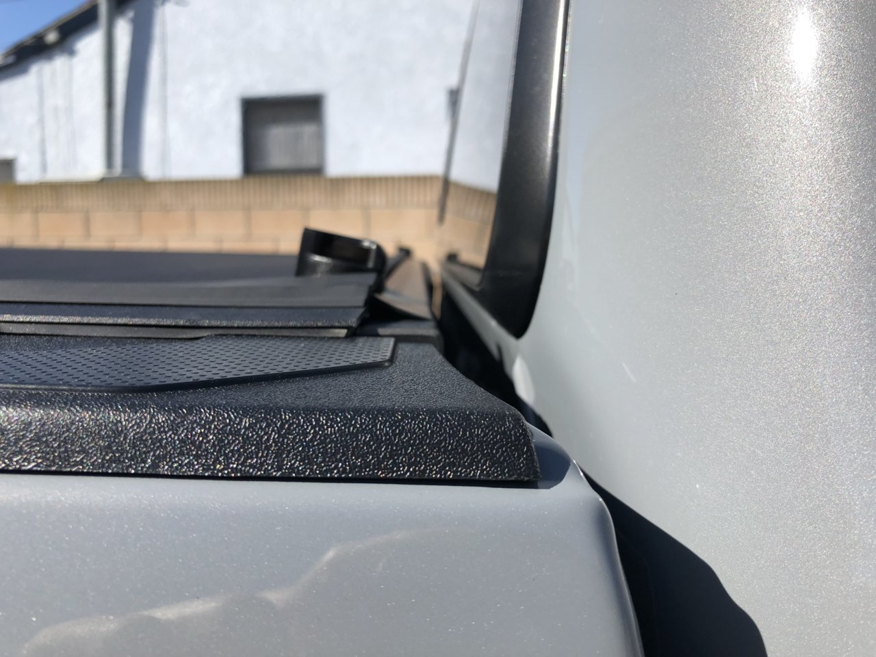

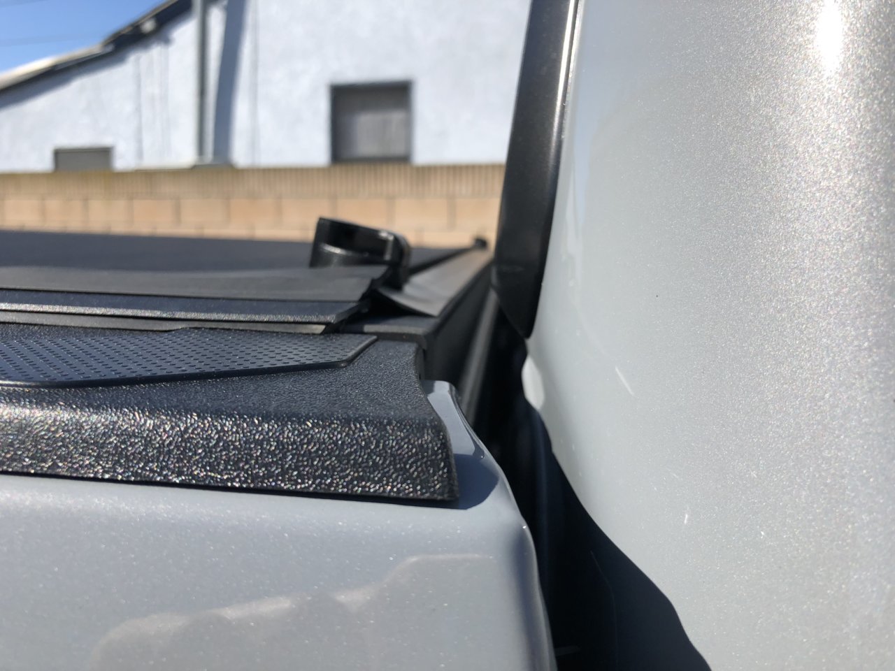

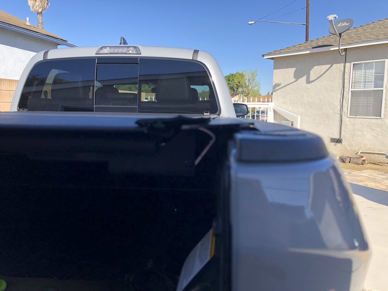

    I installed the X4 yesterday but had a couple of issues. Couldn’t get the strap bracket to tighten down to the rail. Also the rail kind of slopes in toward bed and there is a slight hump in the cover at the front of bed. Anyone else have these issues

    Got mine yesterday. Took my time installing it. Applied some black RTV in spots and glued a couple other spots. Not needed, but in my past experience with covers it’s a little added water security.
    As for the rails, yes they tilt in ever so slightly and it appears this is due to the swooping bedrail on our trucks. The cover’s rail has to be trimmed to avoid the inward motion of the bedrail.
    At the bulkhead, I decided not to install the weather strip as the rails are nearly level to the bulkhead. I seein your pics that you have the weather strip under the cover’s rail and that will certainly cause an upward kick.
    Overall I like the cover. We’ll have to wait to see about the water tightness but I’m not expecting it to be completely sealed.
