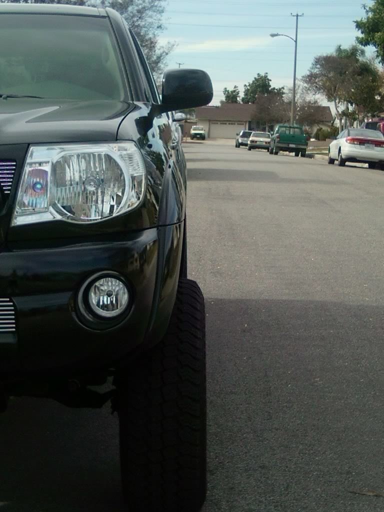

  13. Sep 8, 2010 at 11:19 AM
    #53
    hockeypoor
    hockeypoor Well-Known Member
    Apr 28, 2008
    #6250
    109
    Central Coast of California
    Speedway Blue All stock Prerunner
    Hey can you please post some pic's from the front! I have been thinking about the same thing. Spindles and spacers. I would like to see how far out the tires are. I am thinking Allpro fenders would look great.

  16. Sep 8, 2010 at 11:30 AM
    #56
    1BlkT
    1BlkT Mod'n on a Budget
    Oct 29, 2007
    #3283
    1,289
    Ty
    90603
    2006 Black Sport Double Cab
    Allied 4'' Spindles, Sway A Way 2.5 Coilovers, Donahoe Remote Reservoir Shocks w/ Deaver 11Pack Leafs, Goodyear Duratrac 285's, Pro Comp Series 8128, Recessed Grill w/Hella 500's behind, Tint, Black TRD Skid Plate, Debadged, Tailgate Hose Clamp, Weathertech Mats, Aero Turbine 2525XL Exhaust, Volant Intake, RETRO'D Headlights by Yosh2000
    Here's an older pic of mine before I changed rims and a few other things to help give you an idea on how much they stick out.
    Spindles with 285's and the rims were 4.5'' backspacing.
