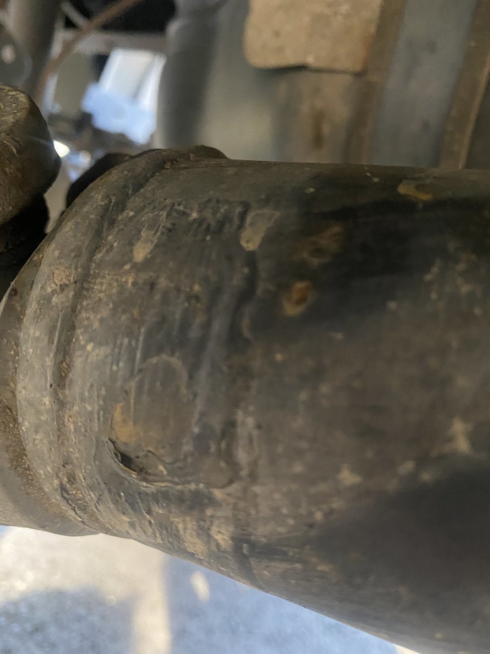

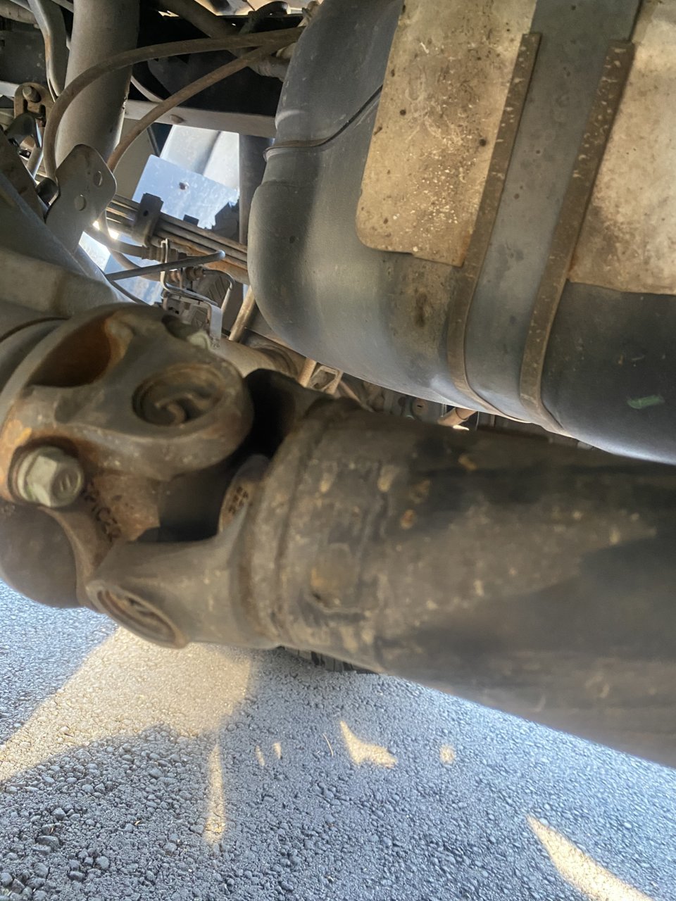

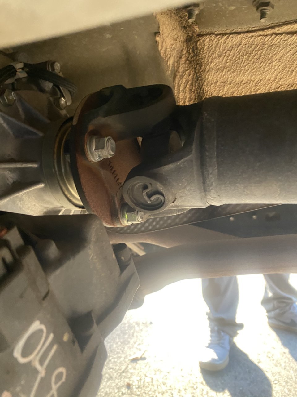

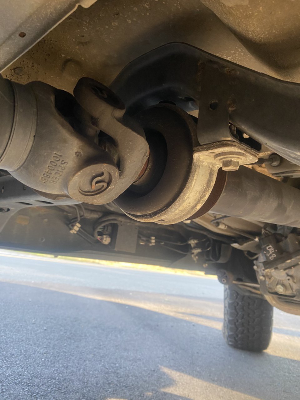

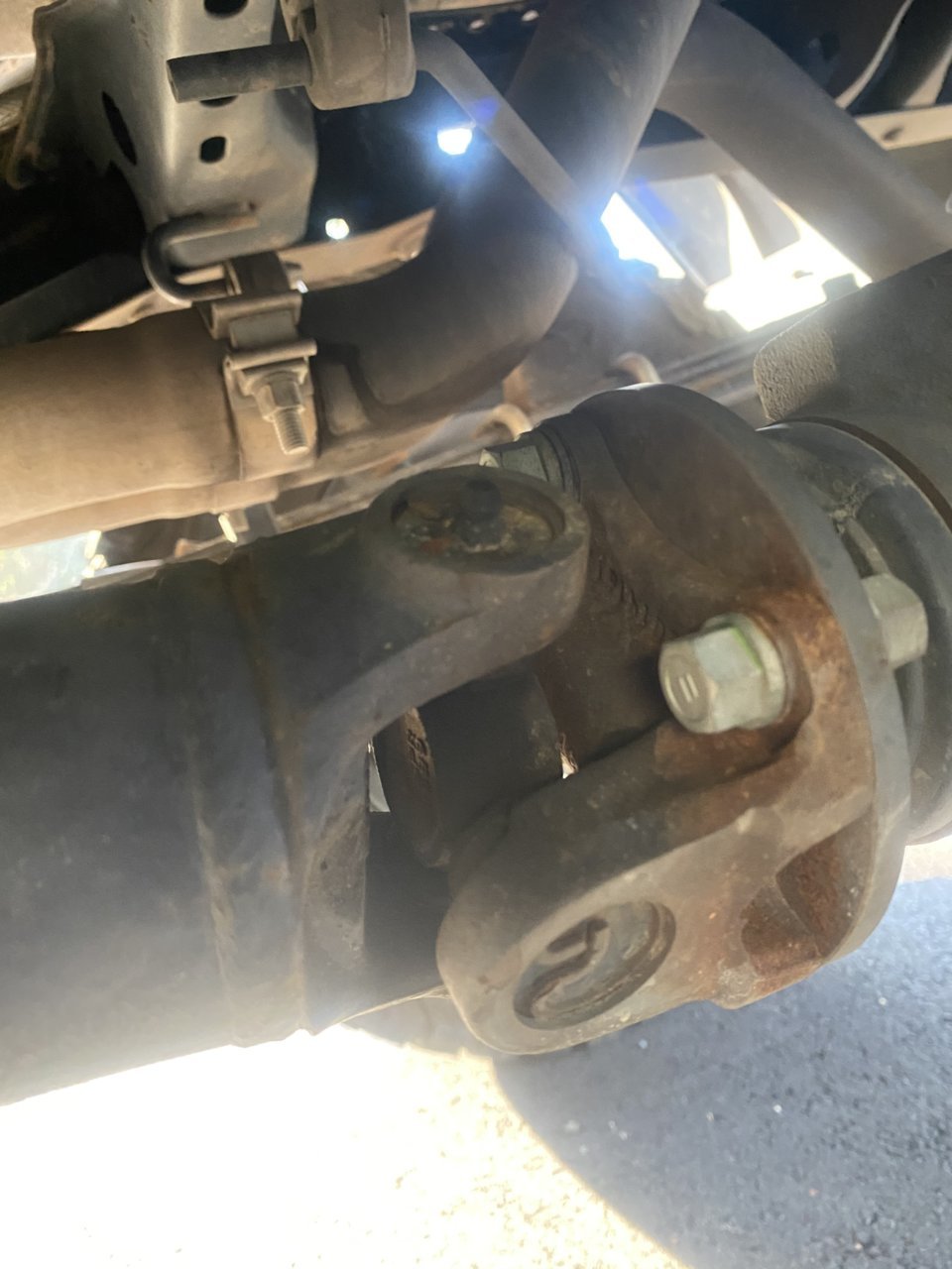

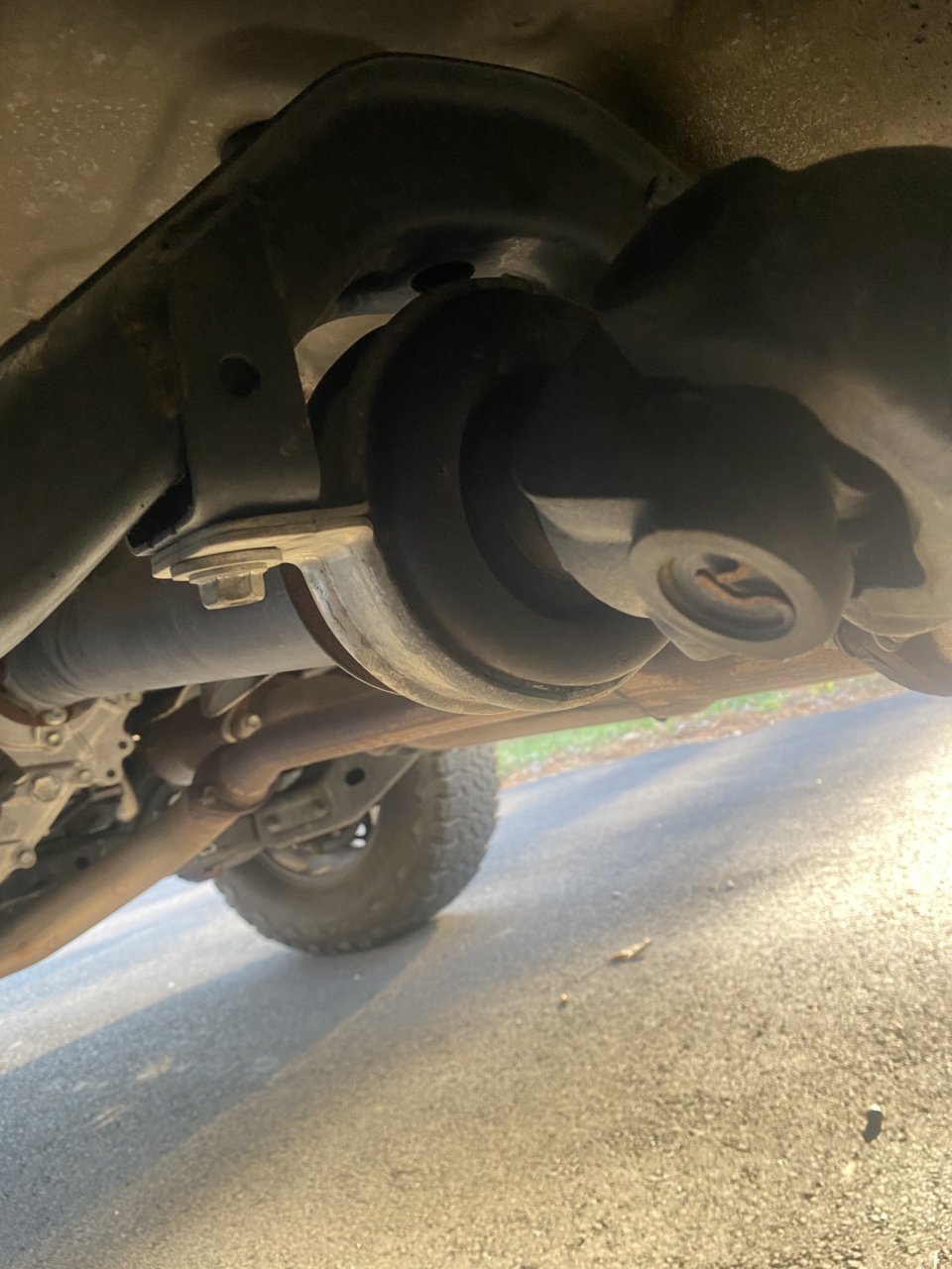

    Carrier Bearing Front to Rear POV
    Carrier Bearing Rear to Front POV
    Front Differential U-Joint
    Mid Driveshaft U-Joint
    Rear Differential U-Joint
    Suspect missing driveshaft balancing weight, located prior to the rear diff U-Joint
    Images taken 11/24/2020

    Does the upper shaft between the t-case and carrier bearing have a balance weight?

    For the OP, have you checked the torque on your U-joint bolts, not the U bolts to the leafs.
