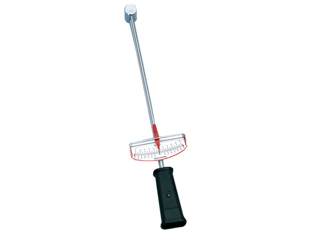

    Fox 2.0 Performance Series IFP 2" Coilover Front Shocks RoughCountry Rear 2" Leaf Spring Lifting Blocks 6 Gang Switch Panel Relay Control System for: - Hidden front bumper 30" LED bar - Direct replacement 24W LED pod fog lights - Hidden hood scoop 10" LED bar - Front grill amber and 6k led spotlights Airaid Poweraid Throttle Body Spacer Hella Sharptone Horn Kit MBRP Matte Black Catback Exhaust swap K&N Performance Air Intake System XD Recon 17X8.5 Satin Black BFGoodrich All-Terrain T/A KO2 Baja Champion LT285/70/R17 KSP 1.5" Aluminum Wheel Spacers Pedal Commander Throttle Controller OEM Adjustable Roof Bars OEM Extended Cab Foot Rails RGB LED Long Bed Lighting Kit Black Out Sequential LED Headlight & Taillight Swap Xentec HID Xenon 6k Headlight Kit Tailgate Sequential LED Signal Bar
    I have not, I definitely need to get a more accurate torque wrench. I just have one of these rinky-dink wrenches: upload_2020-11-25_8-9-20.png
  6. Nov 25, 2020 at 5:11 AM
    #26
    GusmanJE
    GusmanJE [OP] Active Member
    Feb 8, 2020
    #318612
    41
    Virginia
    2016 Quicksand Tacoma TRD Sport
    I could just find some at an auto parts shop or local hardware store, correct?
