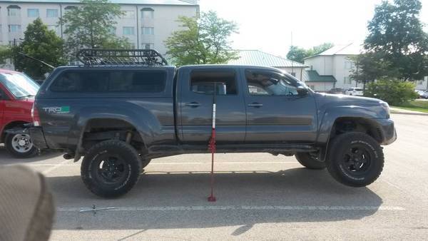

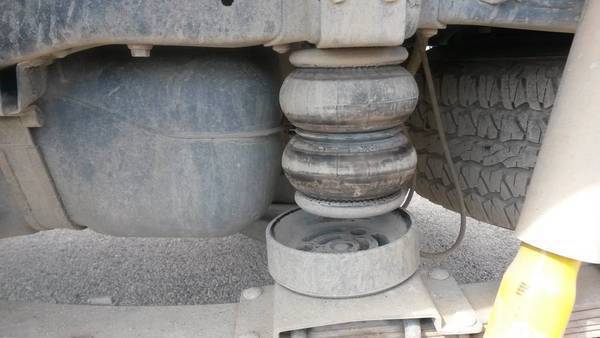

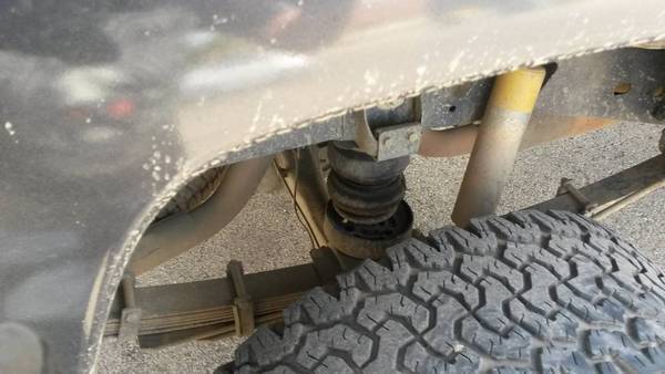

    Yes I do go offroading and have fun with road imperfections. Here are a couple of pics when I rotated my tires.

    did you notice having to change the air pressure (for normal driving) when you put the cradles on? it looks like they compress the bags about an inch more than stock at rest.

    The cradles don't "compress" the bags, but they are about an inch deep so if you look from the side the bag will look shorter than it does when bolted to the stock flat plate....one of those "optical illusion" type things.

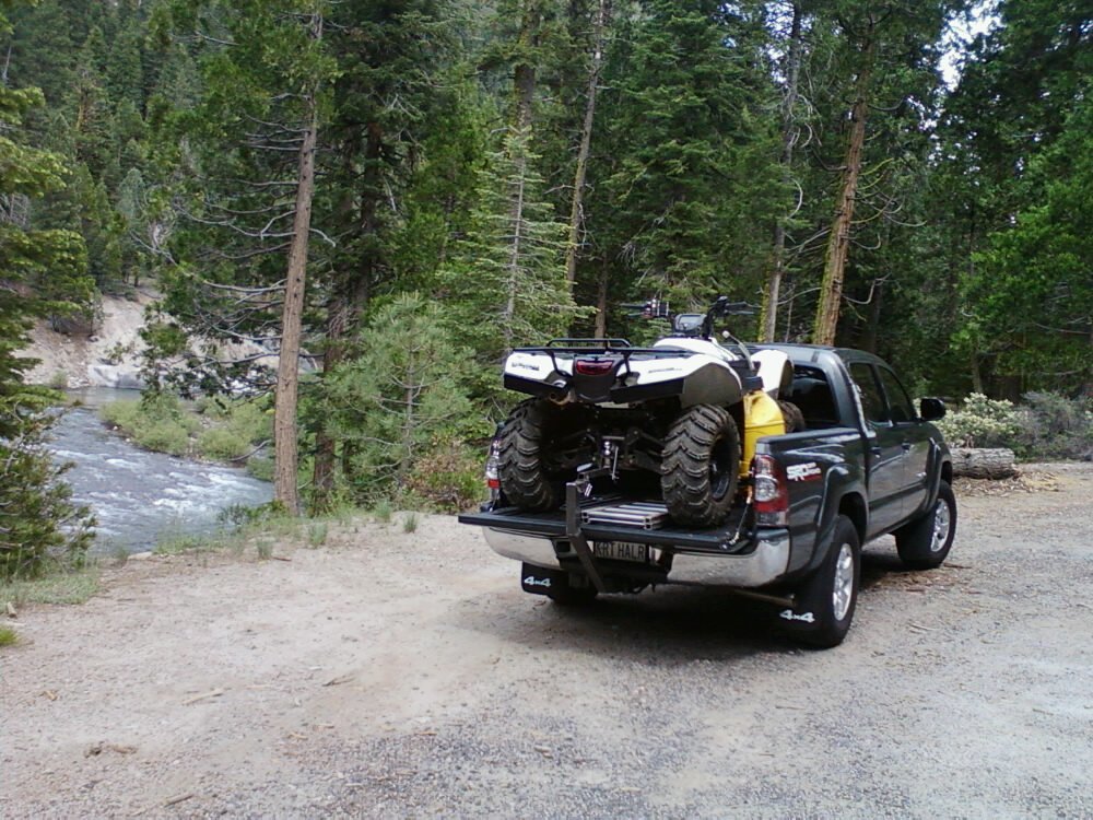

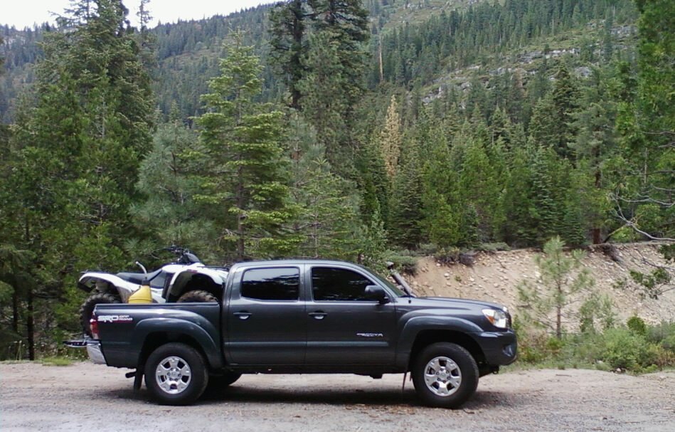

    All season mats, 2nd filter delete, DT header, Jardine cat-back, URD shifter, Bilstein 5100's all around at .85 front with Eibachs + .25 passenger/.5 drivers spacers and 1.5 AAL, 0w20 synthetic, Scanguage II, extra D rings, OEM backup camera+Mirror, bed mat, Extang Solid Fold, Popnlock 5300, Pro Comp 7089's 4.5bs 285/70/17 Revo 2s, De-badged
    Here's my almost 900lb bike. Outlander max. I'm in the same boat as you. Gonna buy some soon
