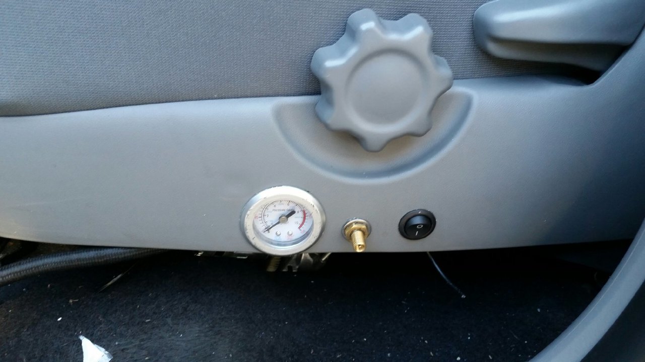

    this is actually just mocked for now, what i did: T split from 2 air bags, one line going to front, inside cab. Line is then split into 2 using another T split. one line goes to airpump, another goes to side fo seat for deflation.
    this guage and switch was a cheap airpump i broke down adn mounted in side of seat. Switch turns on pump, ads air, valve deflates. gauge tells pressure in bags. cheap!

    Yeah except with a t in the line, you're losing the ability to level side to side or reduce sway when hauling. Since you're allowing the air to transfer between bags.
    I guess it's fine depending on your use but generally it isn't a good idea if you're hauling a lot of weight in the bed.

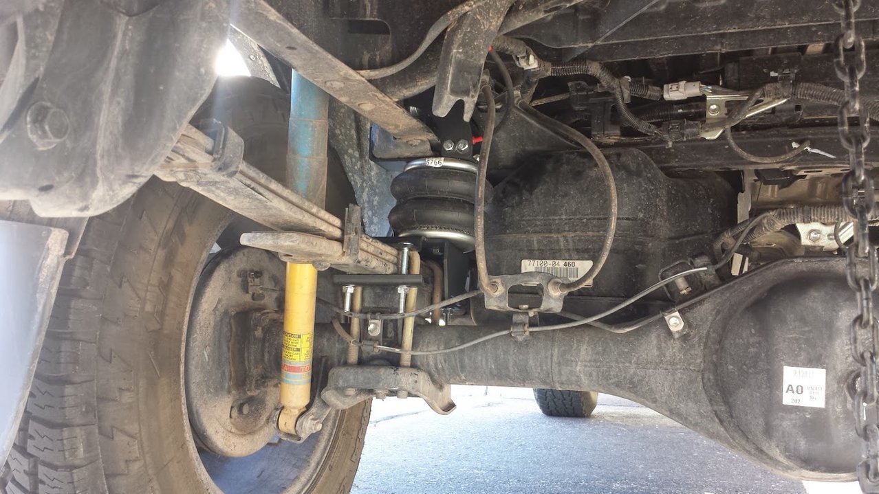

    I just installed my airbags last night on my 2013 DC Prerunner.
    I bought it from the dealer with a slight lift already installed.
    Looks to be about a 1.5" block under the rear springs providing the rear lift.
    You can see how the leg on the bottom plate for the airbag does not rest on the axle.
    I plan on engineering something up to bridge the gap.
    Do you guys think it's a big deal?
    Does the support on your bottom plate actually touch the axle on your installations?

    Yes, you want that bracket to be supported by the axle housing.
    You want to yank that block out and install an add-a-leaf (AAL), or pull the blocks and leafs and get a new leaf pack.
    Blocks do add height, but they break leafs and bend u-bolts.
    The air-bag bracket will bend under load and more than likely snap the (edit:u-bolts) carriage bolts holding the bracket on.

    I've looked a the other installation pics and while the "leg" of the bottom bracket is closer to the axle it still is not in contact.
    I think I'll be Okay but i'll modify my bracket legs just to be safe.
