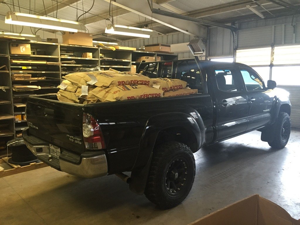

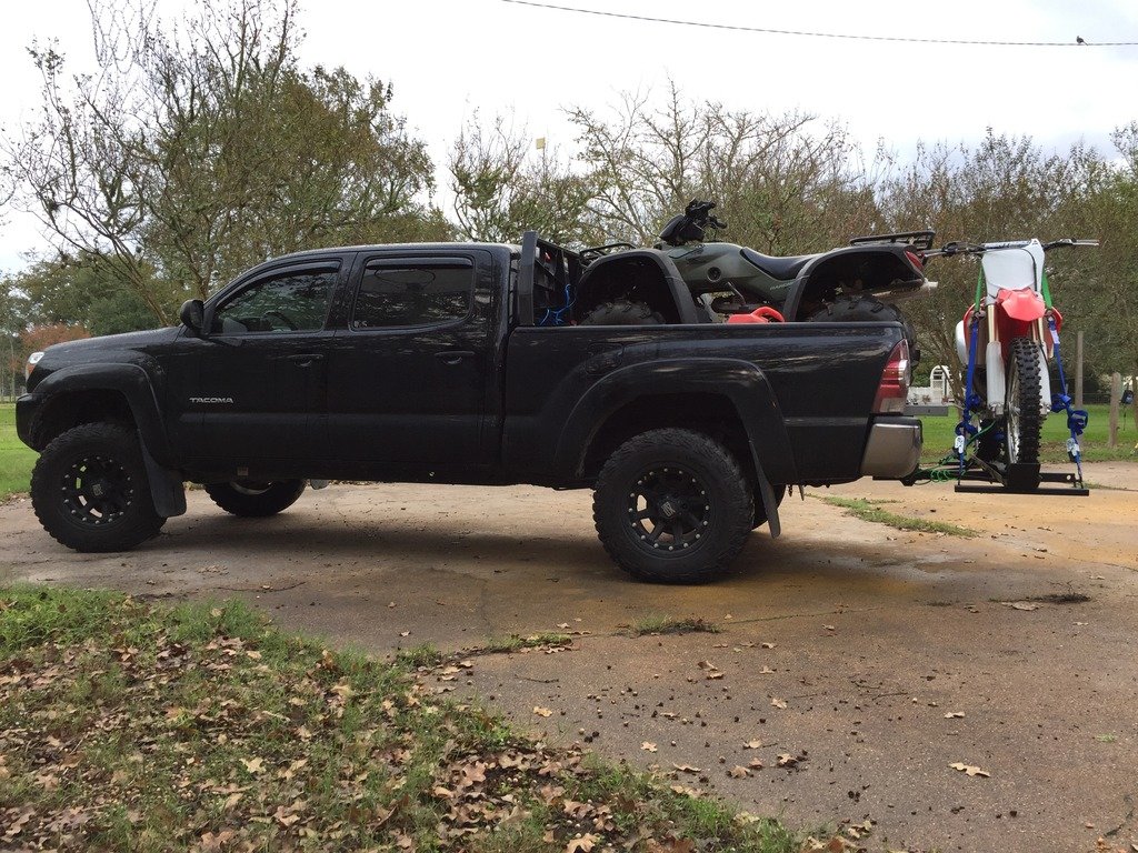

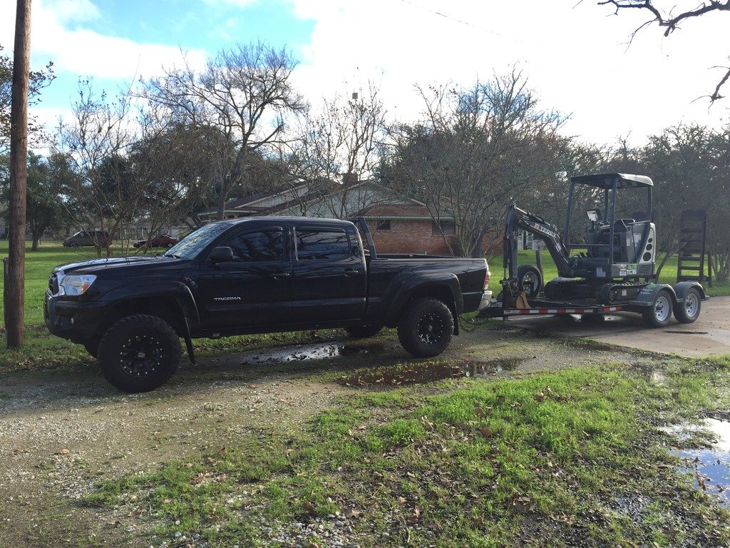

    I love my Firestone Ride Rite air bags. Before installing them my truck sagged in the rear empty and it would hit the bumpstops with even the lightest of loads (300lbs of bagged mulch!) in the bed, so bad that I was ready to trade it off for a 1/2 ton. Night and day difference after installing the air bags!
    Heres my Tacoma hauling my Honda Rancher 350 4x4 and Honda CRF450R on a 8hr round trip (40psi in bags):
    Here's my Tacoma hauling 1,200lbs of cattle feed parked inside while I waited out a rain shower (75psi in bags):
    Heres a shot yesterday hauling a rental mini-excavator from Home Depot (40psi in bags):

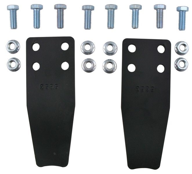

    On the advice of other wiser TACO owners - I went looking for, and found these parts.............
    They are Firestone parts that were made extend the vertical leg on Tundra and F150's - to use on the Tacoma you have to locate and drill the four holes into that vertical leg. And do a bit of measuring and cutting. They are P/N F2506 and are just a bit spendy for a couple of pieces of 4 inch wide flat bar. I have also been told that the holes are pretty loose on the provided screws - which I wouldn't like (myself).
