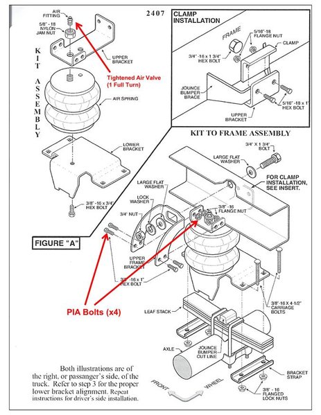

    I assumed it was the air valve on top of the air bags. When I was originally installing the bags, I remember I left quite a bit of thread on the valve (i.e. not tightened down all the way). So I got under the truck and tightened it down (1 additional full turn) and pumped it up to 50 psi and checked for leaks with soap water. Couldn't see any air bubbles, so I assume this fixed the slow leak.
    Checked pressure today and it seems to be holding! :)
    Will just have to check pressure periodically and make sure it stays relatively the same.

    Awesome man! I hope this post helps you out!
    Be sure to come back and post about your instal etc.
    Also, here's a heads-up: 1) READ and UNDERSTAND the instructions, 2) make sure you have ALL the tools needed before you start (I learned this the hard way lol), 3) take your time, and 4) measure twice and cut once (i.e. the air hoses)!
