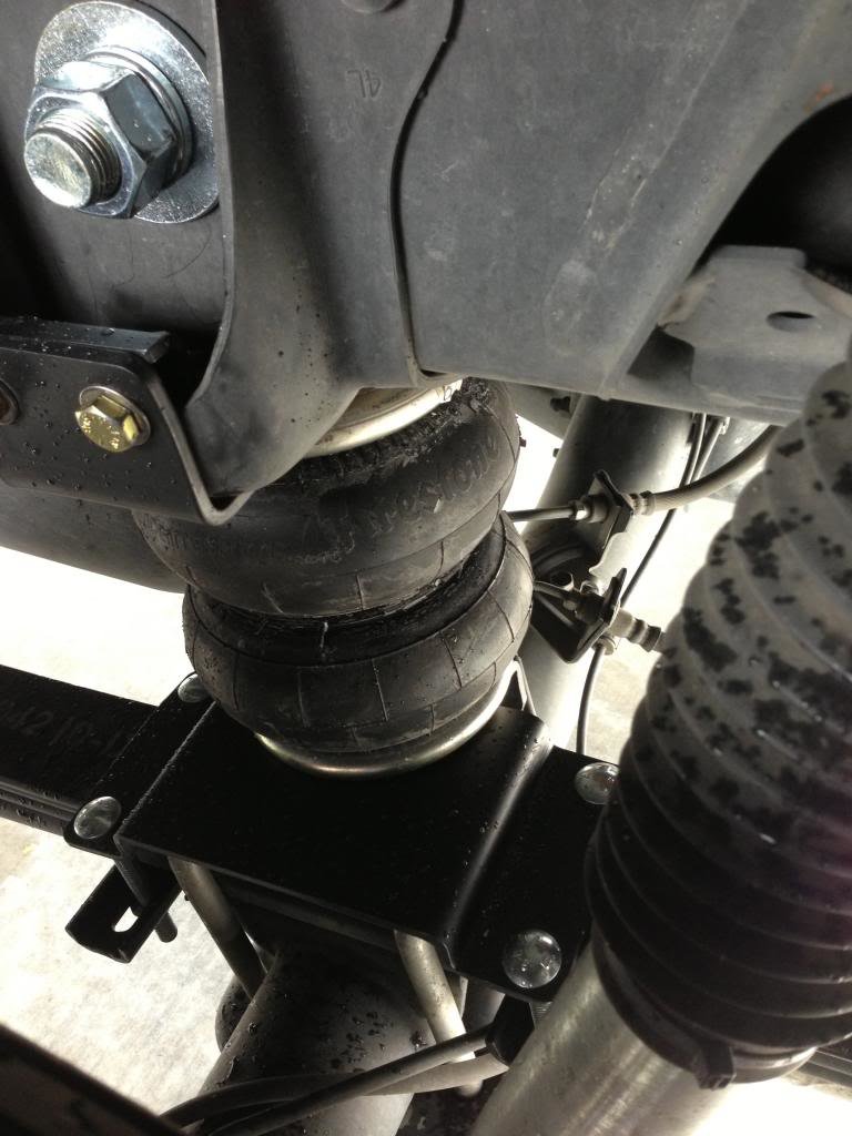

    Some pics from this weekend: 2 Yamaha Blasters (800lbs) and 6x10 utility trailer (1200lbs).
    Ride rite's did their job!
    Inflated each side to about 25psi; completely eliminated rear sagging! :)

    INSTALLED !!!!!!

    No Leaks ! Sorry But didnt take a pic before the install
    Going to load up my Trailer tonight, I'll take a pic of how it looks !
