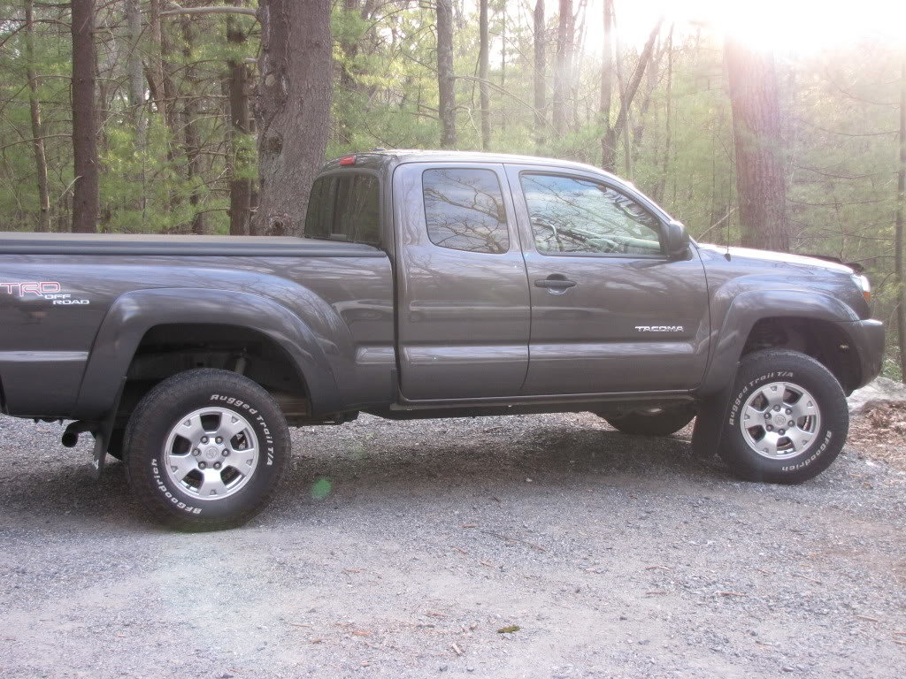

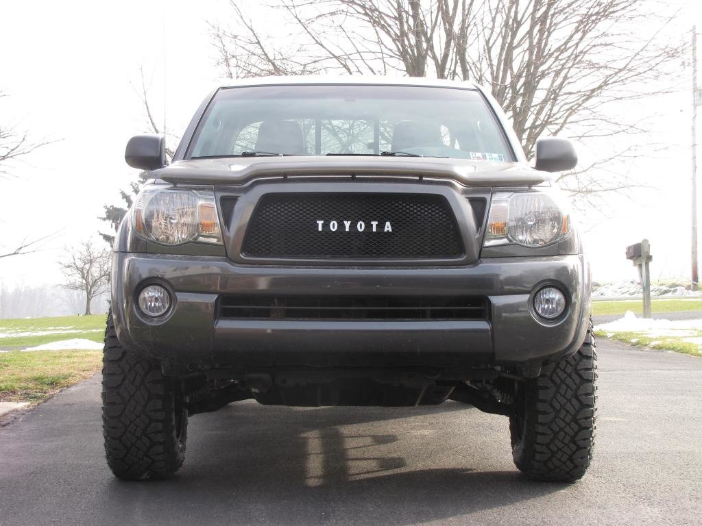

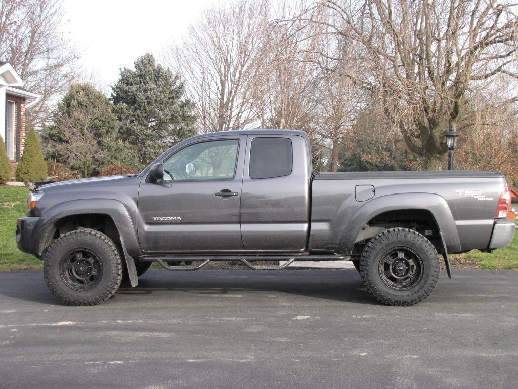

    I finally put my front 5100s on about 2 weeks ago. I set them at 2.5" with rear Toytec 1.5" AAL in the rear with no TSB. My truck only has 25k miles so there isn't any suspension sag. With this setup I still have a slight rake. About a 1" difference.
    When swapping the front struts I used the method of leaving the bottom of the strut bolted while using the a jack to lower the LCA to decompress the spring. Someone on here was talking about it so I figured I would try it. I must say it was the easiest and safest way I have ever swapped a spring.

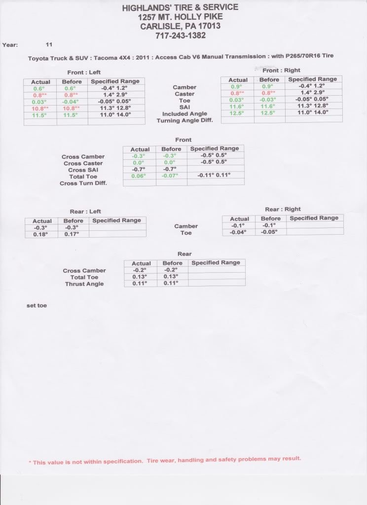

    After everything was said and done I had it aligned and I have the common issue of my caster not being within spec. I can feel it on the road when hitting bumps. Not too big of an issue for me, I might get new UCA's at some point.
    As for vibrations or anything of that nature I lucked out. No vibrations or anything at any point or any speed.
    Before
    After

    Here is the numbers from the alignment.

    Thanks. Looks similar to mine though camber is .7 on mine.
