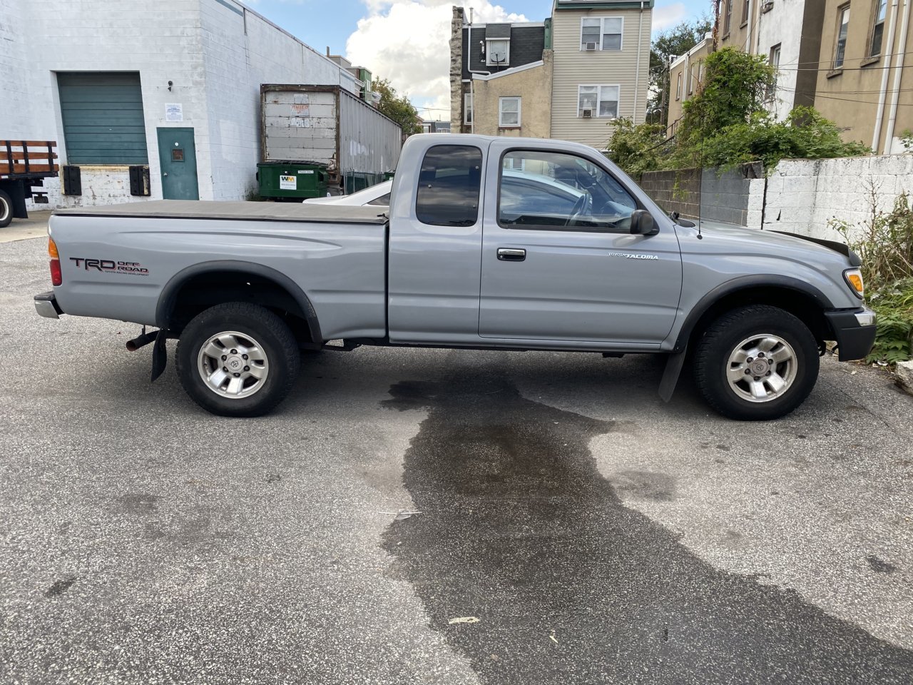

Installed front shocks now my truck 2 inches lower in the front

    I knew I wasn’t the only one and people was telling that’s y I get for buying cheap shocks there a total different in weight from a 2wd 4cly then a v6 4wd

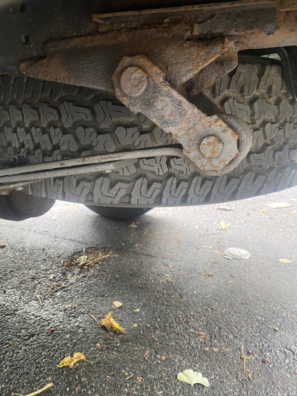

    Front looks stockish - maybe not exactly but imo. Pic of the where the leaf springs connect to the rear axle will help conclude if it was lifted before.

    Oh shit...pic of leaf spring where it attaches to the axle (u bolts), and pic of front hanger?
    That's a lot of rust.

    The axle is what the wheels are bolted to. :gossip: :( My truck never had stock shackles when I bought it so maybe someone with stock ones can explain if those are stock.

    there is no block between the axel and leaf springs just leaf spring the axel and u bolts

    How many leafs?
  9. Sep 26, 2020 at 2:24 PM
    #49
    waseemri
    waseemri [OP] Active Member
    Sep 26, 2020
    #341966
    25
    Waseem
    1999 Toyota Tacoma sr5 v6 4wd xtra cab
    4

    Yeah looks bad for you

    is lifted?

    Not likely

    I have resolved the issue I was correct the whole time there is a different spring rate for the 2wd 4cly and 4wd v6 but if you go anywhere they only have 1 part # 171352L for it so I seen on a thread about the part # 171351L but when you go look it says doesn’t fit Tacoma so I searched the part number and it came back as for 3rd gen 4Runner so I just ran to the autozone and got a 1999 4Runner v6 4wd shock and I installed them and I’m happy to say I’m back to the original height @koditten
