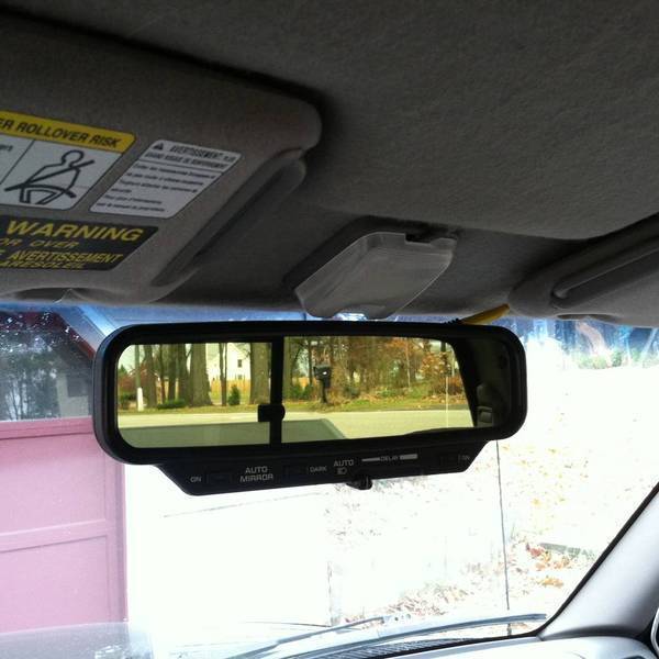

    Finally got sick of the manual mirror that I had to adjust each and every time that I flipped from day to night mode. Removed it from the lamp base and glued a GM standard rearview button to the glass. Popped on my Gentex #104 auto dimming mirror with automatic headlight control. I've got the wiring temporarily run to the 12v aux for now until I get the time to run the wiring properly down the A-pillar.
