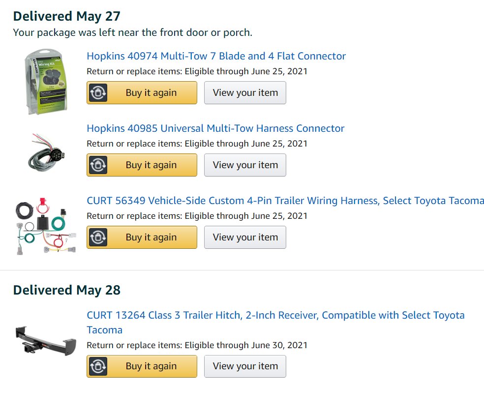

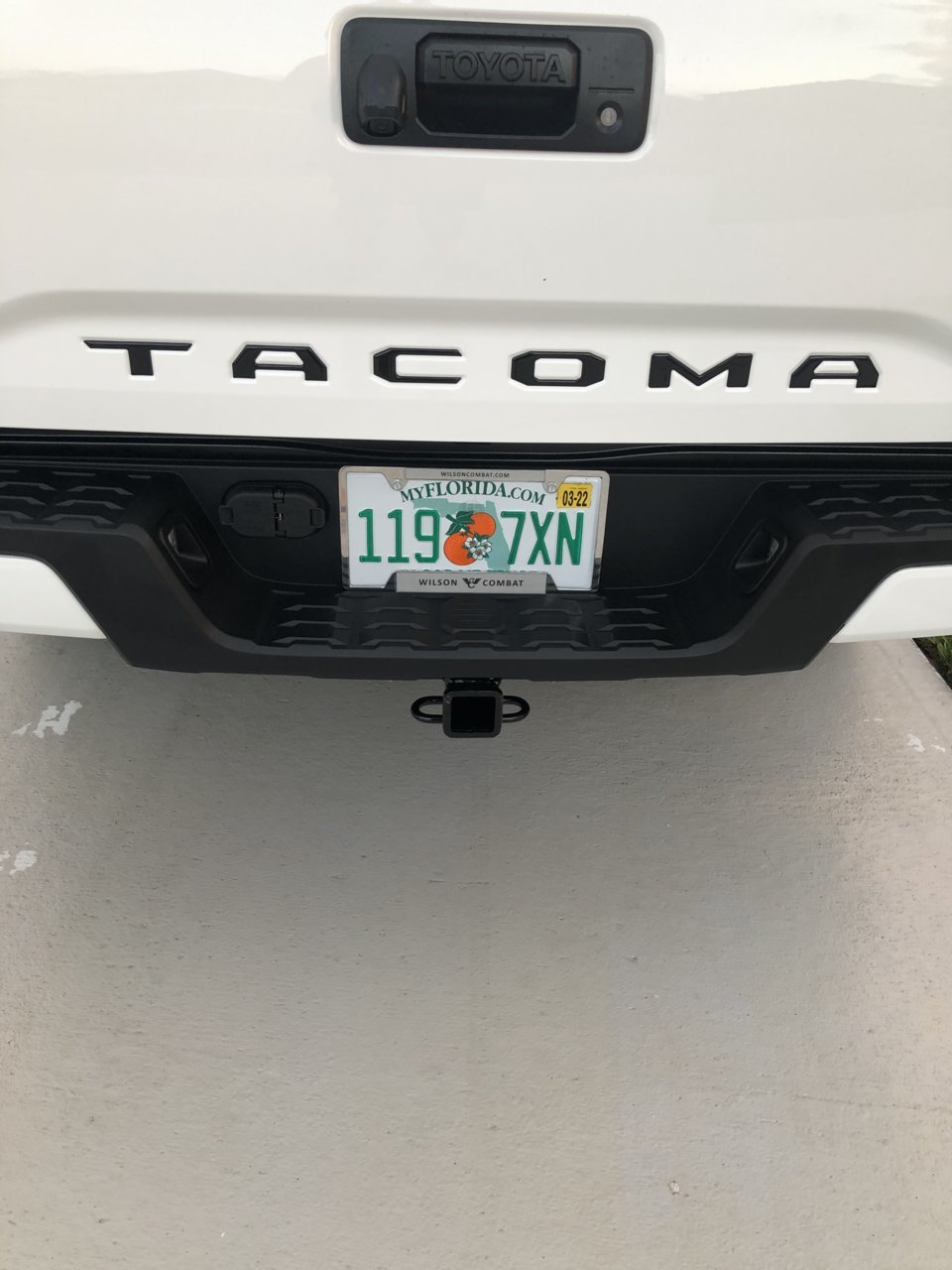

    I installed at the direction of the youtube video I cant find now.
    Everything worked good and its perfect.
    I ordered all the parts from Amazon below.
    They lie about delivery times so be aware.
    I did it all for about $235.00.

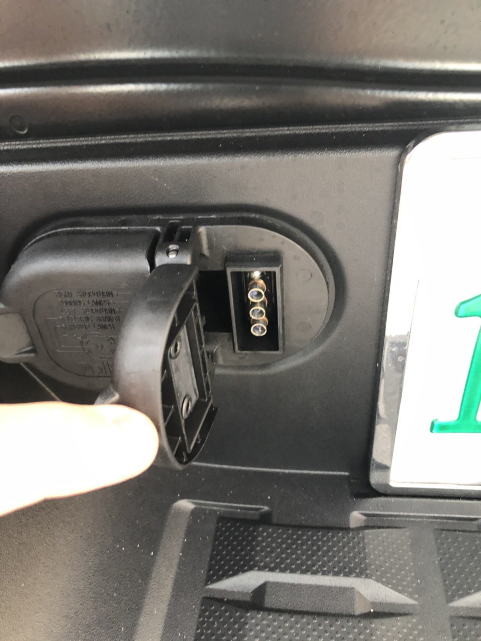

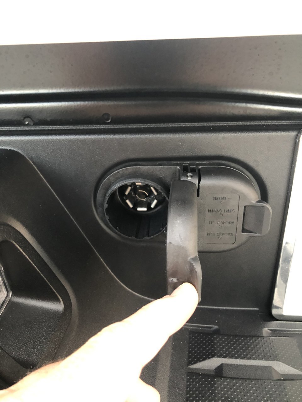

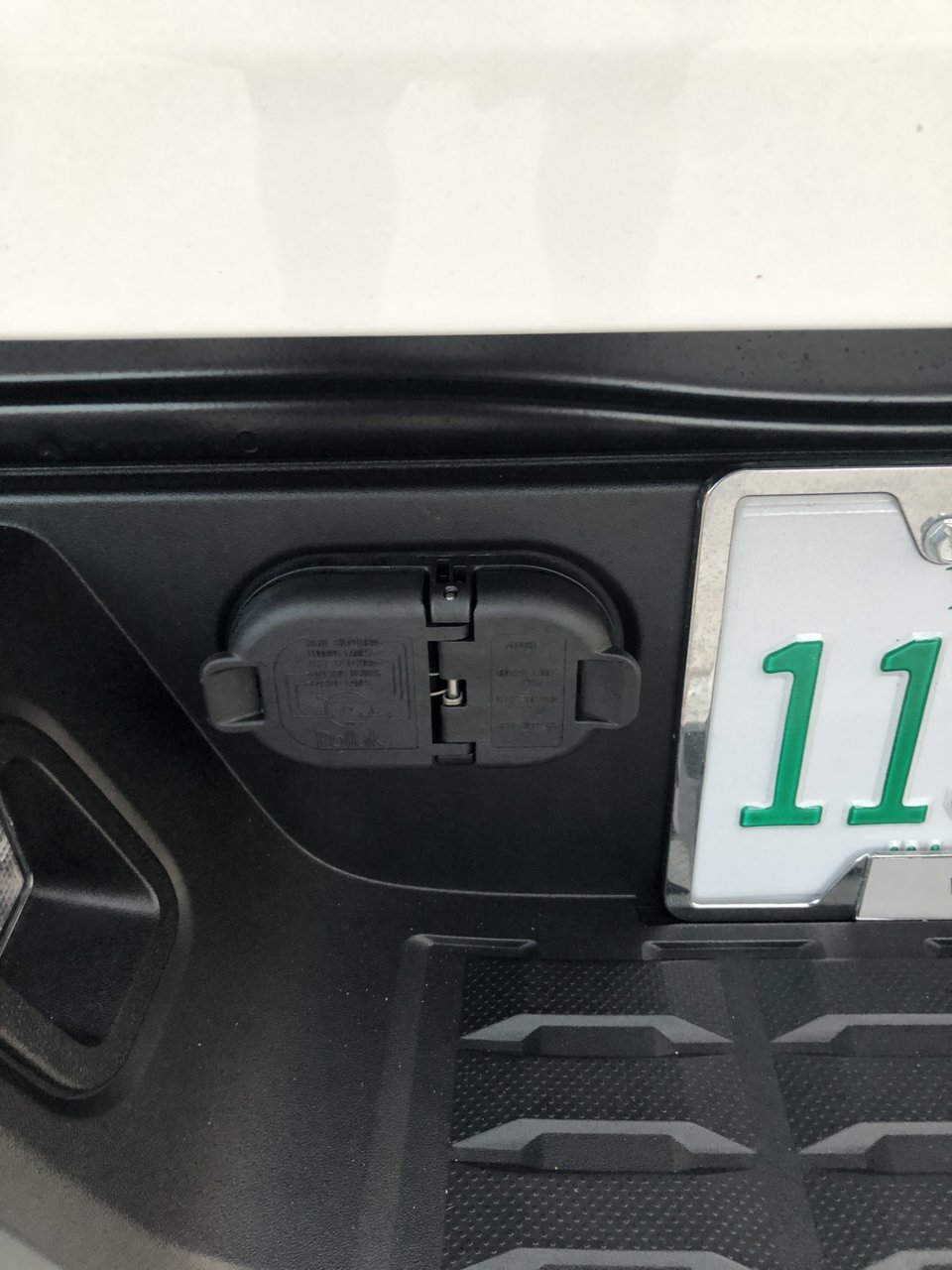

    A few points.
    1. Remove the spare.
    2. Remove both tailights.
    3. Read the directions on fishing the bolts not that bad really.
    4. You need a torque wrench.
    5. 4 Pin wiring with no brakes leaves 3 wires that are connected so tape them up.
    6. Take your time and watch a video on removing the tailights and removing spare.
    7. I can help if you need it.
