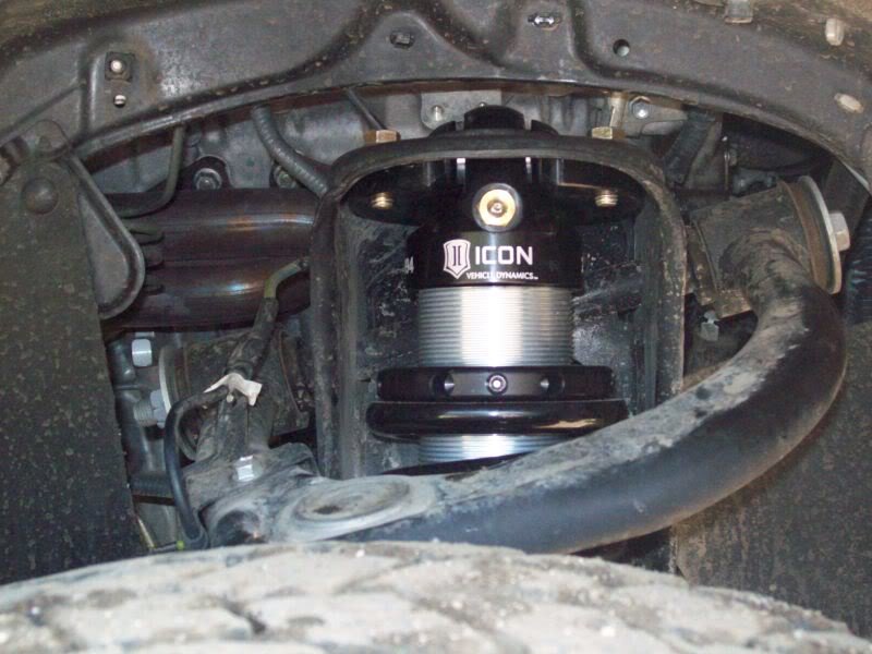

    Reviving...
    Hi Tacoskim,
    How much lift did you get with this setting? How many inches of thread showing?

    sup dtacoms. i didnt adjust them at all, i only cranked the driver side 2 revolutions to compensate for the "taco lean" which lifted it up 1/4 of an inch... the CO's probably gave me bout 2 inch of lift over stock

    Thanks Tacoskim. ICON said that they set them at 2.5" before shipping. I guess, yours was an exception then.

    any alignment issues at that setting?

    no alignment issues. icon pre set them at the right height where aftermarket UCAs aren't a "must". if you crank them any higher then youll have some issues unless you get UCAs
