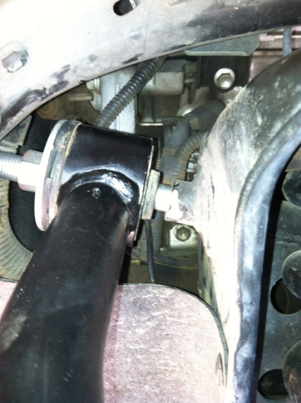

    so today me and my pops installed LR UCA's and we got a tiny prob.. we got a gap where the bolt is showing here in these pictures

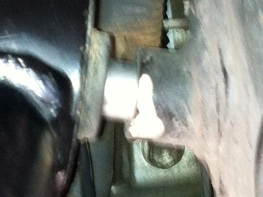

    and heres a close up of the gap

    so basically when i stop the UCAs slide forward and when i accelerate they shift back and forth etc. im not driving it at the moment. anyone tell me how to fix this please!! :confused: do i need a rubber washer in the middle or what is the prob?

    Did it come with 8 thick washers? They go on either side of each bushing.

    It looks like your control arms have LR's previous bushings installed (there's an updated poly bushing that's out now). With your type of bushings your kit should have come with 8 large washers that go on each side of the bushing housings. Call LR if you're missing those washers.

    nah i didnt get those. where can i get em?

    Get a hold of Specialty products. They have great customer service. Did you buy your UCA's new?

    no i bought em off a member here with 4k. ill contact SPC thanks!

    does anyone know which washers i need for my LR UCA's? its the weekend and well i wanna order them already.

    Call SPC in the morning dude.
