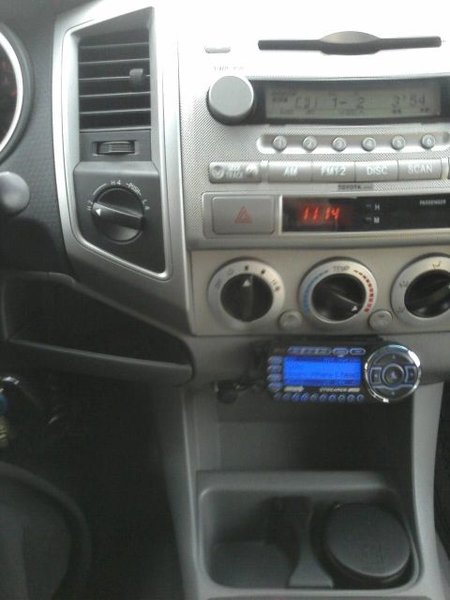

    I installed the TY02 adapter this morning and love it! The Sirius sounds MUCH better than via FM modulation - and having the ability to use my iPod in the truck now is sweet!
    The install took me 30 minutes. Most of the time was spent feeding the cables to where I needed them. Wish I had smaller hands!
    One complaint though... when running it from CD1 (the adapter), the audio is definitely quieter than normal. No big deal... just turn it up. But if you switch back to FM radio or a CD, then it's significantly louder. You definitely have to remember to turn the audio down before switching to something other than the adapter - otherwise you'll get a loud blast of volume!
    Just a note... one thing I found to help boost the volume from my Sirius (running through the AUX on the adapter) was to turn off the FM Modulation on the Sirius itself. As soon as you turn the FM modulation off, it gets quite a bit louder.
    Another note, it is possible to use both the iPod and the AUX at the same time (why you'd want to is beyond me though...).
    I've attached a pic (sorry for the quality... it's from my shoe phone). The iPod cable is in the tray to the right of the steering wheel (to the left of the Sirius).
