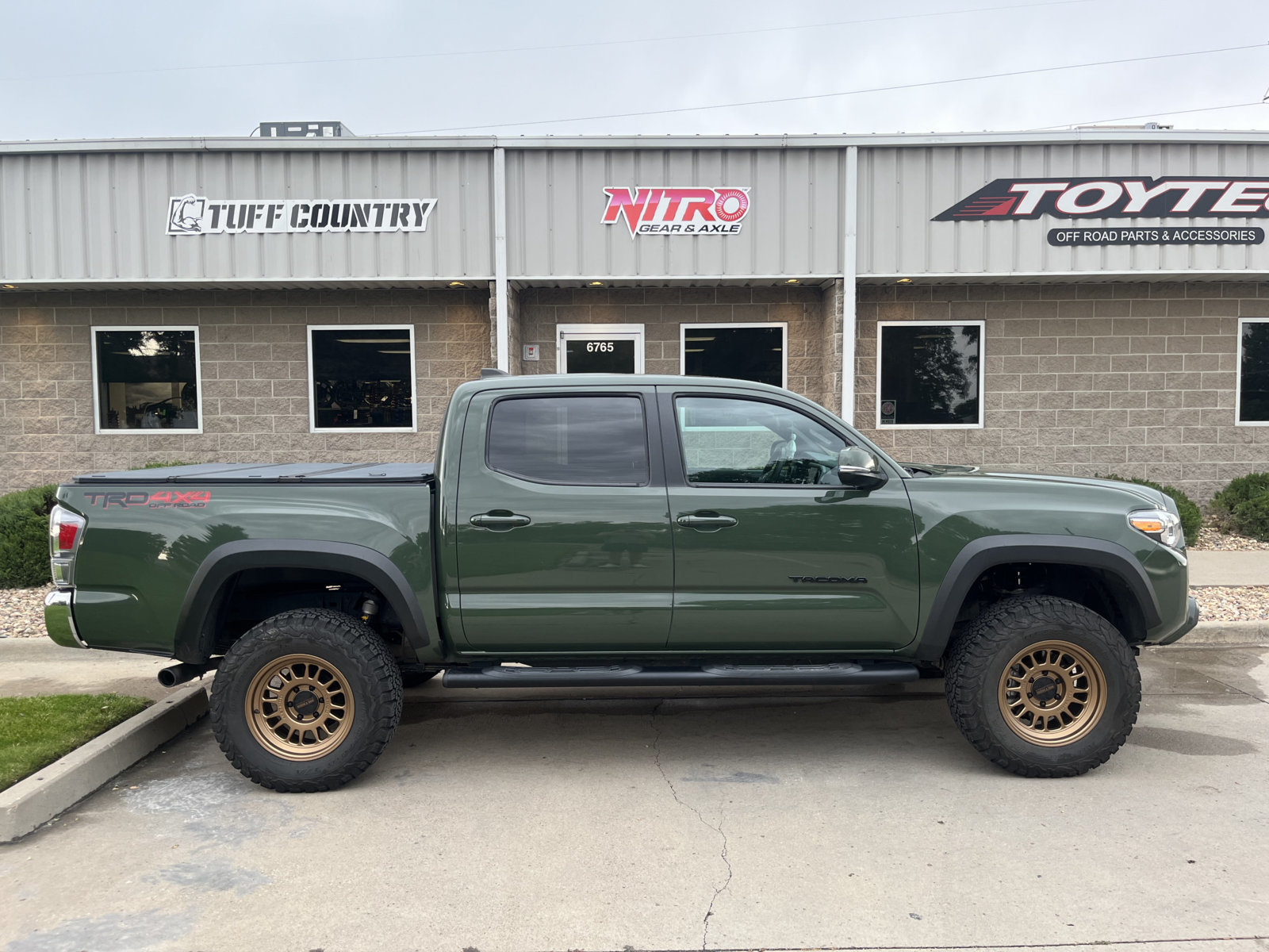

    Mr. Pickles
    2019 Tacoma TRD Off-Road
    2019 DCLB OR. So I installed the MT64 front coilovers with 4007 springs, and MT64 rear struts with an icon RXT leaf pack. I gained almost 3” of lift in the rear and pretty much no lift up front. Measuring bottom of rim to fender. Rear went from 30” to 33” no lean. And front driver side went from 29” to 29” and front passenger is about 29-3/4”. I’m in the standard collar setting on the coilovers but was wondering is it better to preload for that 2” or go to a stiffer spring? Do I need the 4004 spring that is 15.6” free height vs my 4007 that is 15.0” free height? Or do I need a heavier spring? Not sure what to do since right now my ride quality is awesome and I don’t wanna lose too much of that. I like rake but not 3” of it. I just need the 2” up front as I had expected.

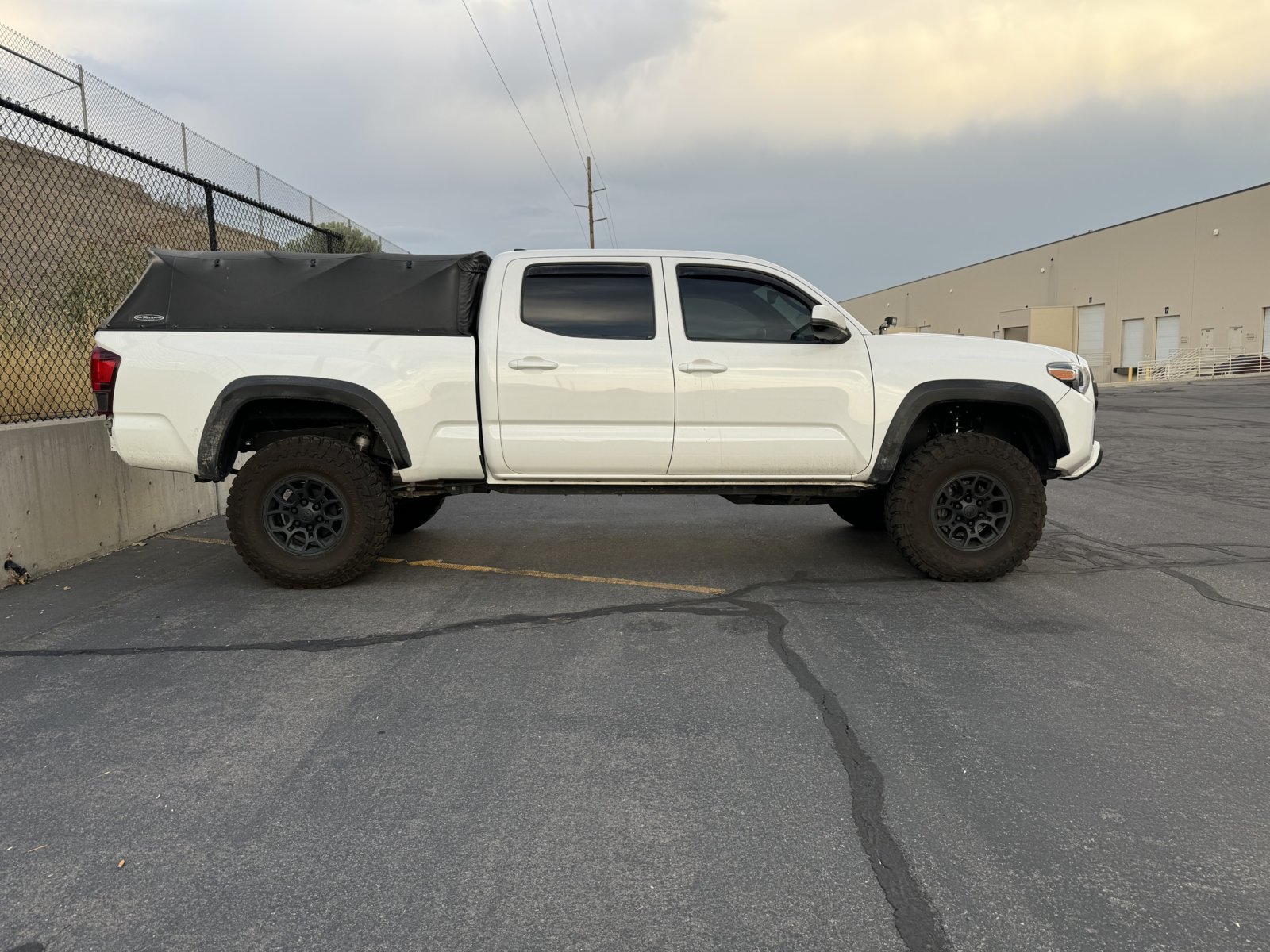

    Looks lifted in the front to me. Stock is 21" front and 22" rear. Center of hub on the wheel to fender.
    Those leaf packs will take some time to settle, and the new front coils as well.
    Icon RXT - Level 3 for people that have weight in the back and plans for weight, and level 2 if you are stock.

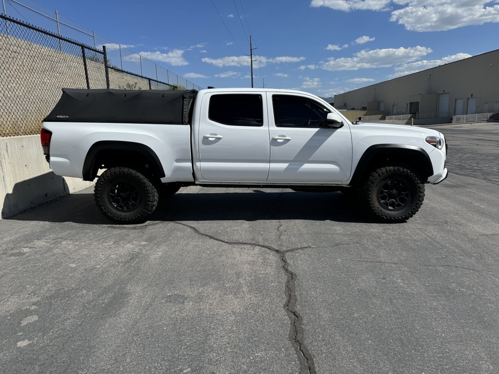

    So this is with a 4002 coil instead of 4007 at the top setting and that landed me at 2.5” lift. Now I’ll drop it two collars and call it good. Needs and alignment also so we’ll see how that does for height also.
