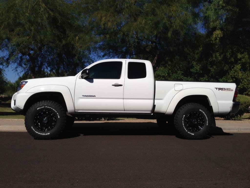

    Finally got a chance to install my 3in OME lift today! It turned out great and I cant wait to see how it does out on the trails! Here's everything I installed:
    - 885 coils with OME nitrocharger
    - LR UCA's
    - 3 leaf progressive add a leaf
    - Bilstein 5100's in the rear
    - XD Hoss 16x8 rims w/ 4.5in backspace
    - BFG KM2's 255/85/16

    Looks nice! Is it me, or perhaps the camera angle, or does it have a little bit of the "bro" lean?

    It does have a little bit of the "bro" lean right now, i'm hoping the front end will settle a little bit once i get a few miles on it. Can anyone speak to if their front end settled after a while?

    Looks great! The front should settle a bit. No top plate spacers right?

    I did put the top plate in but i might ultimately take it out if it doesn't settle in the way i'd like in the next month or so. Have people had bad experiences with the top plate?
