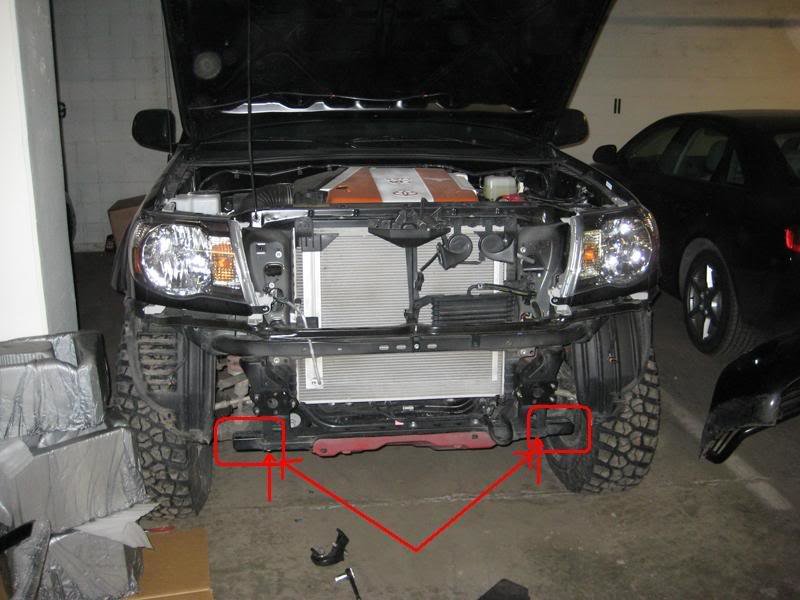

    There are two "extension" blocks to extend from the left and rightsides of the front piece of the frame. They are held in by a bolt on the bottom. Remove this bolt and those extension pieces. However, the piece that you remove is threaded and it's what the bolt screws into. Those plates provide that threading...
    This probably doesn't make sense, but it should once you go to put it on...

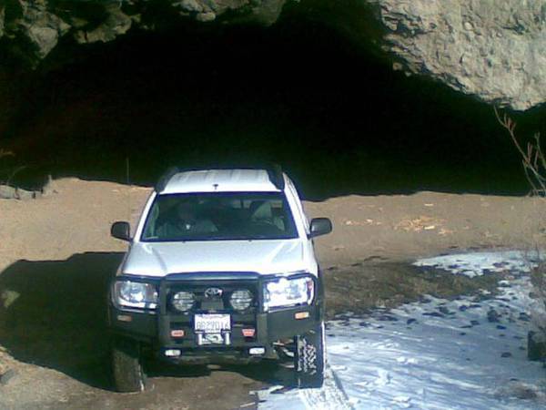

    Nice lookin bumper and truck. :DThe IPF lights are nice but since I installed my HID lights I dont notice the light from the IPF. They are the driving light and NOT the Spot light though. I might be gettin ride of them and goin with the IPF HID.
    It looks as though you are running stock rims and what size of tire are you running? Also are you using spacers or not to keep from rubbing your tire?
    Here is a Pic of my setup

    NorCal
    The IPF lights are the 900 XDS and they are 65 watts. And they are the Water proof ones that can be submerged under 12 in of water like 15 minutes. They are the heavy duty ones. I paid $189 for them through 4x4groupbuy.com the ones that I got the ARB group buy thru.
    Sorry to derail the thread of showing my truck in there after I had already posted I thought that wasnt to nice. Not that I was trying to steal your thunder but just wanted to show you the light setup and that was the only pic I had up close.

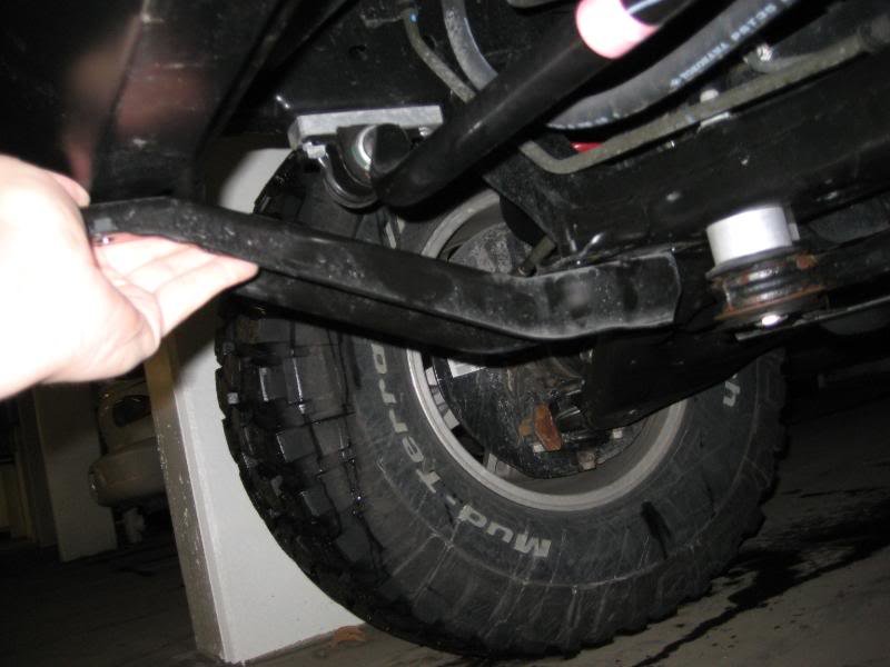

    Ok, try this... The rectangles indicate the "extensions" that are to be removed. The vertical arrows indicate where the bolts are that are to be removed. The plates that came with the bumper are threaded for these bolts, so they will go inside this horizontal frame piece. Don't worry, it will make sense when you have everything apart. But, the bolts will go through the bumper into this plate, so the steps are
    1) remove bolt
    2) remove extension
    3) put plate in hole
    4) place bumper on truck
    5) put bolt back through the hole in the bottom of the bumper
    Also, the skid plate and the arms indicated below will need to be removed:
    Based on what Silverback said, you can notch these arms so that they fit with the bumper, but the bumper won't fit properly without the arms being modded.
    Does this help??
  18. Jan 29, 2009 at 10:47 PM
    #78
    RelentlessFab
    RelentlessFab Eric @Relentless Fab Vendor
    Feb 17, 2008
    #4772
    15,806
    Eric
    Sparks, NV
    07 AC 6mt>03 SR5 >08 Sport and 17 6MT TRD OR
    Relentless Armored! Too many others to list.
    That's the same mounting points I used for my bumper. I just ran a grade 8 bolt through the tab on my bumper and into the rectangular tube. One thing I like about my bumper over this all pro is that I have clearance to keep my skid plate on. They actually meet up fairly decently and once I make a front skid everything on mine will tie together nicely.

  19. Jan 29, 2009 at 10:52 PM
    #79
    LonghornTaco
    LonghornTaco [OP] Can you pass the bailout please?
    Oct 6, 2008
    #9763
    3,318
    Jason
    Minnesota
    Black 09 4x4 TRD Off Road Doublecab
    3" ToyTec coilover lift on Bilstein 5100s, Total Chaos UCAs, ToyTec diff drop, Scangauge II, 4D MagLite mounted on the drivers seat, Painted engine cover, Painted calipers (red), Painted skid plate (red) Valentine 1 radar detector hard wired, Damplifier Pro on the floor, back wall and doors, Luxury Liner Pro on the floor and doors, Kenwood DNX8120, 2 Pioneer TS-SW1041D 10" shallow mount subs, 2 Pioneer PRS-D4200F 1200W amps, Mr Marv sub enclosure, Hybrid Audio Clarus 6.5" components in the front doors, Alpine 5.25" coaxials in the rear doors, A.R.E. LSII fiberglass tonneau cover, All Pro bumper, All Pro sliders, Wet Okole seat covers, Sockmonkey Mountain badges, PIAA 510 SMR Driving Lights, Warn M8000 Winch, Bud Built skids
    Thanks! And if I didn't already have plans for bud builts, I'd be a little more pissed about the factory skid.... :)
  20. Jan 29, 2009 at 11:04 PM
    #80
    dtrujillo63
    dtrujillo63 Well-Known Member
    Aug 28, 2008
    #8827
    859
    Denny
    Los Angeles
    08 Tacoma DC 4x4 Sport
    Ok, I got it now! Thanks for clearing that up for me! I actually purchased all pro skids as well, looks like those will bolt right up to the bumper.
