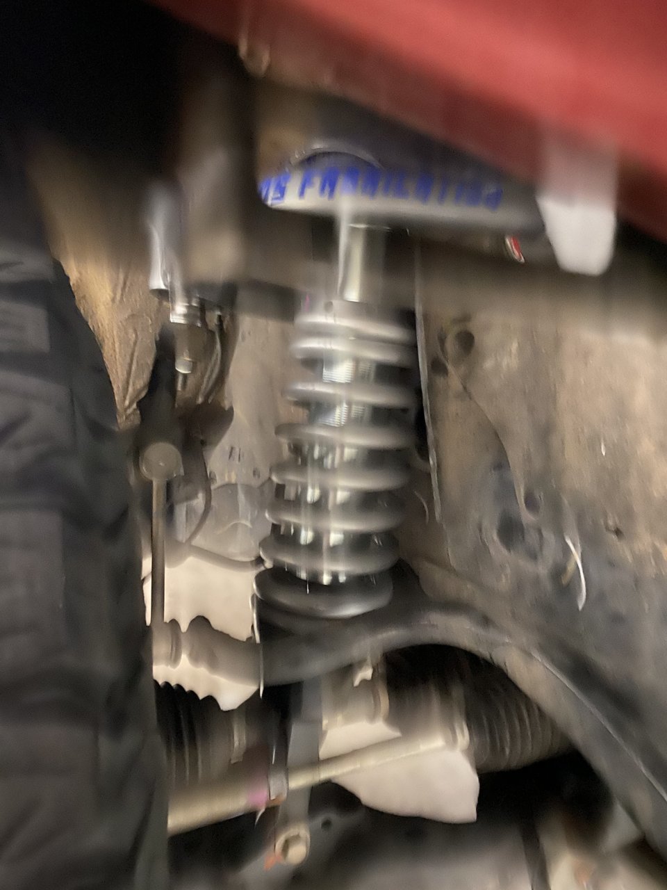

    Hey everyone, I have some questions about the suspension that has been installed on my truck. It was installed and I noticed that the first time it was installed that there was a rake. The rear had an AAL of 1.5 inches and a Fox 2.0 with piggybacks. The front was a Fox 2.5 coil overs without reservoirs. I noticed that their was a rake the first time so I took it back in and it seems like nothing changed. I’m not saying they didn’t change anything but their is still a rake and I’m trying to run 33s. My wheels have a -10 offset and I’m running 31s but even then with 33z they won’t fit if I’m already almost hitting the fender. I feel like their isn’t much lift in the front.

    Can you post a picture of the front suspension so we can see the adjustment on the coilovers?

    Yeah I can this is the left side

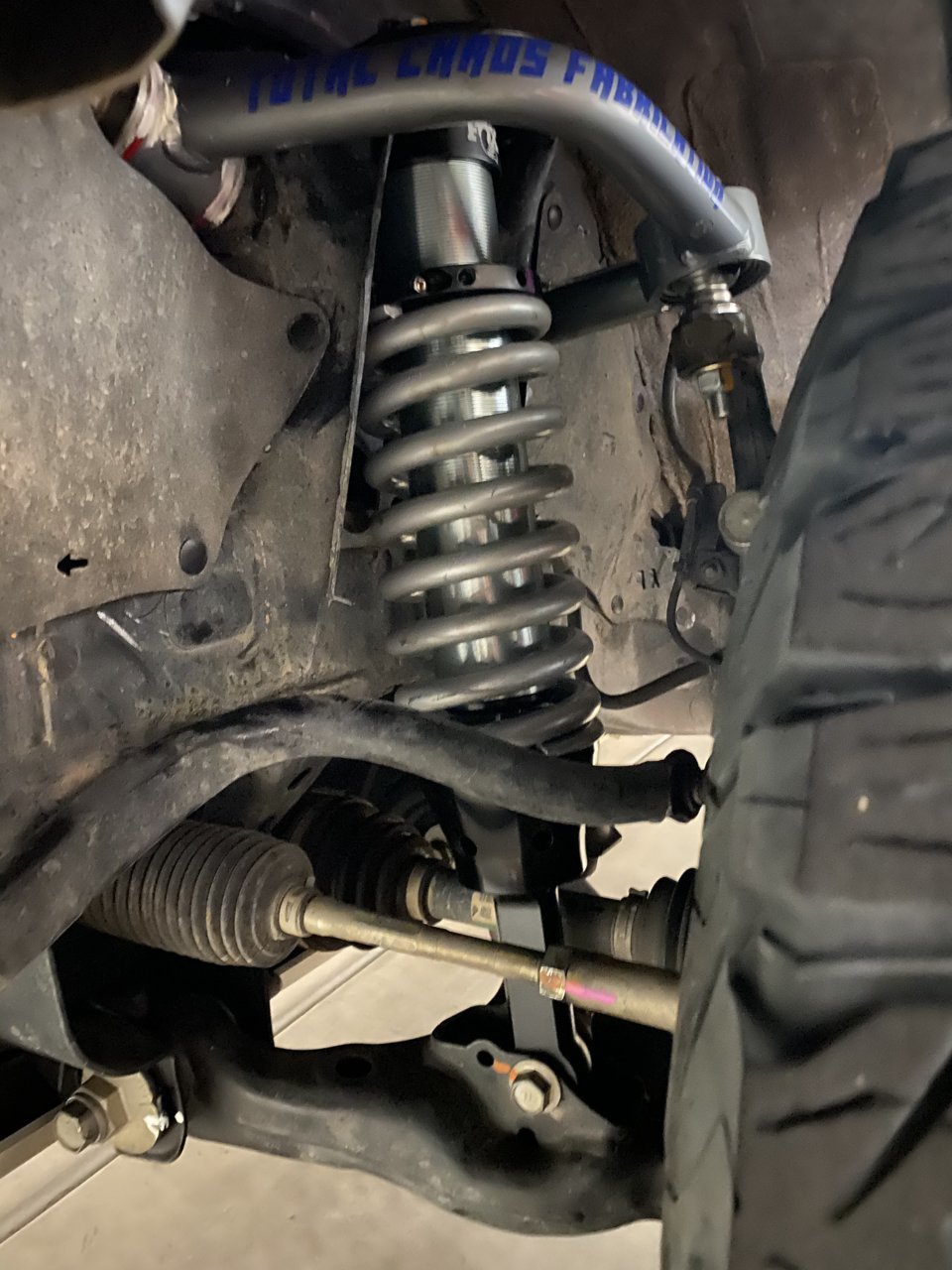

    This is the right side

    Wow, that preload is wayyyyyy maxed out. The shop did that??

    Doesn’t look like preload
    it’s a short coil

    It’s weird because these are the 0-3 inch Fox Coilovers

    Whats weird is the truck appears to be sitting flat/level ground in a garage or something at normal ride height and there is only like 1" of shock shaft exposed, thats not right. Almost looks like the springs are too light or something.

    Coil does look too short. OP did you buy them used or new from a good retailer ?

    doesn't even look lifted. Your cv angles look stock lol.

    Something is definitely not correct. Spring is either too short or too light. I think they installed the incorrect parts up front. Can you find any part numbers on the shock or spring?

    What springs are you running up front?? I believe King coilovers are 4 turns equals 1" of lift (could be wrong) but I only have about 10 threads showing and that's about 2 1/2 of lift. Long story short, it looks like yours are threaded WAY down to composite for having the wrong coils.
