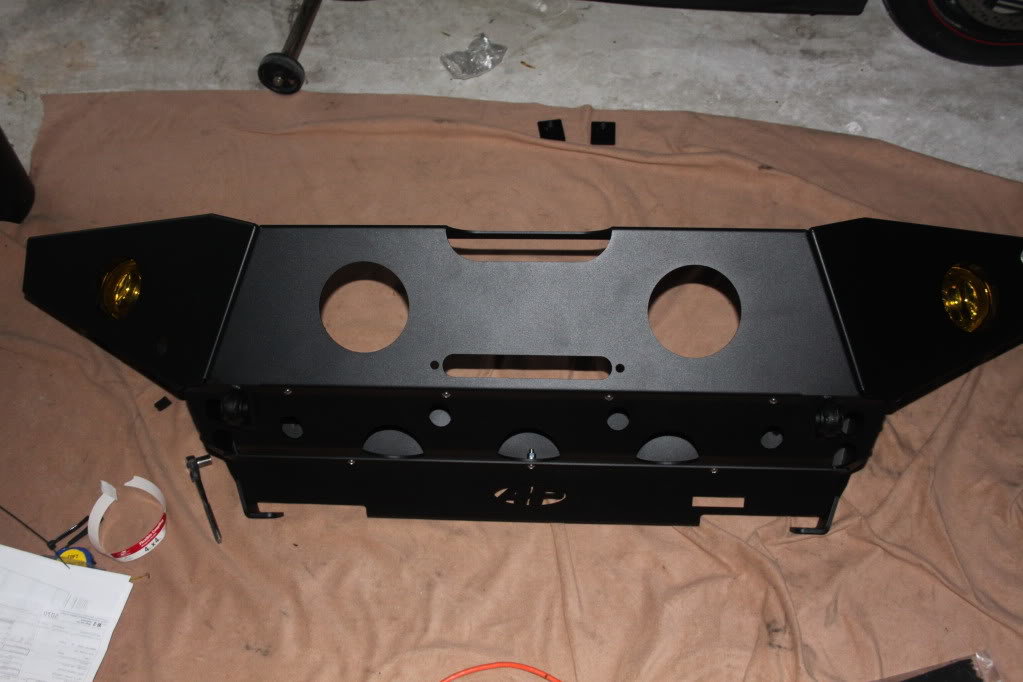

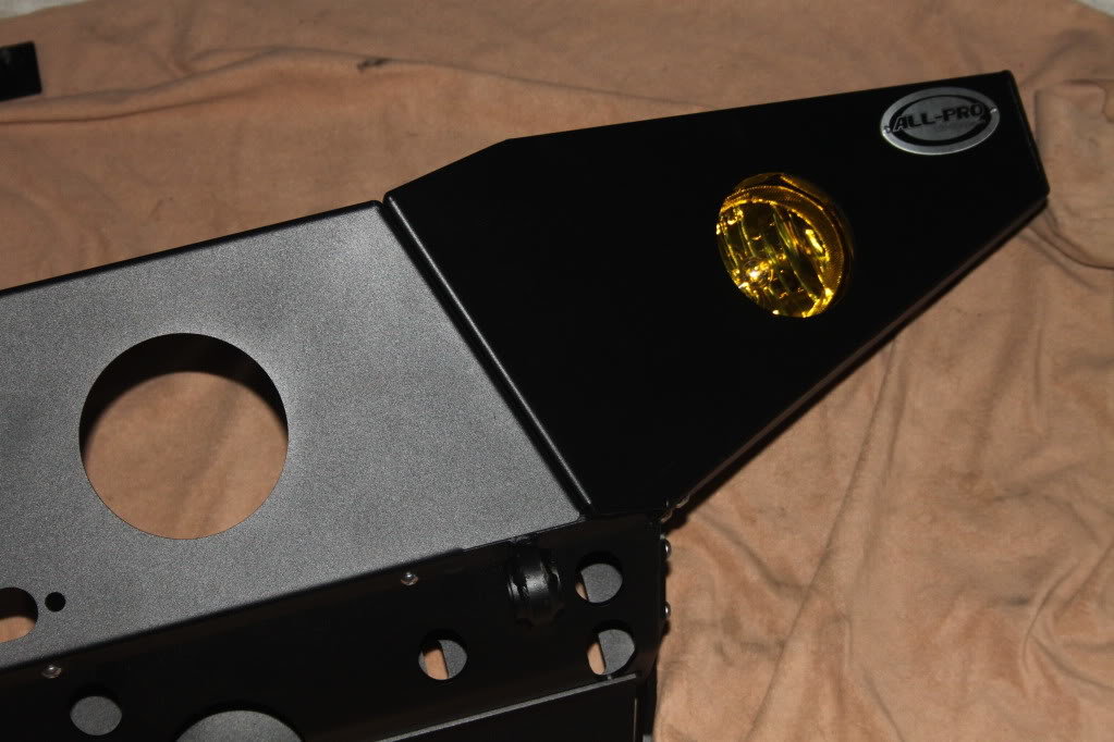

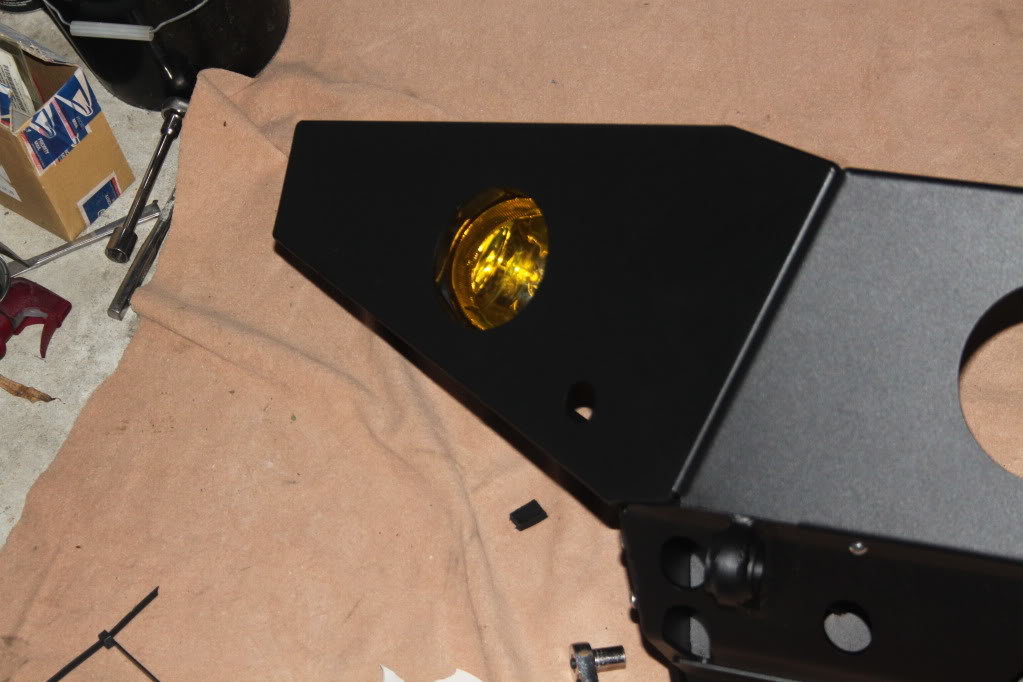

    Well knowing that I wasnt going to pay 200+ bucks on some piaa foglights I figured this was the best 5 bucks spent to install my stock fogs. I bought a 4" rubber coupler with 4 hose clamps...works great and stready too:D

    Good idea!

    looks good

    Did something very similar! NIce job.

    x2! Excellent idea, I did mine a little differently though. I wrapped the OEM fog light housing with a thinner steel that had a stud welded to it.
    If I had seen your way, I would have done it like that instead. Good job!

    You put more thought into than I did. I just jb welded to pieces of metal up top with hose clamp. I like your idea better.

    Yea.. Took me 10 mins of thinking lol.. But thanxs.. Thought I should share trying to find the easiest cheapest method..

    Do they still project the light well since they are so far back in the housing... aimed correctly? I am looking to do this same thing next week! Thanks!
