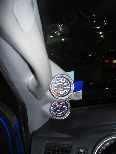

    So I have a scangauge and all, but miss the volt and oil pressure that is found on every other vehicle I have ever owned.
    It was easy to wire up and install, just minor trimming on the handle. Its the lotec pillar btw. The gauges are Autometer sport comp II, white LED through the dial lighting.
    I have the oil pressure sending wire ran and ready to plug in, just have to find a BSP 1" extension. As most of you know, the stock pressure warning gauge uses BSP threads, and most senders use NPT. So I had to find a very special adapter. I ended up finding one that has a male BSP that screws in stock sensor hole, accepts 2 1/8 NPT, and 1 BSP for the stock sensor. Just need that extension though to make it all fit nice. Summit has one, dunno if NAPA will but I doubt it. Oh well...
    Anyways here are a few pictures. What do you think?
    One thing for me, they are really bright. I have it wired into the dimmer, but being LED they dont really dim, they just eventually shut off. So Ive trying to decide what to do.
    One option, autometer makes an LED dimmer than I can get to DIM them down some.
    Option two, summit has some gauges as well that supposedly are led amber. Id like the color match I think, but that means Id have to buy more gauges and lose money on mine selling them on Ebay.
    Option three, get the sport comp I version with regular lighting that I can plug in LED or put on a bulb color. Its not through the dial lighting though, its backlit..so I dunno
    Not the best pics, but you can see the brightness levels. Thanks!

    With those gauges in that spot, does defrost air still flow onto the driver's door window?

    i have one. i monitor HP, MPG, Ave MPG, and didnt want the other one on volt..and it doesnt read oil pressure. IAT is my 4th, but I go to loop and tps some times.
    You can see it in this picture some, its up in the cubby above the drink holders. I see it perfect, and just dont put a drink in the drivers spot. Sorry passenger...

    I dont know how much coming off the defrost actually hit the window, I know that some always came out of the vent though and still would fine. I'll find out that answer for sure in the morning though!

    I just got my ScanGuage. It is a white backlight. In the picture yours looks like its the amber color matching the dash. How did you manage that?

    what model do you have then? i have sport comp II, but its white LED. when they are unlit, the face and trim match the factor perfect.
    Like I said, I didnt want to use scancage for volts.

    Mine are the cobalt series autometer gauges and they're quite bright. You honestly just get used to them. They don't bother me anymore at night.

    Kind of a zombie thread, but it occurred to me that if the gauges are still too bright, pull them apart and tint the glass (or plastic) front cover.
