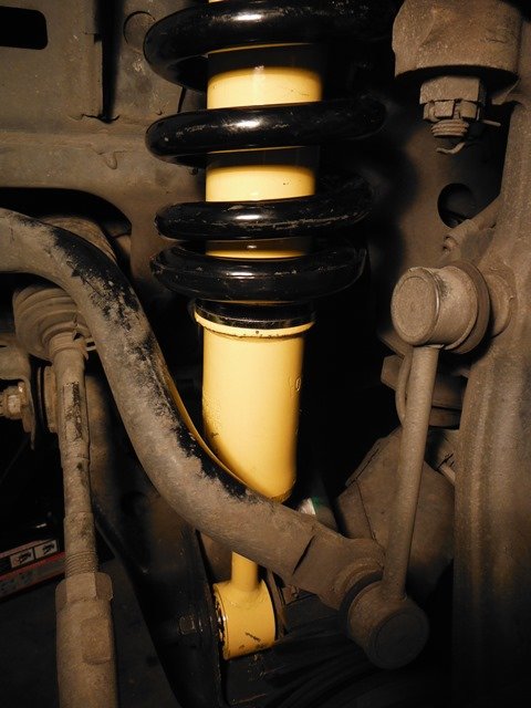

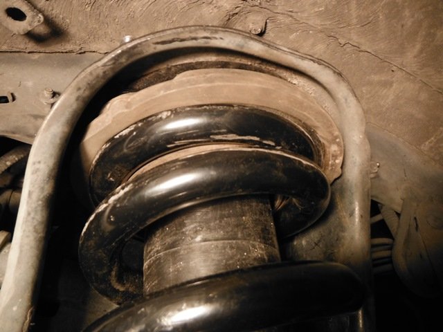

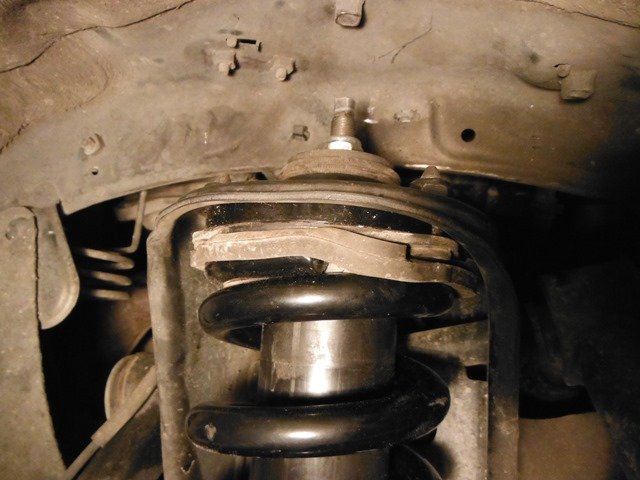

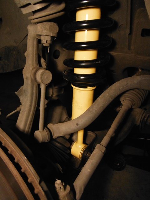

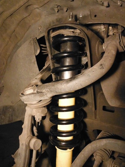

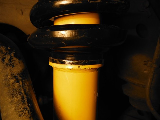

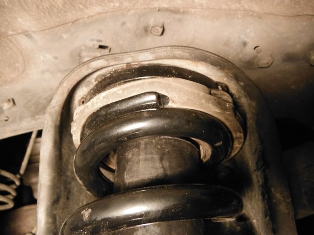

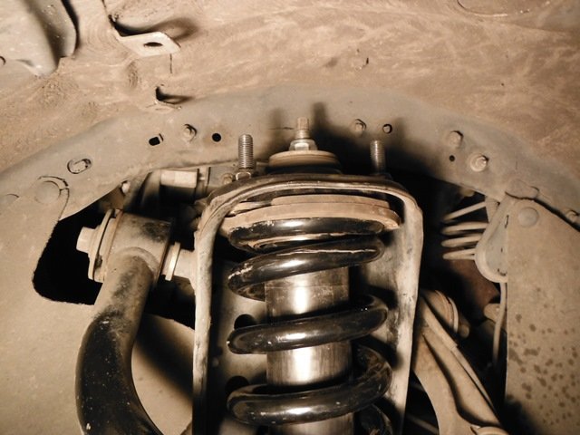

    Ok, here are some pix:
    Drivers side:
    Passenger side:
    Ride heights before (with 5100's all 4 corners, set to 2.5" in front, wheeler's 3 leaf AAL's in rear)...all measurements are center of hub to fender flare:
    Front drivers side: 22-3/4"
    Front passenger side: 23-1/4"
    Rear drivers side: 23-1/4"
    Rear passenger side: 23-1/4"
    Ride heights after with OME struts and coils, anti-lean ring on drivers side, and 3/8" top plate spacers:
    Front drivers side: 23-1/4"
    Front passenger side: 24"
    Anything look particularly wacky or not right?
    It's really bugging me to have that passenger side higher than the other corners. Is there a thinner top plate spacer that I could put on the passenger side to even out the ride height?

    Why does it look like there is a thicker top plate spacer on the passenger side? Is there a top plate spacer on the drivers side at all?
    If you're wanting to raise the driver, or drop the passenger, adding more/thicker top plate spacers to the passenger side is going to make it worse.

    I noticed that too. I'm not sure why it looks that way. I think the rubber gasket on top of the coil is molded in such a way that it conceals the top plate spacer more on the drivers side. I'll have to measure both sides just to confirm that somethings not funky.

    Is the passenger coil upside down and therefore not correctly seated in the coil perch ?

    ^^^ Looks like it. Nice eye.

    I'll double check this when I get home from work, but I think since the coils are tapered at the bottom there's no way one could even get the top of the coil even close to seated in the perch, so I'm pretty much 99.9% confident that is not the issue. But I will double check. Thanks for the thought.

    Looks like OZ-T is right to me :eek:
    Who did the handy work :confused: You pay some shop
    If this is the case that Top Hat might be screwed up. There’s the lip that the isolator goes over top of and the lip of from the isolator. Doing this in reverse could destroy that isolator and that lip which is designed to center the coil and prevent it from moving side to side. Also with it reversed the coil won't seat in the bottom perch correctly which can make the coil compress on one side more than the other.
    Hopfully its done right and the photo is just throwing us off.
