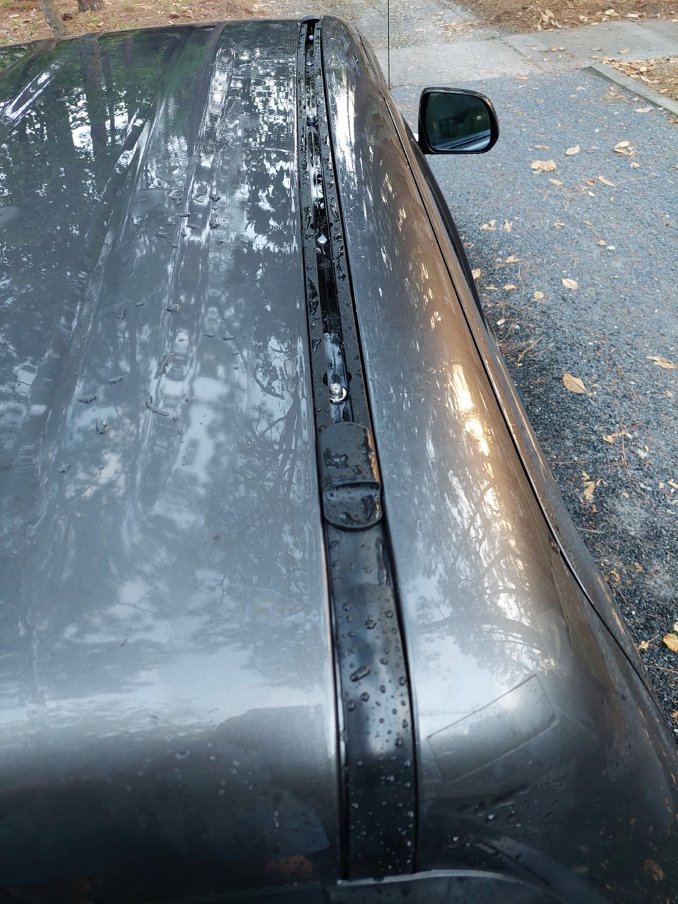

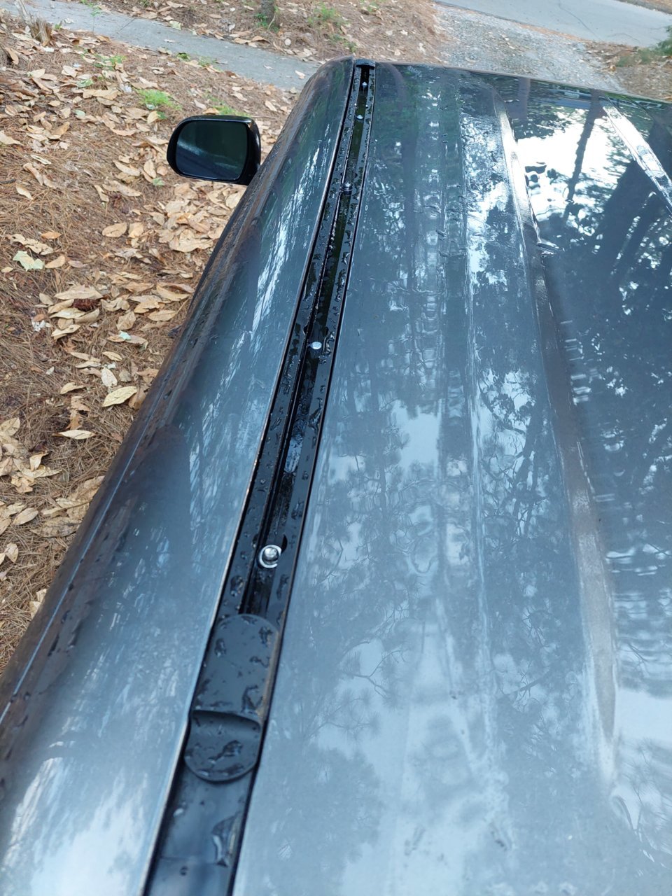

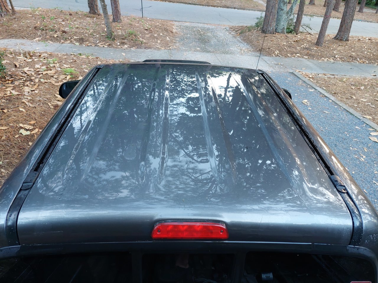

    I found these for $233 on Amazon and installed them today. The rivets were the only tricky part, and I slightly bent the rear most part of one rail using a cheapo rivet gun from Lowes. Don't recommend that one. Went to Harbor Freight and grabbed the big blue Pittsburgh model (they look like hedge clippers) for $20, and that did the trick. Much more leverage and it comes with 3/16 rivets in case you jack up one from Rhino Rack.
    The other thing I noticed is that the included hex wrench is a really poor fit for the hex bolts. Will post up some pics soon-ish.

    The outcome (post hose-test to check for leaks).

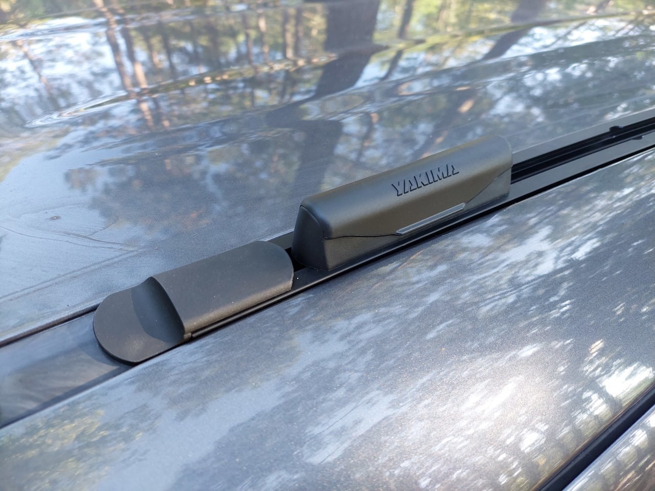

    For what it's worth, here is the Yakima Landing Pad 4 in these tracks.
