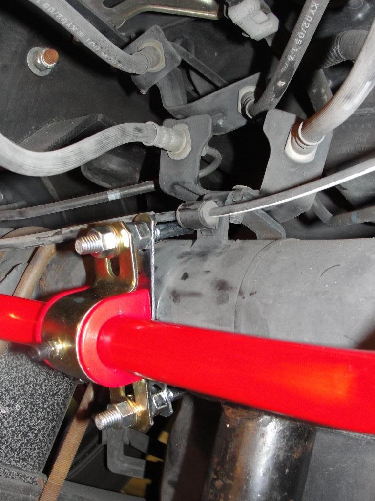

    As for a review, well I haven't got to push it like I wanted to last night, too much traffic, but the rear feels less squirrely then before, follows me into and out of turns. Shit I noticed the difference just pulling out of my garage and parking my truck in the street! Unfortunately having this on really shows how crappy the rest of our suspension really is, ESPECIALLY Bilstein shocks...terrible.
    anyways onwards with the pics.

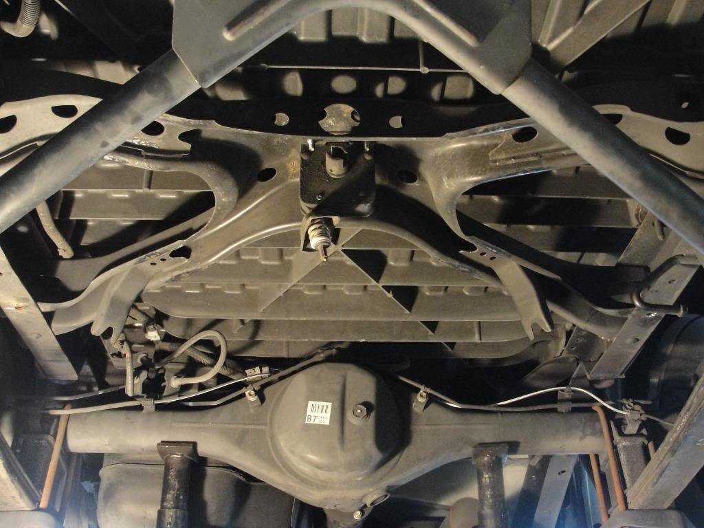

    everything needed, minus a few U-bolts from ACE and bolts for the brackets.

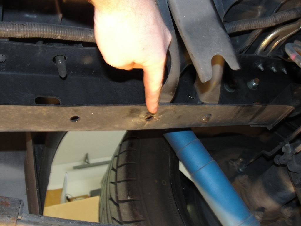

    rivet that was removed, on each side (this look the longest, minus my wait to install them :eek:)

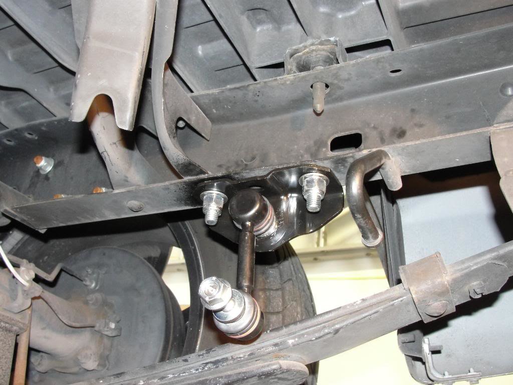

    you can see the two sides here maybe a little clearer where they are for you noobs that haven't been under your trucks before. Note my X-brace :cool: (to be painted Red to match the sways)

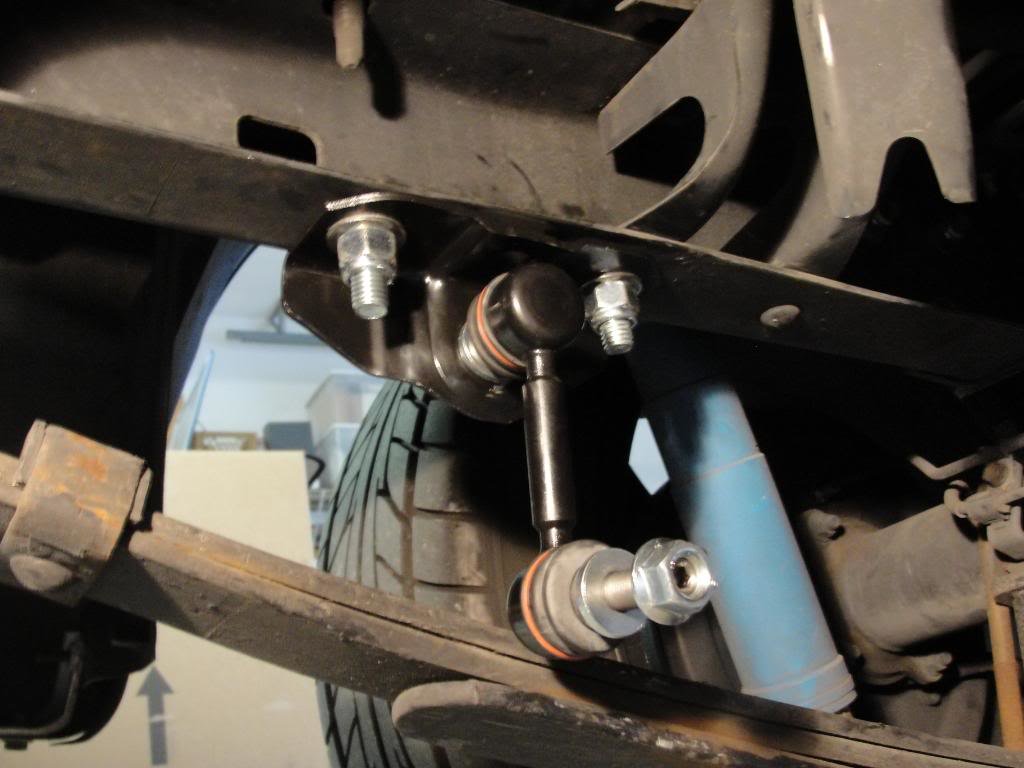

    Brackets mounted. holes in the frame and the bracket are drilled out to 1/2". bolts are 1/2" x 1.5". used washers are each side a nylon lock nuts. Torqued down to specs of my back and bi's :cool: (don't want them going anywhere!)

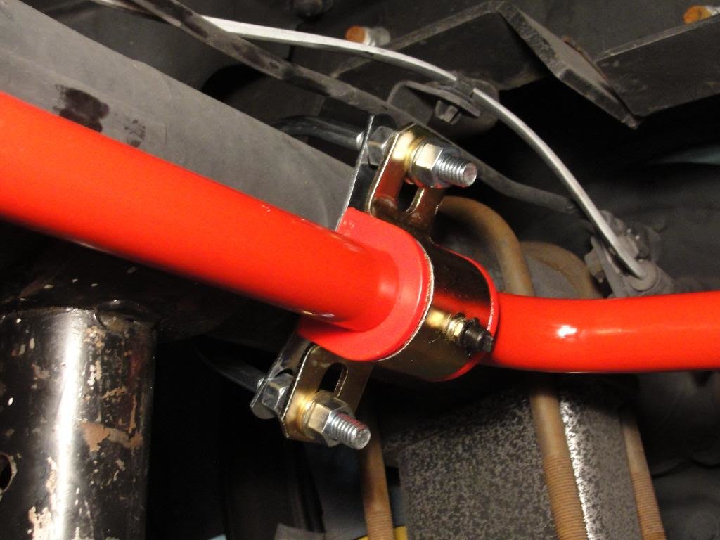

    U-bolts on the axle

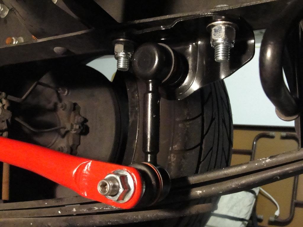

    complete end links

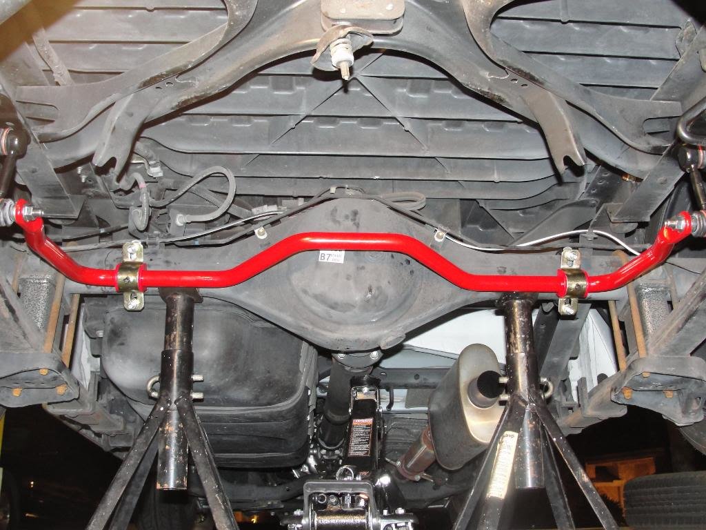

    and a shot of it all, the red is pure sex under there, it's so clean!

    If i were you i would not leave you exhaust like that, keeping it that way will heat up the axle housing and cause premature failure of the parts inside.

    lol nahh never had an issue. besides, it's a 4 banger not an LS motor

    Were you using the drive shaft as a lift point with your floor jack? :eek:

    yup. it's fine.

    Oh man, those end-link frame attachments are SOOOOOO much better than the ADDCO bar I installed. It's not even funny!

    I just installed my sittin sic swaybar on my truck tonight and man what a difference. The truck is so much more stable around bends, it's a complete different animal. If anyone else is interested in this mod I highly recommend it.
    For questions on the parts required this is what you'll need.
    -2 3" U-bolts 3/8" (exhaust clamps work mint)
    -4 M12x175 bolts and all the matching hardware (I used all lock nuts)
    -Linkage from rockauto.com ($35)
    -X-Runner sway bar brackets from https://www.trdparts.com/ ($50)
    -12.5mm Drill bit (or 1/2")
    -Black spray paint
