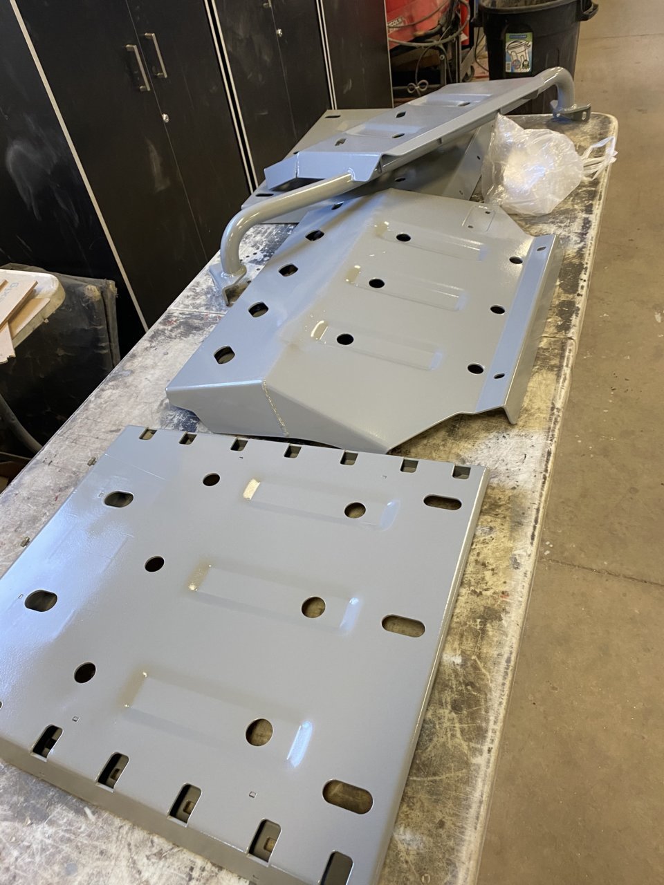

    I had a set of ARB skid plates installed on my 2018 DCSB. Cab sounds like I have a straight pipe exhaust now, so much engine noise!
    What should I investigate first?

    Does not sound like rubbing. Sounds like exhaust noise being reflected into cab. It was installed by a garage who powder coated them. I got a bill for fasteners for $14.50.
    Hahahahahahahaha. I paid 3 hours labour at $80 to get them installed! Truck was whisper quiet before the plates were installed.

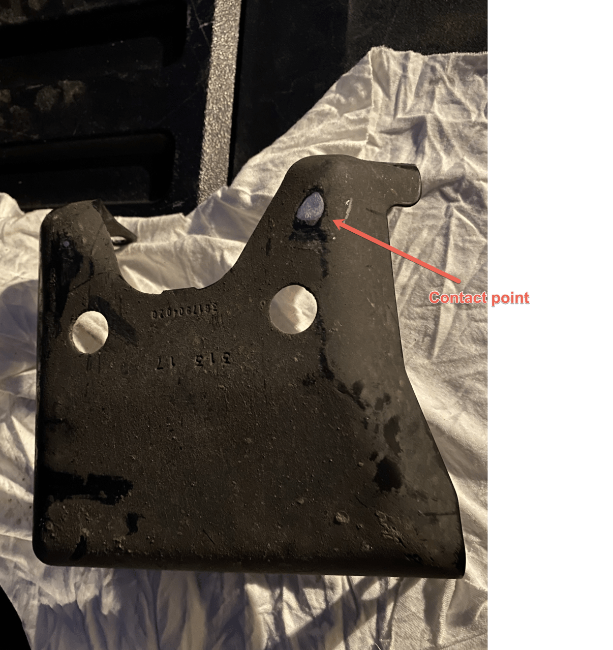

    Slight interference between plate and a stock rock guard on rear transfer case:
    I claim I have the prettiest skid plates on Tacomaworld, they are powder coated same as the body:IMG_0614.jpg

    Yes, I just removed and discarded the pictured black rock guard. That rock guard was contacting the plate!
