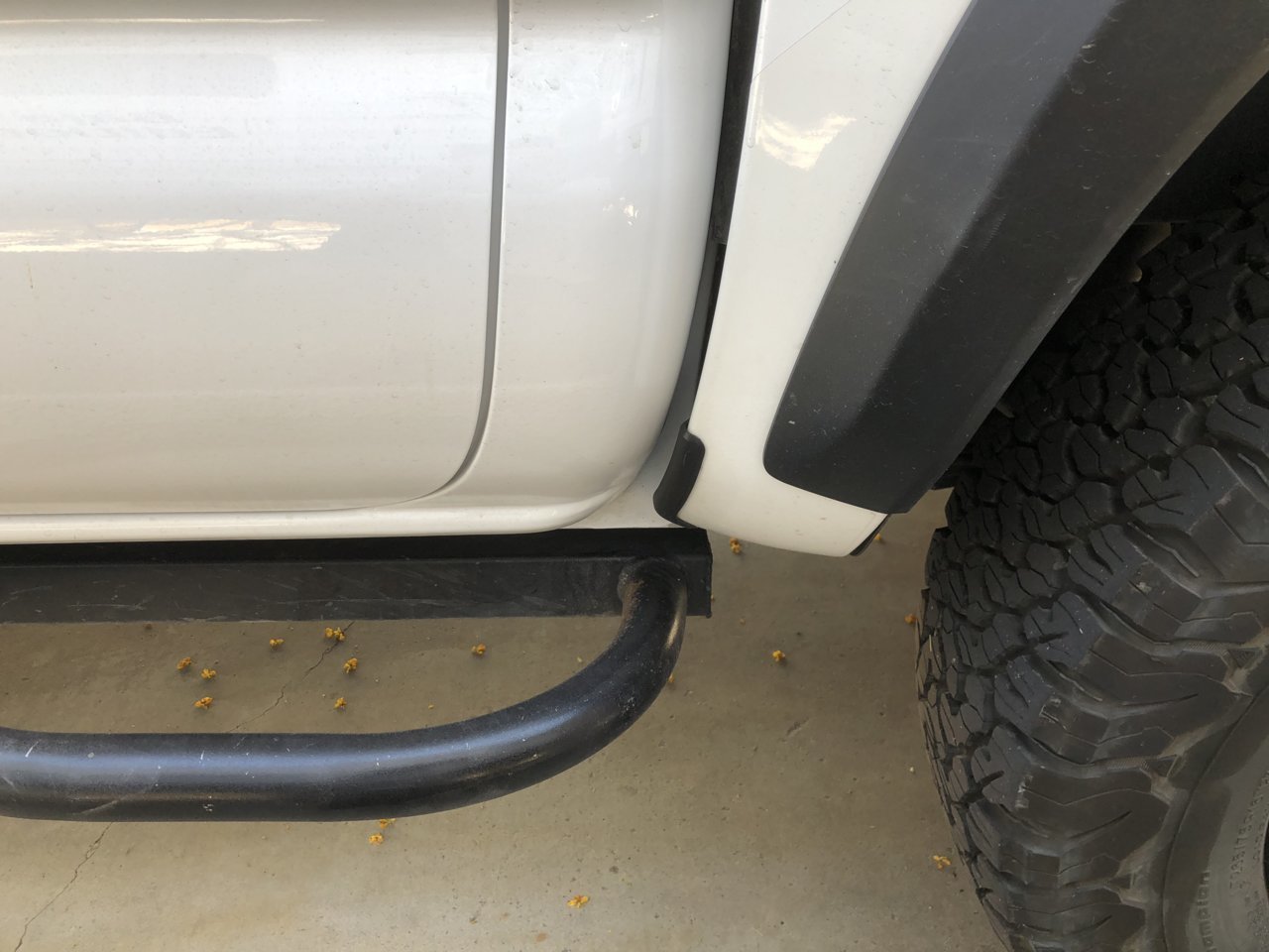

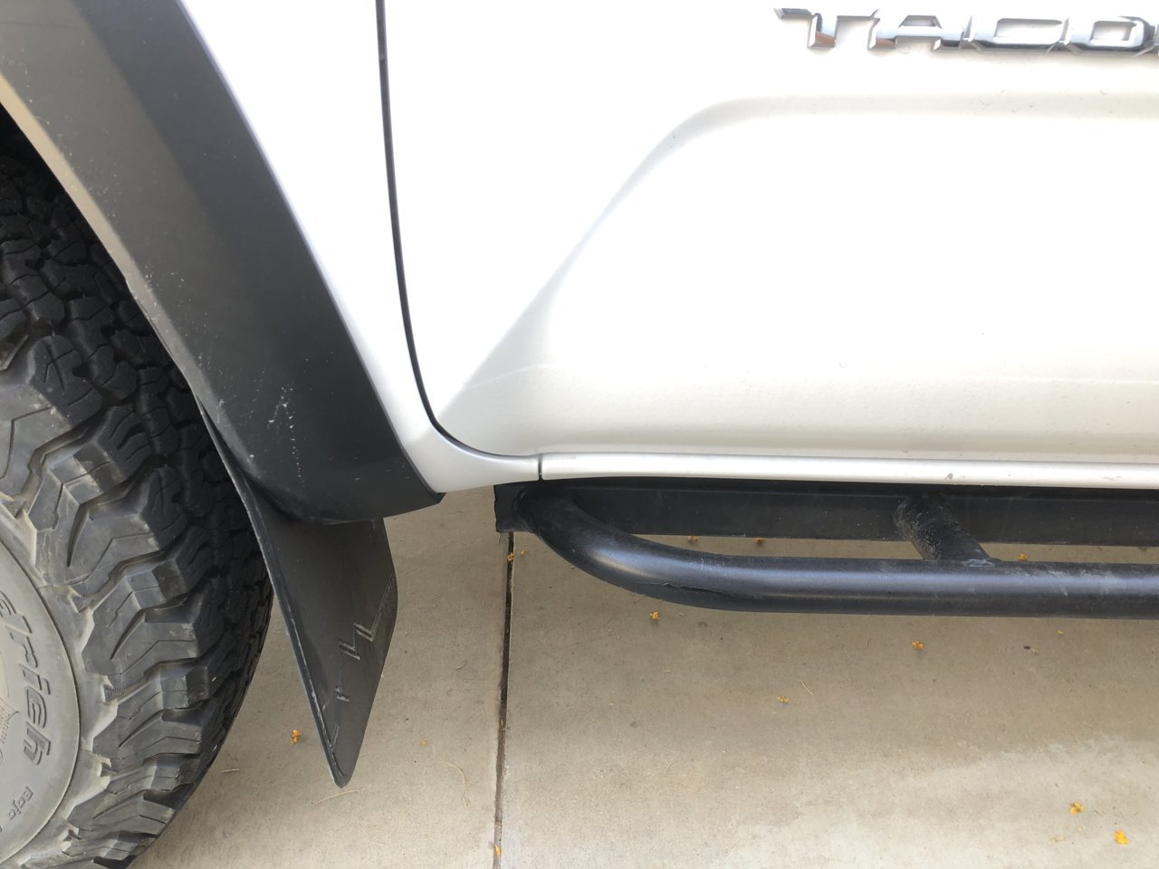

    I think the answer is what kind of infrastructure it takes to support that extension out to the fender edge. You can see the pieces on either end of these sliders that have to reach way up and out to the frame. What is with the long span in the middle without support?
  9. May 15, 2018 at 4:11 PM
    #69
    jowybyo
    jowybyo Well-Known Member
    Nov 19, 2013
    #116863
    6,092
    Joe
    Baltimore, MD
    '14 MGM DCSB Postrunner 4wd Conversion, Debadged
    So, let's dive right in. You want them end-to-end for complete coverage of the pinch seam and to cover that small weird section of the bed at the beginning of the wheel well. To do that you have to hang the main tube pretty low on the frame. Basically, you have to hang the support legs below the bottom of the frame. You could get away with making it work without doing this, but the main tube would be stupid close to the pinch seam. If you notice, the rocker panel dips down as it approaches the front wheel well. This is all well and good, but what we've found after selling a boat load of these, getting feedback and making revisions is that the body on our trucks move a lot. The movement causes contact with the slider tube if it's too close. This leads to an annoying thud over every bump. Since most are daily driving their trucks, it gets pretty old quickly. You could in theory taper the tube like White Knuckle does, but it's a compromise. We decided against it because we were worried that section would permanently deform too easily and cause damage anyway. Also, fuck if there isn't a lot of versions to the frames and the dimensions even among the same year and model. Makes it pretty hard to run them close since every truck is slightly different. Now in the rear, it's kind of the same situation. You could try to get more coverage, but you start to get pretty far from the last good spot to attached to the frame. You end up with a even large cantilever than you already have. Since we designed ours, there has been at least one unique design I've seen to get the support you need, but it still doesn't address the fact that a lot of people trim their fenders and run larger tires. So to summarize, it's a compromise for what we feel most people would except. Could you do it's differently, yea, maybe. But it's a little different building a one off set for yourself and excepting the issues with your chosen design than it is building 1000's of sets for the masses.

    I think this wraps up this thread pretty well:thumbsup:. As I looked at more and more pictures of these I began to understand the reasons and I am OK with the compromise on my truck. As an earlier poster pointed out (un-diplomatically:rolleyes:) you can pick your lines when you understand the limitations of your vehicle.
    Oh - and changed the title to boot.
