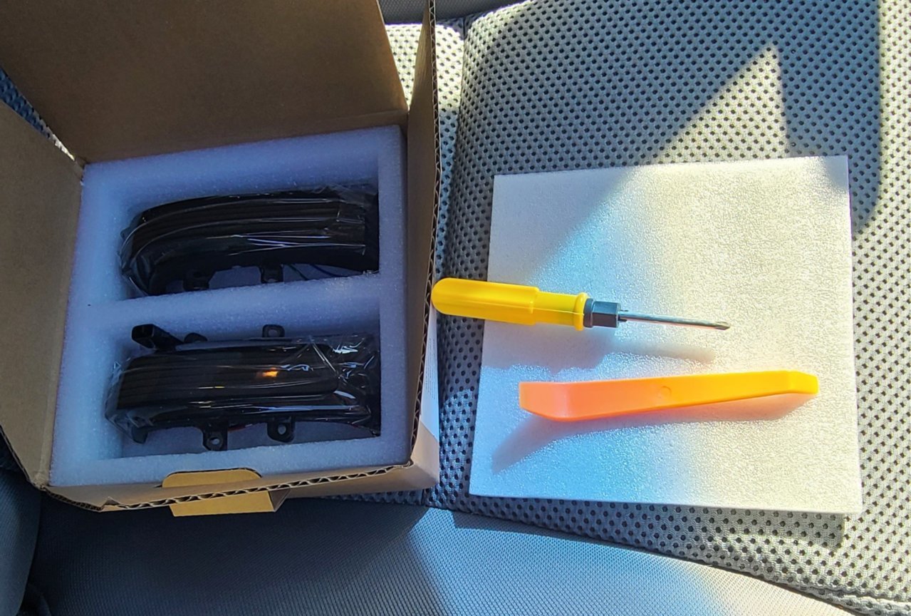

    I like the dark signals and the sequential lights turned out pretty neat. $44 from ebay and they included the tools to pry off the mirror cover and even a Philips screw driver. The signals were well packaged too.
    I searched a lot to find a video on how to remove the covers, but didn't find much so I made one. Turn signals in action on hazard mode at the end of the video.
    https://youtu.be/q3FLLy96X4M
