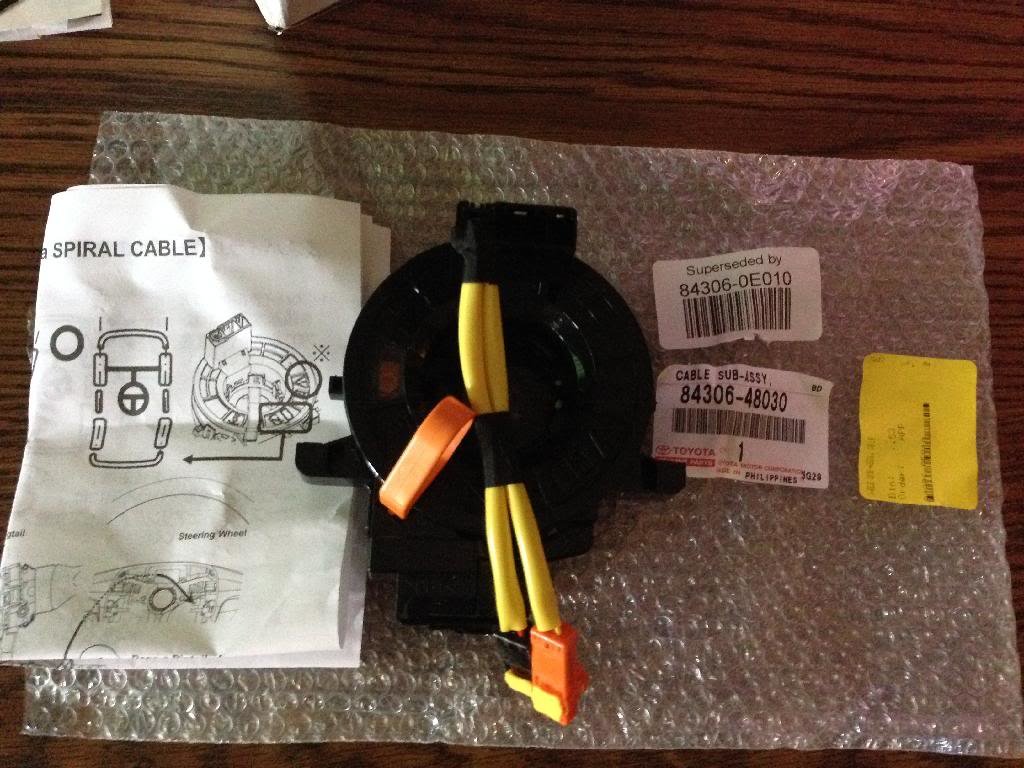

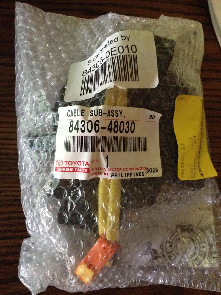

    Toyota Tacoma Spiral Cable: Part #84306-0E010($244.31 total with shipping)
    40E73341-C4C3-4F9F-A1DA-A1869C254AE1_zps_bde868281ef2e38234280e55f2e36dc357c66447.jpg

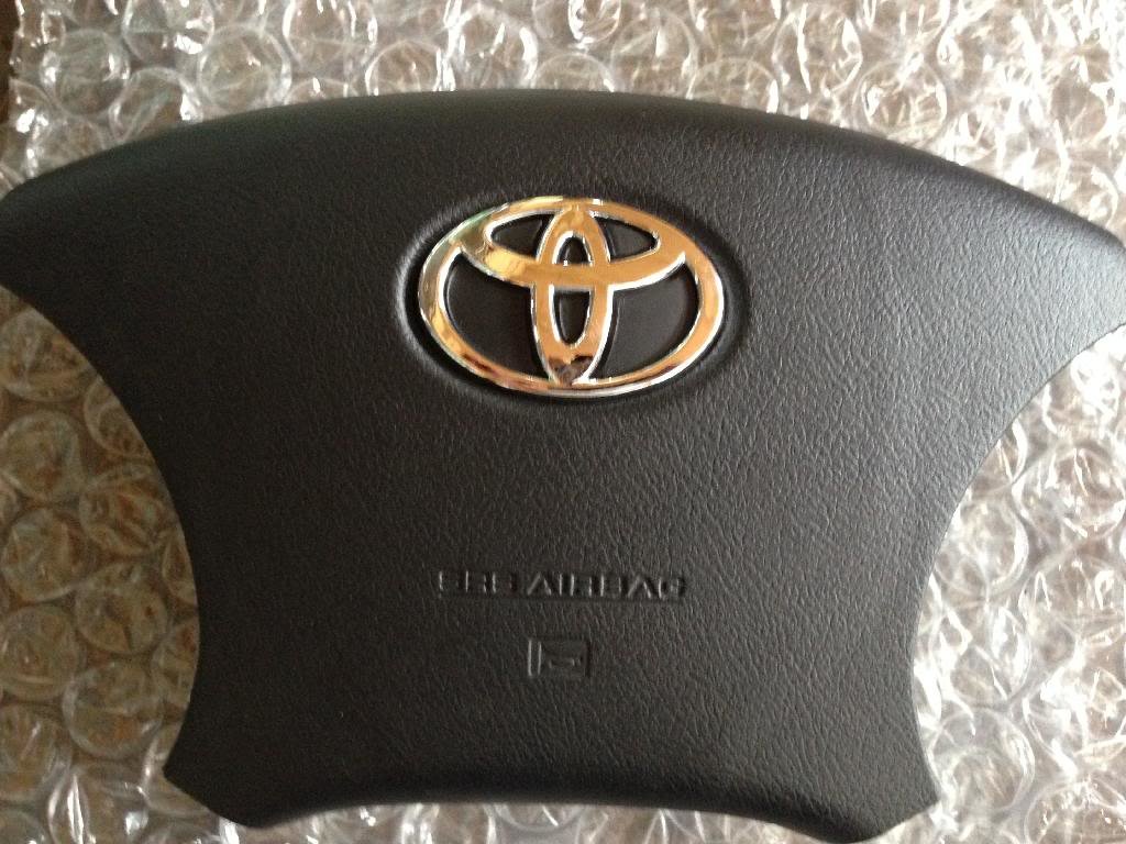

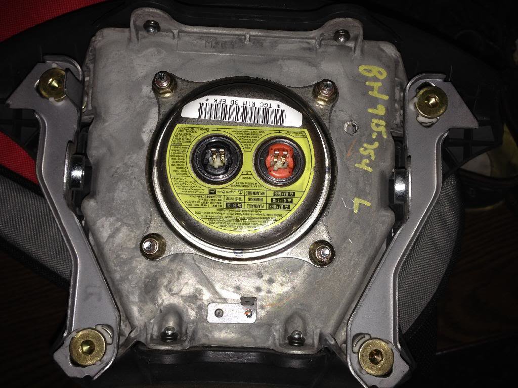

    TRD Sport airbag.($335.91 total with shipping)
    CC1EA394-D855-4602-9C8A-32F6634A6E37_zps_b9c10742718705116603aff1fb76cee7fbf2da52.jpg
    ABFD9340-31D0-42AF-999D-7EAA160BE687_zps_9581684cad22a8f1a846d90f41abf3450173183d.jpg

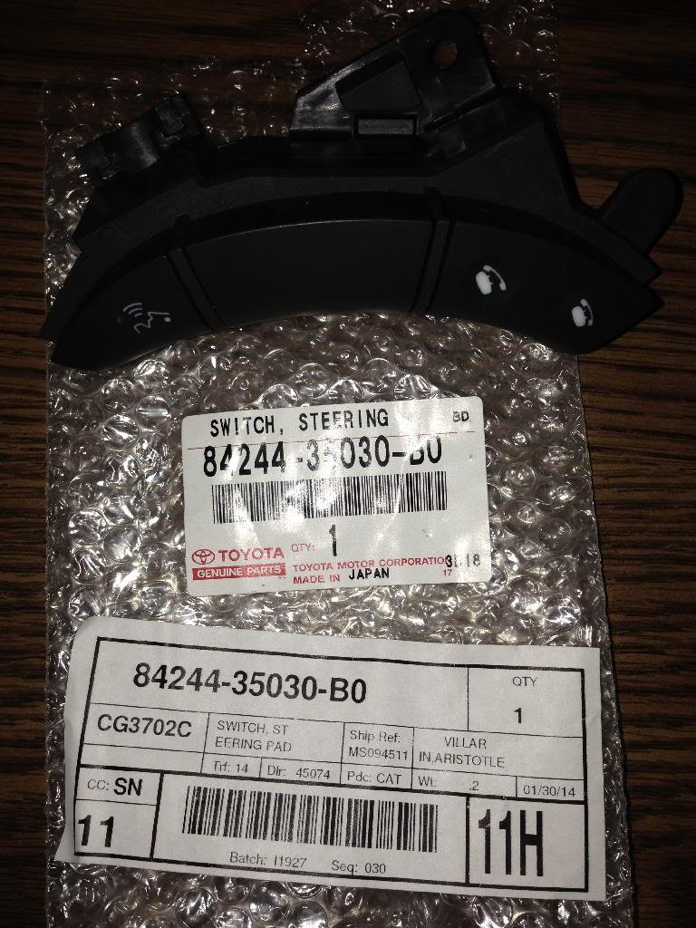

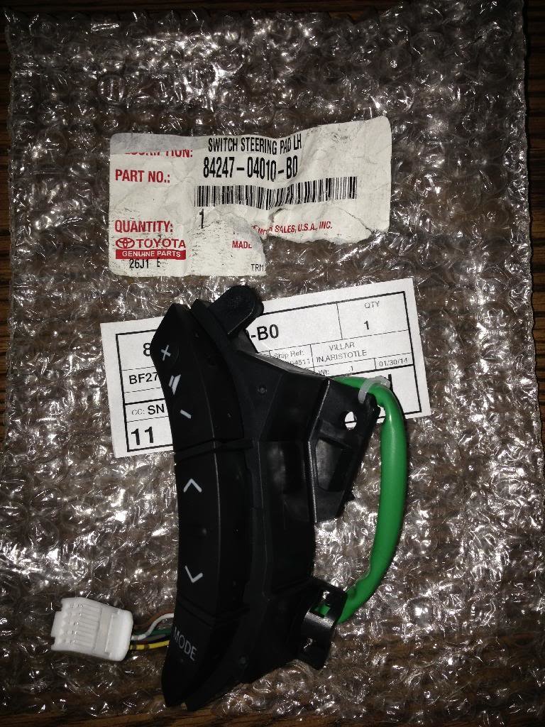

    Switch Steering Pad, left side.($80.66 w/out shipping)
    D48BD15E-228A-4D15-9D06-AB1AF336F463_zps_2494d00ea136669c06687fbb29e1ada21d63b9b8.jpg
    Switch, right side.($69.76 w/out shipping)

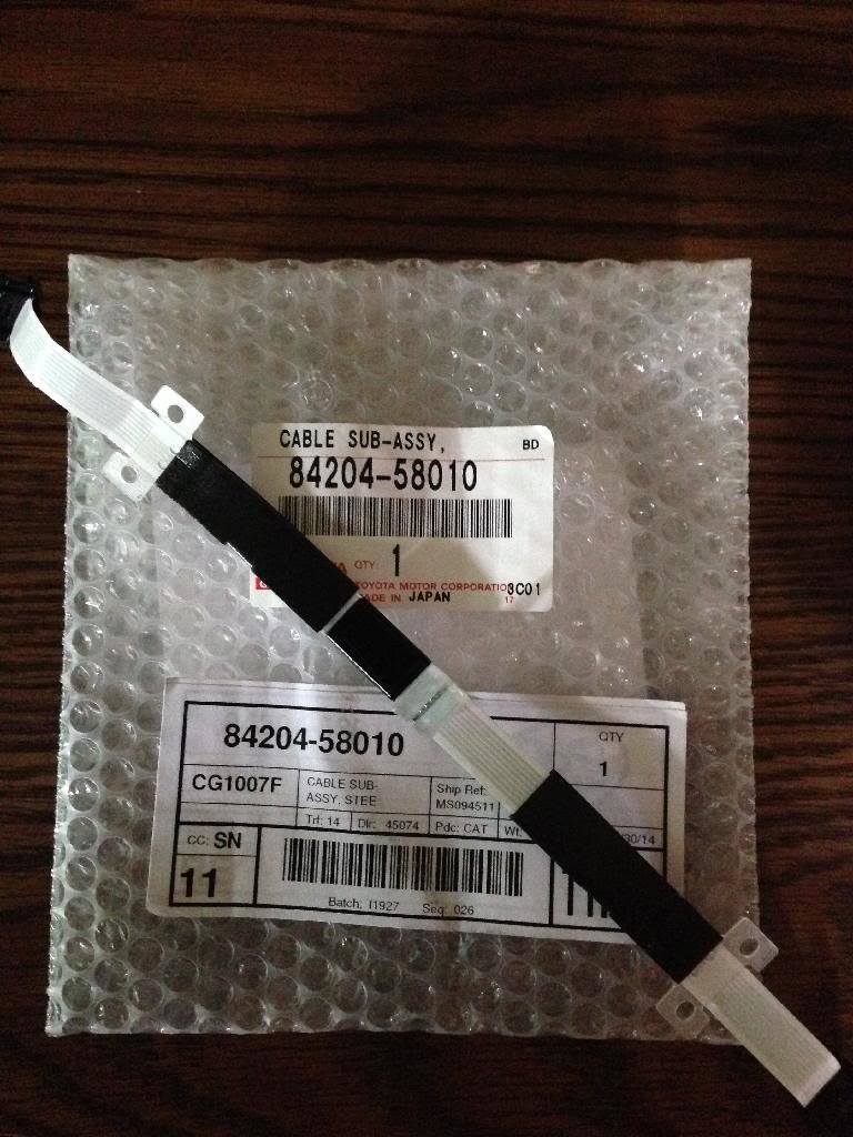

    Cable ribbon that connects the right switch to the left switch.(30.43 w/out shipping)

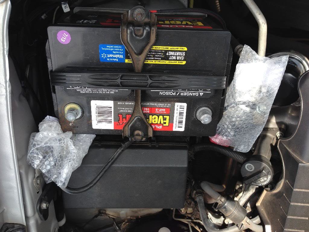

    STEP 2
    Disconnect the battery terminals by loosening the 10mm bolt. Just to be on the safe side, I removed both the neg. and pos.and wrap them in plastic. Kill some time to at least discharge the system completely before proceeding to Step 3.
    3D8FDB1C-2C8A-4871-B28F-EA297199AFE3_zps_23aaa36250bba521c2735fe3704a7ec0d344ccdb.jpg

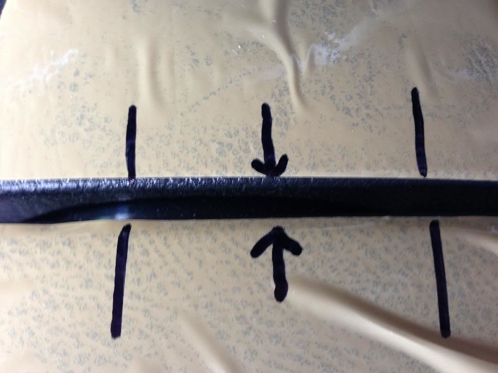

    STEP 3
    Apply tape to the top of the steering wheel and the column and draw arrows pointing towards each other. This is to make sure you have the right alignment.
    694DB09B-7196-4FB1-AA7B-44E3BA3AB8CD_zps_34d973e4df692cdf75008a0be6ab3a90c834ea13.jpg

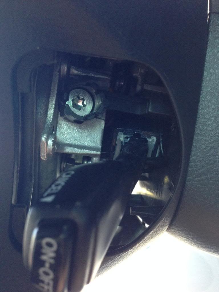

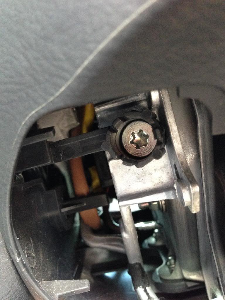

    STEP 4

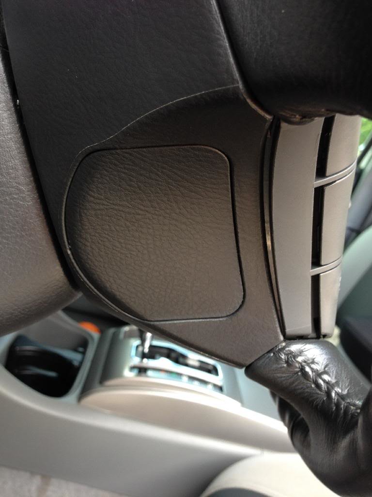

    Remove the cover on both sides to access the T30 torx screw.
    524ED993-3CC0-469F-81F4-1B0AA8603903_zps_a7b05ea1dc3f4c29fb4514fa395a74a28ea26d03.jpg
    43DE047D-55F4-4838-BAF4-23DBAEA3854B_zps_b8b26db13f9efd5df0ad4fd983e178b4d461a837.jpg

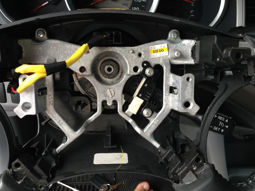

    STEP 5
    You will see two T-30 torx screws in here. Using the T-30 bit, unscrew these as much as you can. Please note that they will not come all the way out, that's ok. This loosens up the airbag for removal.
    7B61768B-7FFB-41CB-8D72-5A57381C80E4_zps_26ba1a560c43ee726b99518801f7cd277868baa1.jpg
    1526C1FB-4418-40C0-8430-3015B26E2EFE_zps_cfb6b312aaf384ae40b2d7e8f5a69a40bdb97cd5.jpg

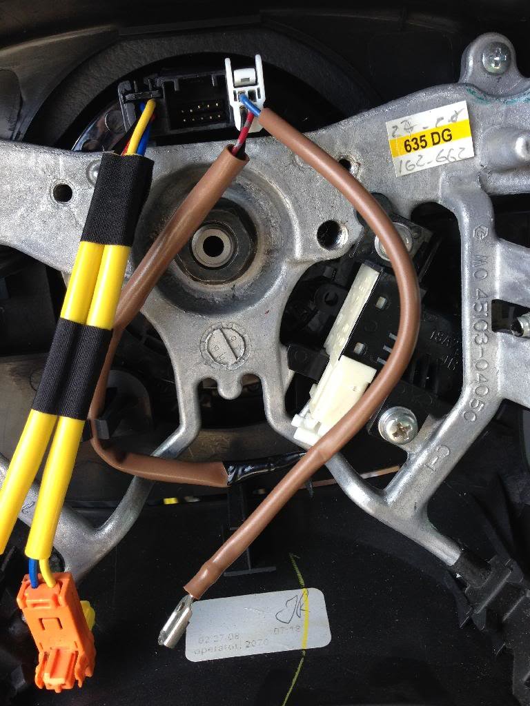

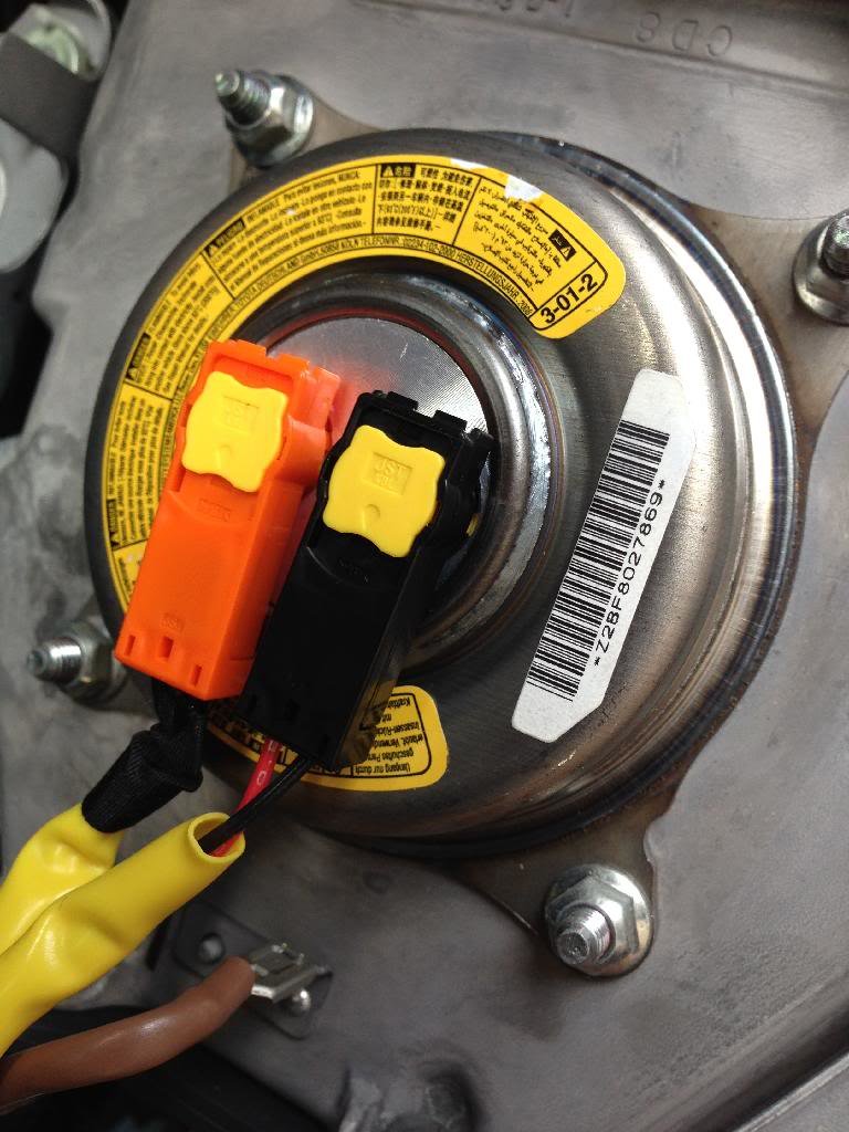

    Remove all wires leading to the airbag. To remove the Orange and Black air bag wires, you must first pry up the yellow tab to release the grip and then you will be able to actually remove the airbag wires.
    7C11E6F5-CF7E-4F89-97CA-1E25AF9ACC57_zps_eddd09ad30a3bea85bd2dae5323ac4bb7ea48bbf.jpg
    Remove the brown ground wire from the bottom of the airbag.
    21D11E1D-F96D-4F1A-B412-BC95E744FDE3_zps_960eae52415c0e52a3d4e246750e2916e024c323.jpg
    CF108A31-5631-4074-BF2E-CD272E09854B_zps_70842c153ef3a0eff79191d303cdfacbcec5221f.jpg
    Place the airbag, Toyota logo up somewhere safe.

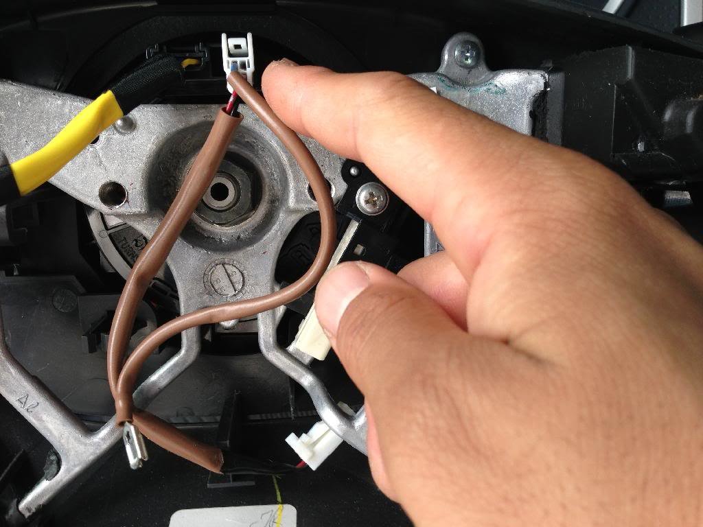

    Disconnect the brown plug from the spiral cable
    4D76D68E-E6B5-4D34-B936-FE094CCAC633_zps_93e22a62dda5ca4a054de38c5a28e3440838471c.jpg

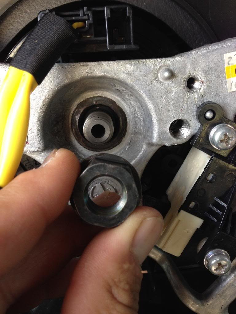

    Remove the 19mm bolt with the 19mm socket.
    CB30C865-B538-4ADB-ADE5-22CC263951D5_zps_e8f24cbaf6855d5490b84c4fff7d2d2f3bd93c8e.jpg
    F62F6CB3-A4FA-4170-A112-1357AEBA726B_zps_7eba62ad54ba09eb62ddf7f7fd17c001426c0b0e.jpg
    Steering wheel should be easily remove by gently pulling up.

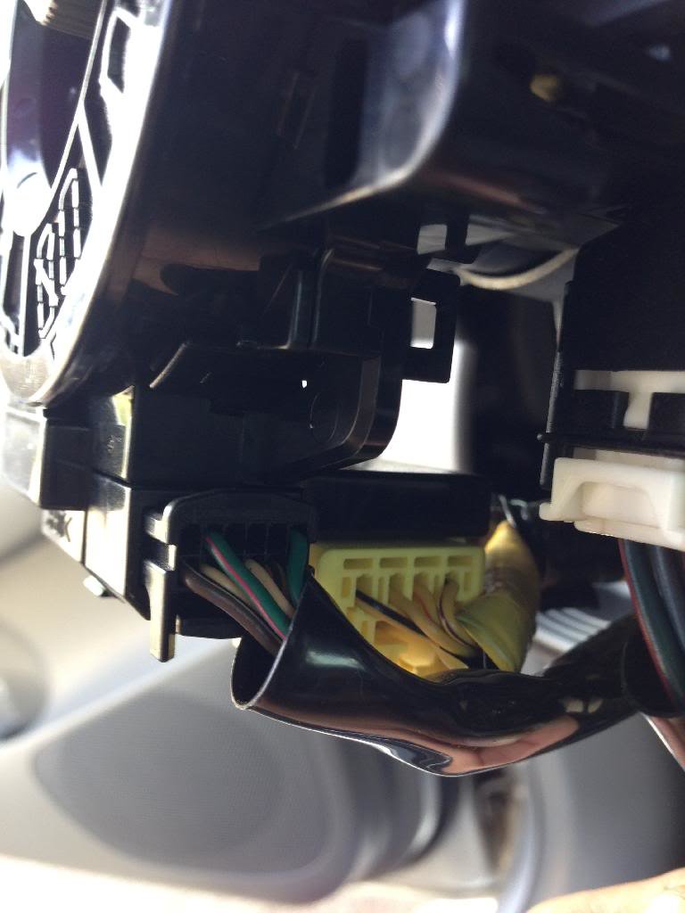

    STEP 10

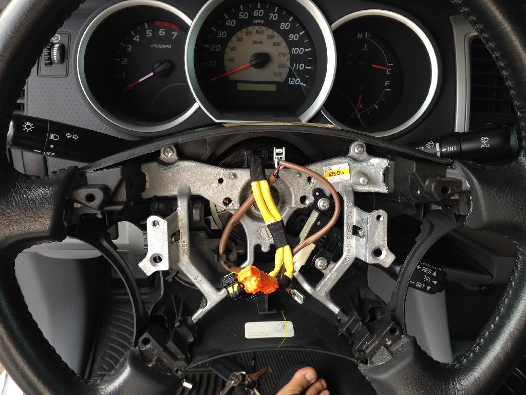

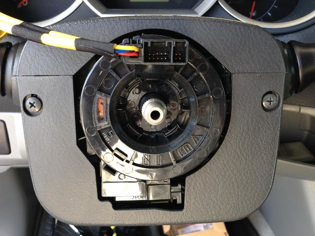

    Remove the 2 connectors on the bottom of the clockspring. One is black(steering wheel contorls) and one is yellow(airbag).
    AACF2235-BBA7-4451-9068-D03EFB51727B_zps_fa58b61f7977b62478f46c7853eb9f3f33762d0c.jpg

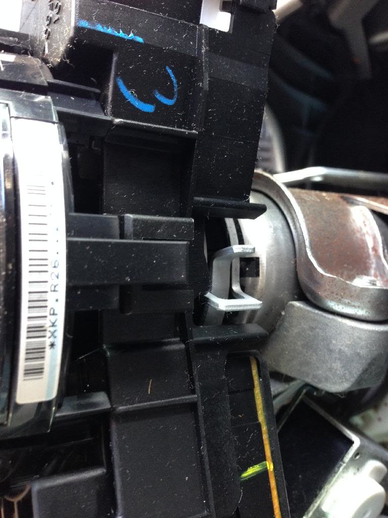

    STEP 11

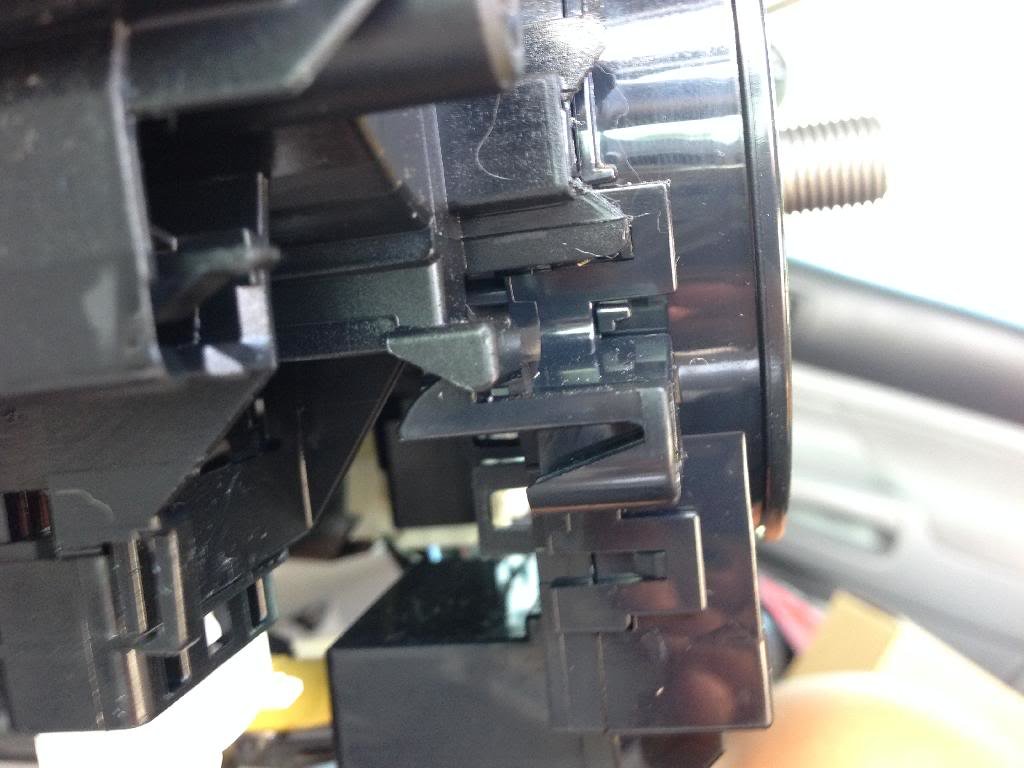

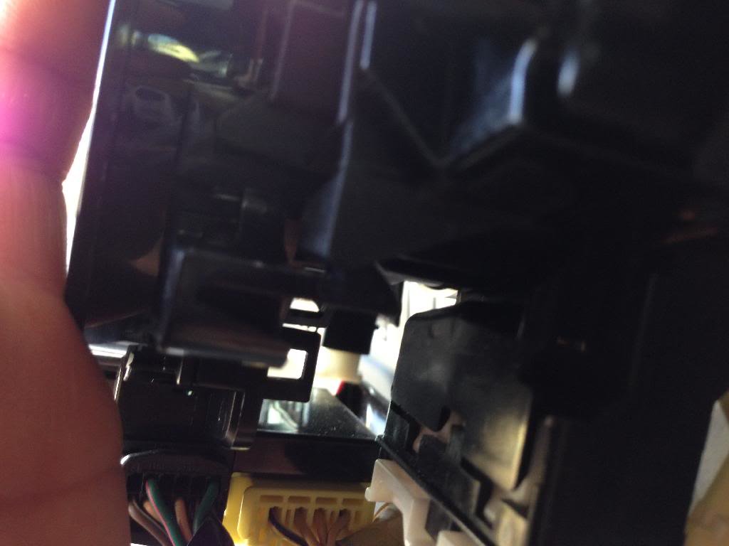

    Remove clockspring by disconnecting 3 plastic tabs. One on the top, and 1 on either side.
    Top.
    C5B8E41E-1C36-4808-ABC2-65A68B10B107_zps_545abd632ae02a0d06f5b4845283c5765bb0049e.jpg
    Left.
    628AA70A-74DC-407C-8F1E-B8A02EA8AEFB_zps_609c2aeeb37bbe99041da5529a9f941664d95bf0.jpg
    Right.
    271DB9AA-E53C-4293-9381-E0DFD5581C4C_zps_385bea3f3745d73f64627c802e6530fd2e6cf1c8.jpg
    Remove clock spring and put it someplace safe.

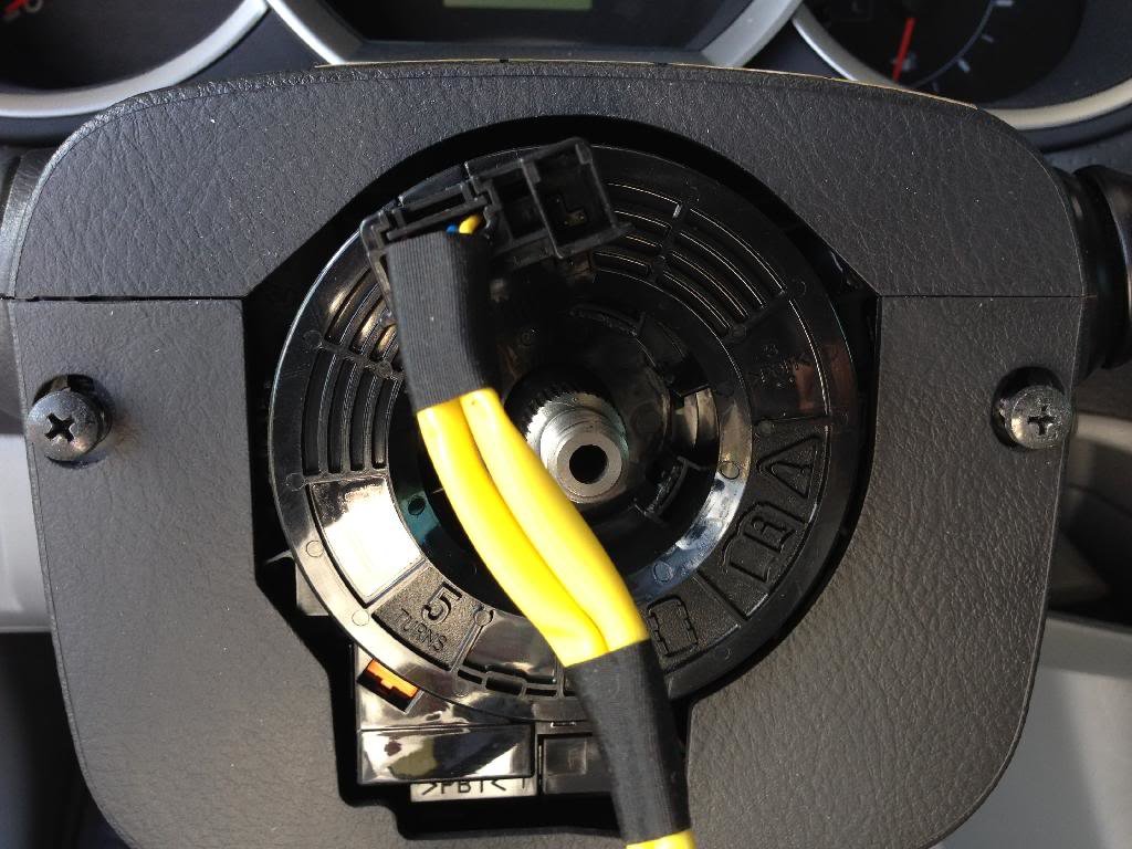

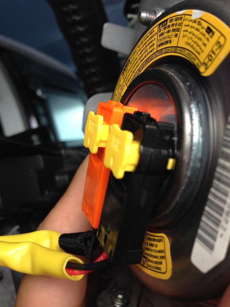

    STEP 12
    Install new clockspring. It's already centered via the orange tab that keeps it from spinning. You'll snap this off later. Reinstall your plastic trim once CS is inplace. After this step, pretty much everything is in reverse.
    04A64667-593A-4808-AD54-845CACEBBE5B_zps_79b7fc537989acf59870833e13c49c7f86ce3d07.jpg
    70761E09-5CD9-43FE-B775-57FD4EC3103D_zps_bc76b26aab7759ef979da9fb6330555b1ad4bbad.jpg
    STEP 13
    Pull your orange tab off freeing up the clockspring to spin, but keep it centered. Reinstall your steering wheel with wires feeding through the top. Line up the steering wheel, making sure its straight. Tighten the 19 mm bolt. Install the brown plug.

    STEP 14

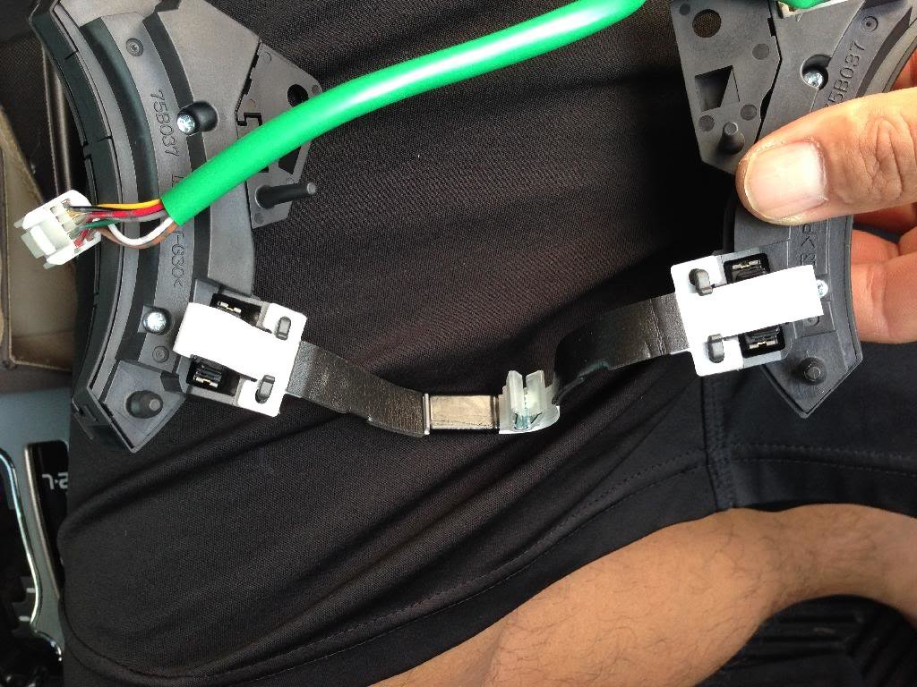

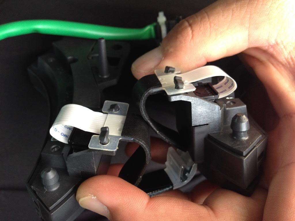

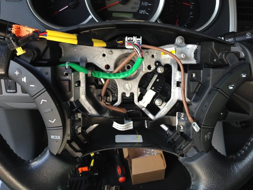

    Connect the ribbon cable to the left and right side switch.
    3483FBDB-22FB-4ABA-96DF-A378AAC384EE_zps_d3c9954917bec8d8759fcab43aae573b23d81915.jpg
    1A4C36C5-0F59-4C37-8900-5272B01C873B_zps_c0d151a9373ca14fc065e13383079e0fb4126aa4.jpg
    STEP 15
    Install the switch pad on the steering wheel. Plug the green plug into the the spiral cable.

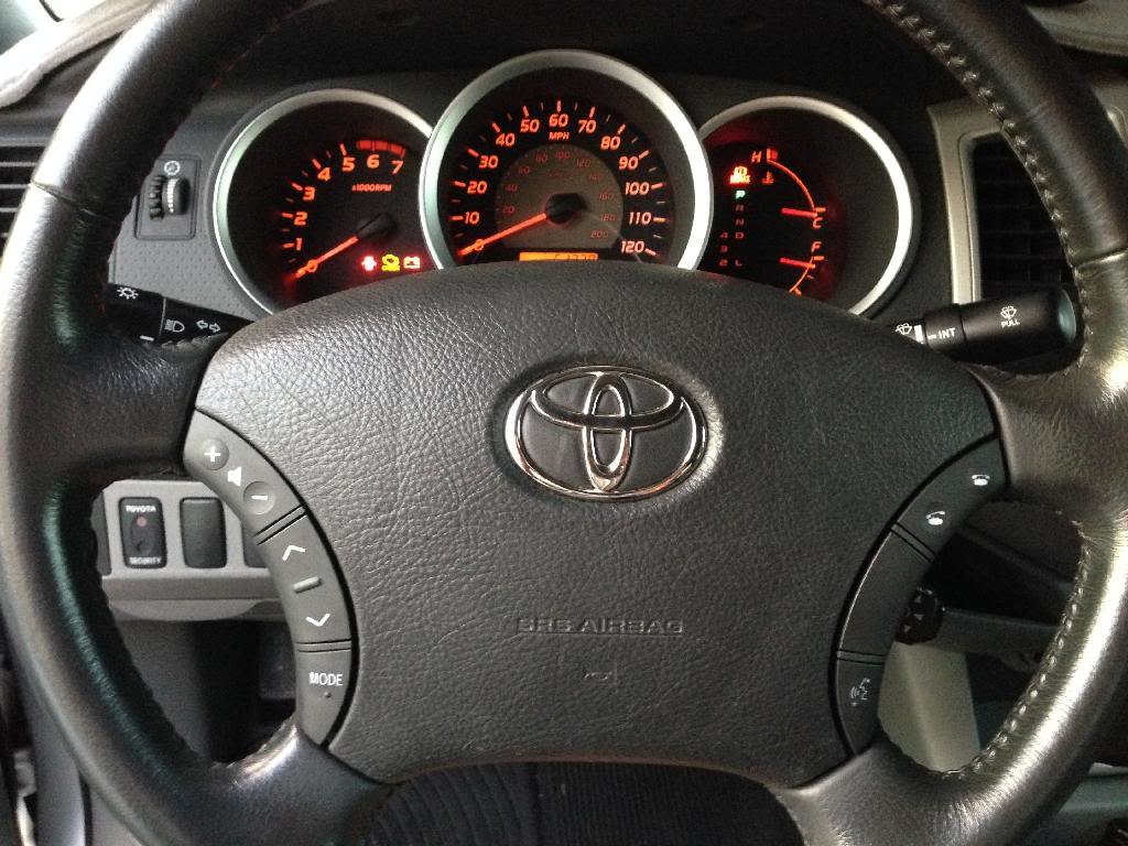

    Volume + & - works, Channel < & > works, Mode function works, Bluetooth calling works and Voice Command Activation function works. Everything's working flawlessly :D and yes this is on an 08 without any of that fancy premium package. :thumbsup:
    Only work to do now is run the mic somewhere clean and stock looking.

    Mean write up bro. Just wondering why was it necessary to put in a new clock spring? Is it just on your 08 or do you think i'd have to do same kine thing on my 13?
  11. Feb 27, 2014 at 10:10 PM
    Jerez
    Jerez SoCal LED Dash Swap
    Feb 1, 2010
    #30488
    17,984
    Rod
    Ontario Ranch
    08 TRD 2wd converted to 4wd
    Estock
    Because the clockspring has all the wiring in it and the correct plugs needed to add the buttons so it's all plug and play
    Hence why they call it a "spiral cable assembly"
    BluLED likes this.
  12. Feb 27, 2014 at 10:12 PM
    osubeav818
    osubeav818 Well-Known Member
    Mar 9, 2013
    #99339
    124
    Los Angeles, CA
    13 Regular Cab, SuperWhite, Debadged
    Viper 350hv, Bakflip Fibermax, Pop n lock
    Oh ok! Thanks. Def gonna try n do this mod now

    Custom body work...boat trailer came of hitch, hit tailgate and Rammed stick thru lower valance while towing boat....hmmm, Maybe I should get a new boat?!?
    Thanks for being so detailed. I just need the new clock spring and it's not the one covered under the TSB...16 pin vs 7 pin. Anything too technical about the CS install portion? Looks pretty straight forward?
    Thanks,
    ~Brett
