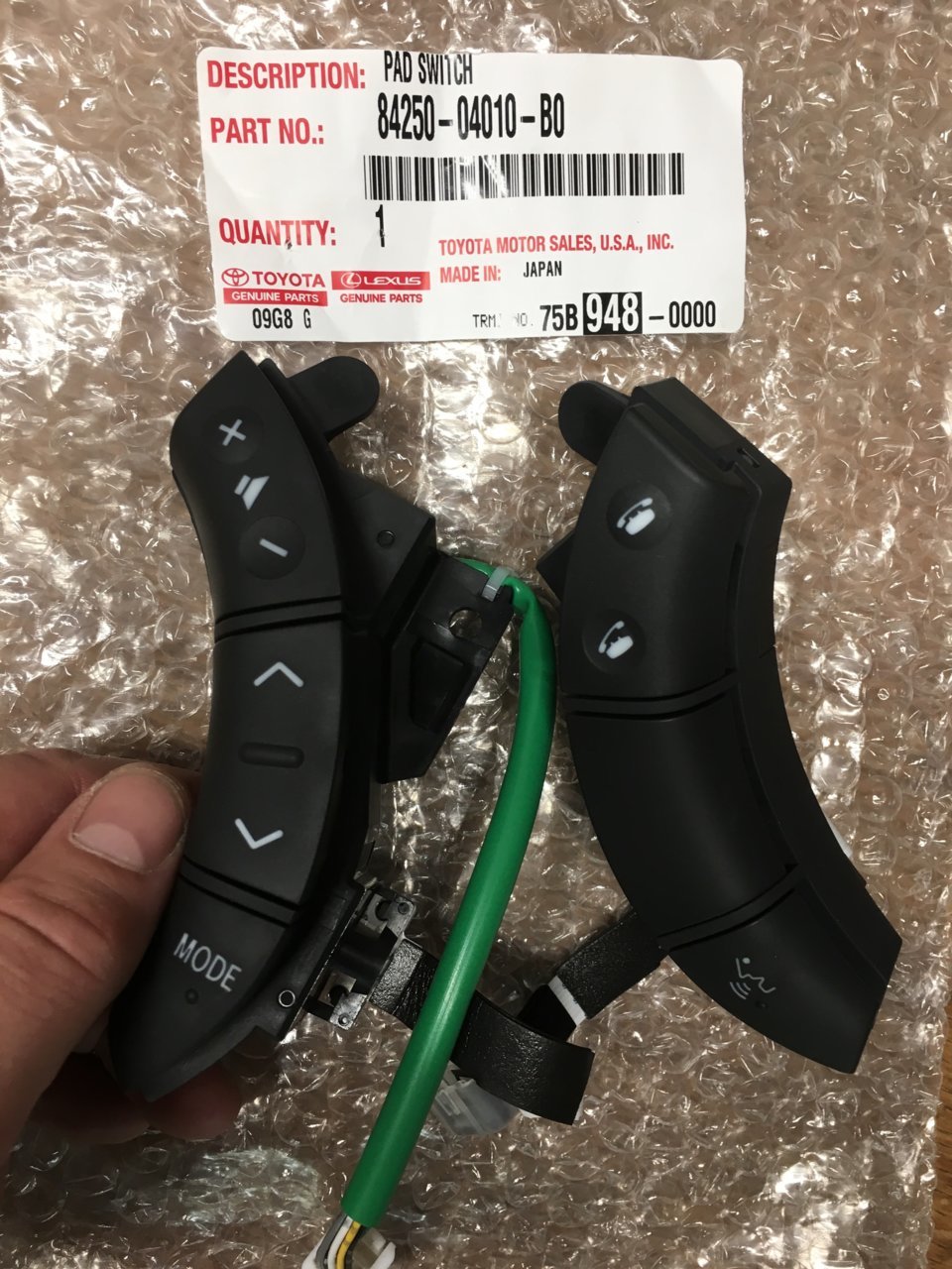

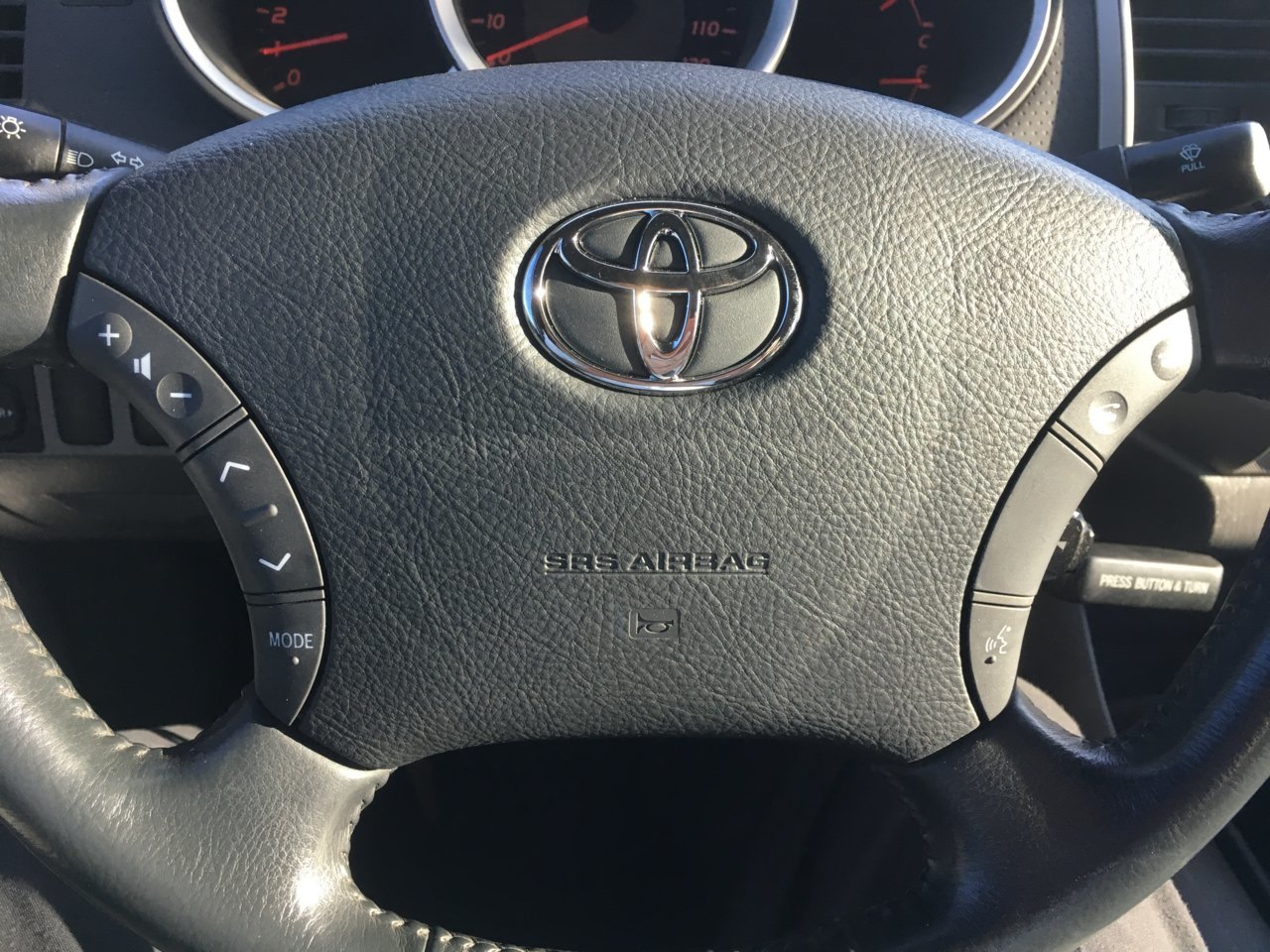

    I too have recently done this swap on my 2007 Taco. A few notes:
    Use the 84250-04010-B0 switches. They come together along with the cable, they're a bit cheaper than the switches/cable used by the OP, and the backlighting matches.

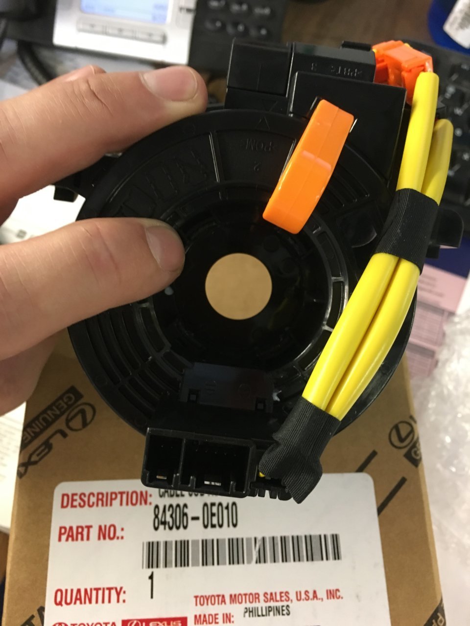

    My truck needed the clockspring. 84306-0E010 is the one you want for all second gen Tacos 05-15.

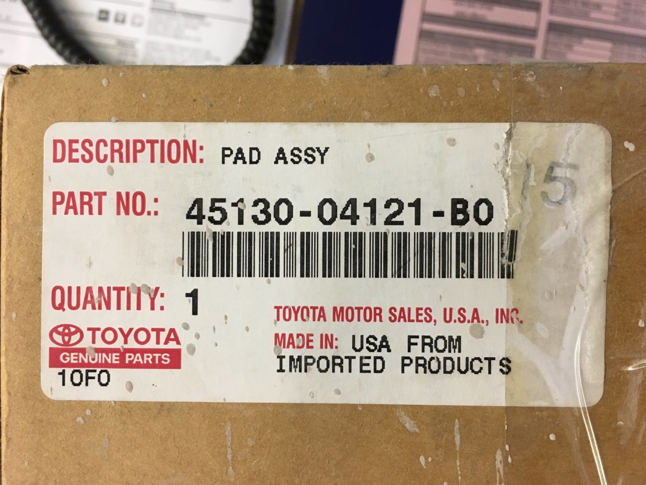

    I used a new airbag. 45130-04121-B0. Should be the same bag for 05-12.
    Axxess ASWC-1 works perfectly with my Older JVC head unit. All buttons work as they should. The voice button brings up Siri. I'm sure it'd bring up Jeeves or whoever your phones' genie is.
