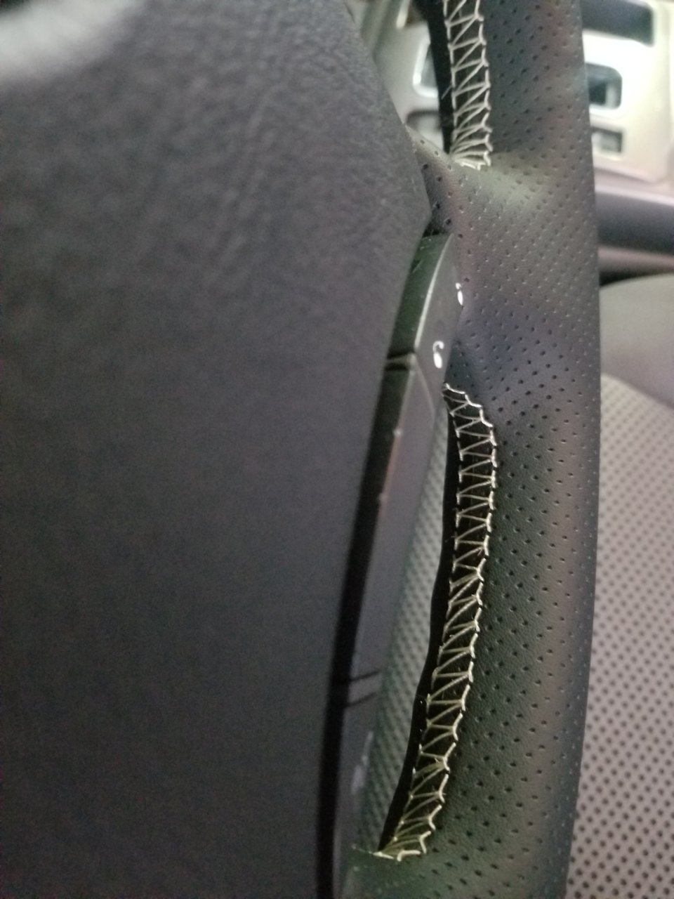

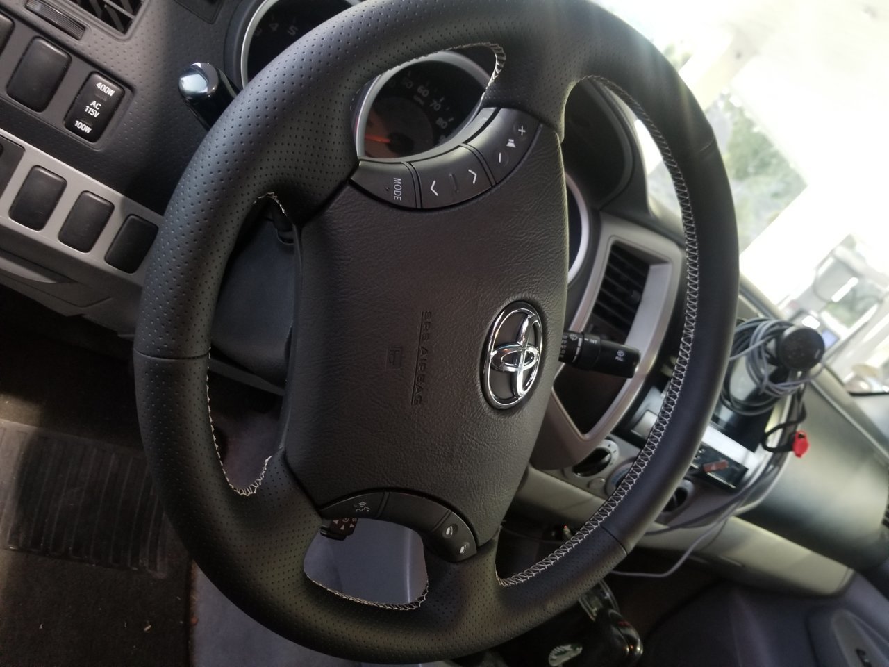

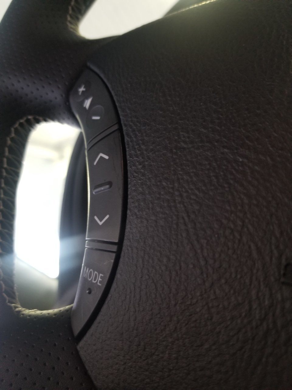

    Okay guys, question. I'm trying to finish up install here on the new airbag cover, buttons and wheel cover. My old steering wheel cover and this new one always looked and felt as if it were sunken way too far in. Did any of you experience this problem I'm having? I had this issue before with old cover, but it wasn't as pronounced as before.
    I was able to adjust one side to get the cover flush with the steering wheel controls, but the right side I'm not having any luck. And it feels like it doesn't want to depress to honk the horn. When I get home I'm gonna take it all apart again.20191227_164338.jpg 20191227_164333.jpg 20191227_164350.jpg

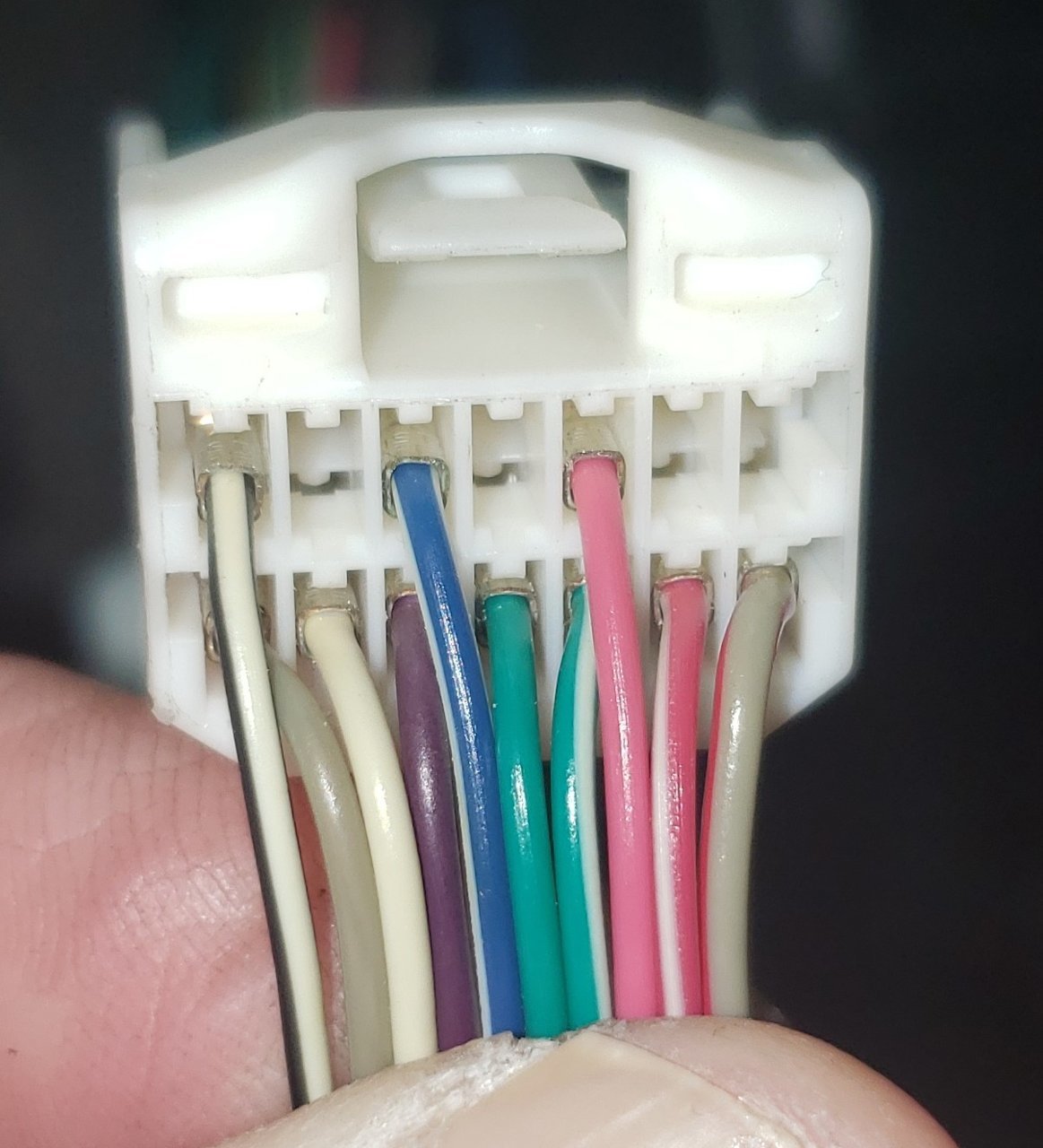

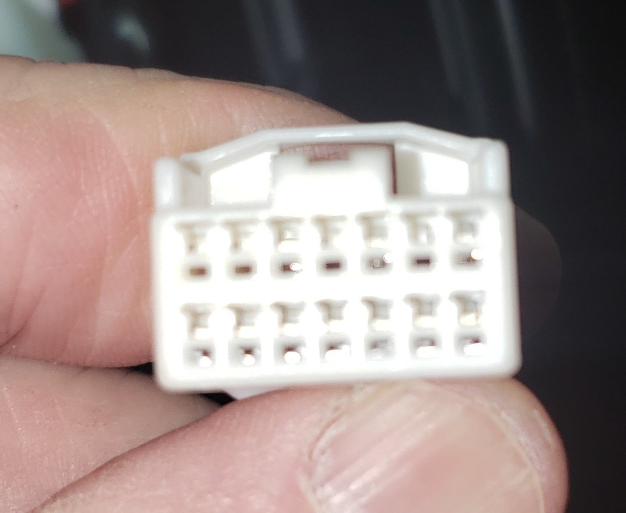

    trying the same upgrade 2008 access cab. got everything but the cable with the three wires that go to the radio to control from steering wheel switch.. connector R1 and R2 are good, I've connected all those wires .... power, ground speakers etc. trying to get the steering wheel controls next, but I don't find the R3 connector. only cable I've got is a 14 pin connector ...
    I've looked at a 2008 tacoma electrical wiring diagram pub, and can only find one 14 pin connectors H7, which is hazard warning signal SW assembly.
    have considered buying another harness, and cutting out cable I need, but cant find which one I might need to go from steering wheel or junction box to radio.
    any thoughts/ideas greatly appreciated.

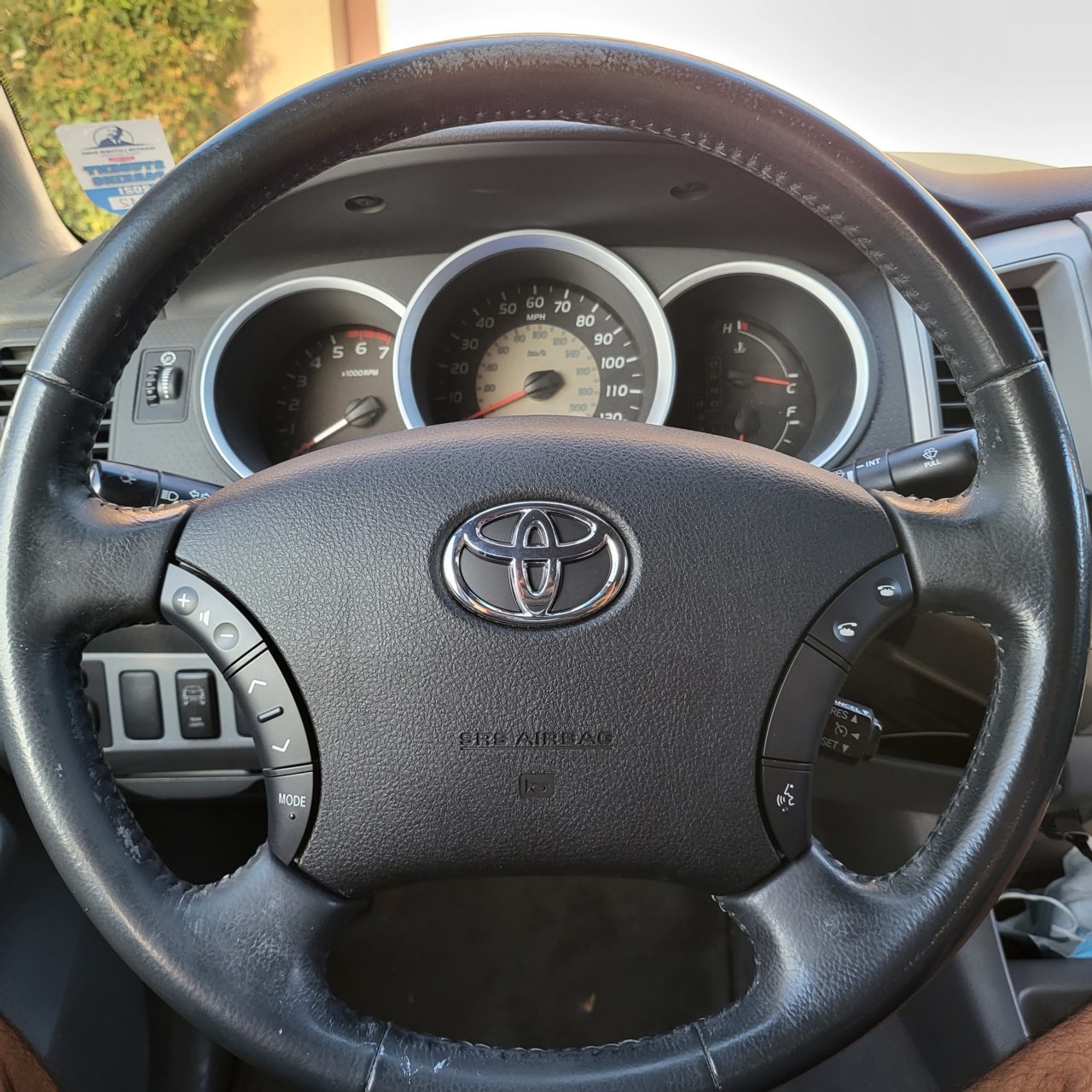

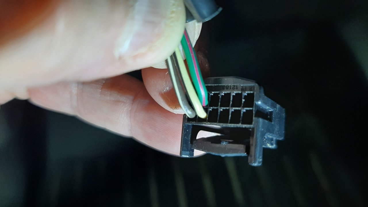

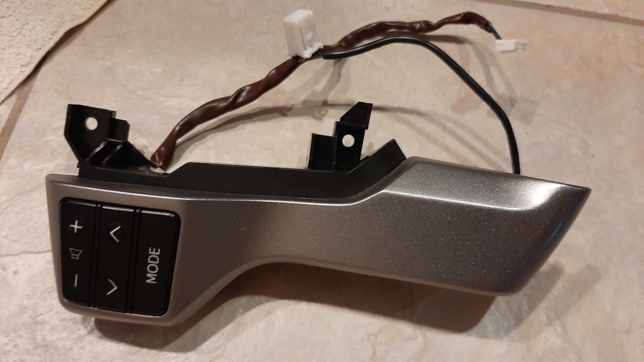

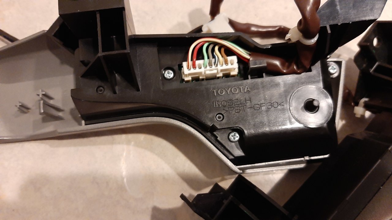

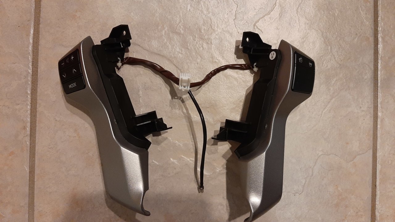

    My problem doing this is going to be 2008 truck, oem HU and 2013 wheel. I have the audio control ornament to add to 2013 wheel in place of the plain one but which spiral cable? Are audio wires the same as in 2008 wheels? Questions, questions & wiring diagram research to make this happen if I really want it. Added oem audio controls to my 2004 xB that didn't come with them so I have dabbled in this wiring fun.................If I can make it happen by just getting a different spiral cable then might be a thing to do............
    Here is what I have to work with.........
    the pair connected via brown wire, 10 pin connector
    audio side disconnected from fon side (silver would have to become black)
    wiring on back side of audio controller..........
    Will have to pull airbag and see what I have on spiral cable side. Would be very groovy to have an unused empty 10 pin female plug inside there.

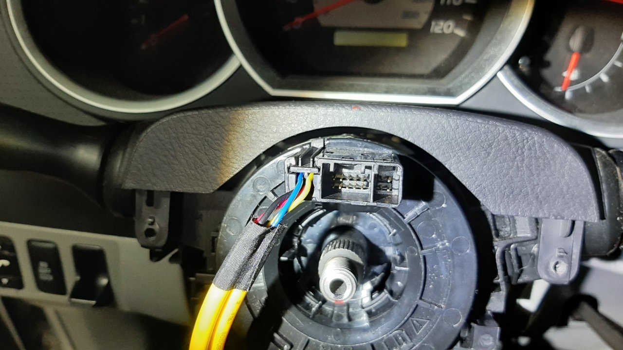

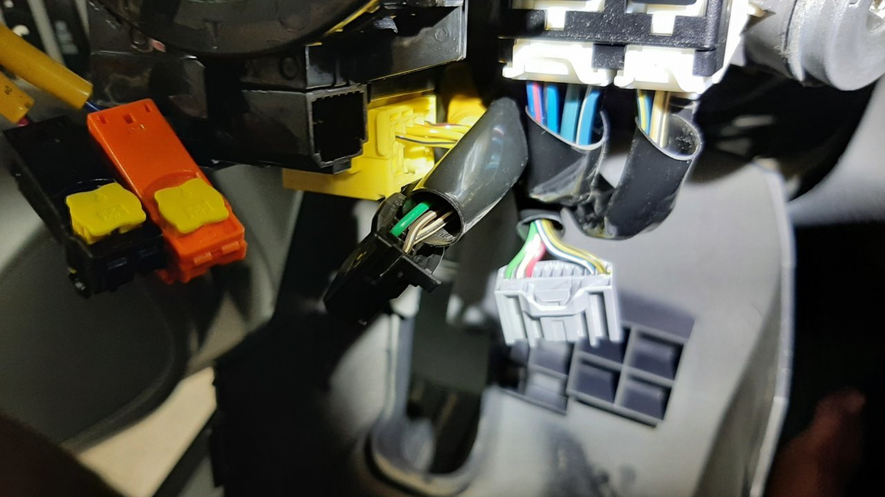

    OK, here's the rub......spiral cable has plug up top for controls with 12 pins. Plugged in the ornament to spiral cable - no go. Took wheel off to check connections to spiral cable inside column cover. Spiral cable has 2 plugs - one yellow for airbag and one black....that only has 3 wires going to it. There is an unused gray plug with 5 wires in column with nowhere to plug it in. So that leaves me at searching thru wiring diagram for my 08 to see which 3 wires need to come out of gray plug and then where in the black spiral cable plug do they need to go in..........I guess at this point. My truck is 08 SR5 RC that came with pretty much nothing but has wiring in place for options from what I have encountered which makes me think the gray unused plug in column may be audio control harness.........and it has a 2012 steering wheel based on ornament configuration. IIRC those changed in 2013?
    Pic of pins in spiral cable..........
    Pic of black spiral connection wires and gray unused harness and wires............

    So, from recent experience with adding this function to my xB, I believe the gray plug is probably VSC or traction control. Going thru Tacoma wiring diagrams kinda proves that connector unassociated to audio based on wiring colors. I believe I have the right spiral for audio controls to work - 12 pins on both ends. I can see the right color wires going into spiral cable plug for horn and cruise control and wiring diagrams confirm color and pin locations. Based on that, I found that there should be 3 wires coming from stereo to spiral to make audio controls work.....yellow/black from pin 8 on stereo plug to pin 5 on spiral side, white/red from pin 6 on stereo plug to pin 4 on spiral side & violet/white from pin 7 on stereo plug to pin 6 on spiral side. I am betting those are unconnected to anything on back of stereo. So it seems I just need to make a 3 wire harness and run it from stereo to spiral. Just gonna have to find right size pins to push into spiral side connector and it should work. Basically this is what I had to do on the xB...a 3 wire harness from stereo to spiral to make the 06.5 oem wheel with audio controls work on my 2004 that did not come wired for that option. Looks to be the same case for my truck.

    column harness to spiral only has 2 wires for cc and 1 for horn in 1,2 & 8........need to push audio control wires from stereo into 4,5 & 6.20220121_163237.jpg
