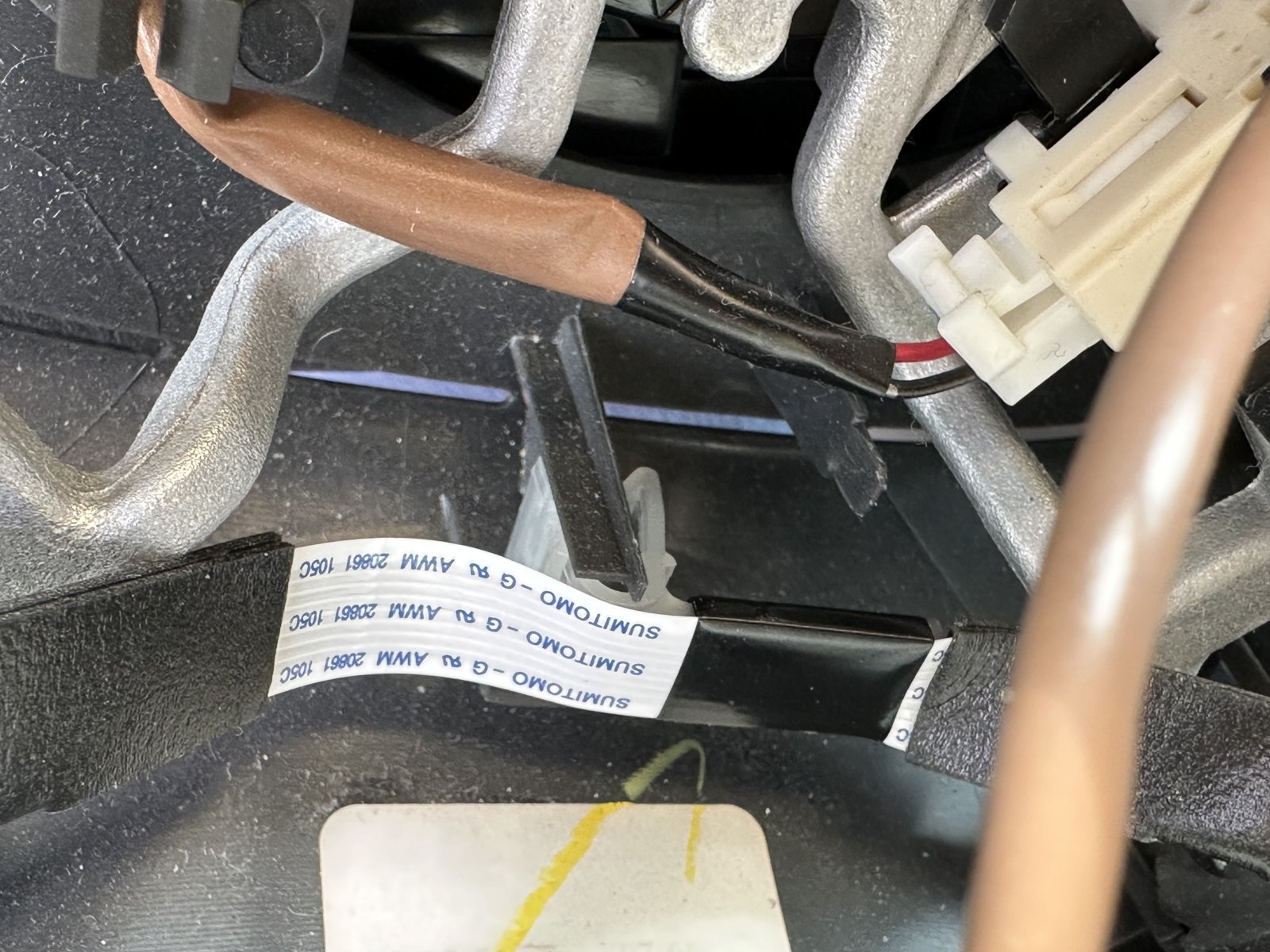

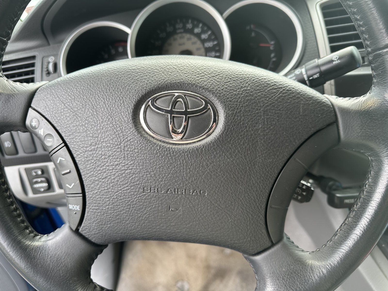

    Just completed the upgrade. It took about 10 minutes to complete. One of the easiest upgrades I've performed on my Tacoma.
    There were a few things that weren't mentioned in this thread, such as the way the side covers are attached. In order to remove them without damaging them, try to slide something really thin like a pocket knife in the seam on the front side, then slide in a slotted screwdriver to pop those out.
    Wasn't sure where the little tabs on each end of the data cable were supposed to attach, but I noticed they were about the same distance apart as the two prongs on the button module. (Follow up: I went back and looked at the original post, and that's exactly where he connected the tabs.) Also wasn't sure where the center clip was supposed to attach, so I just clipped it on a plastic arm in the middle.
    Starting point:

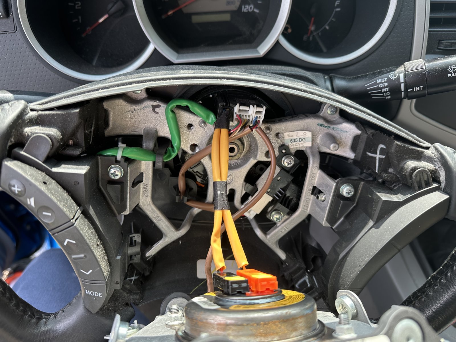

    Picture behind the air bag. You can see the Phillips screws holding the button modules in place. There are also three plastic pins in the back of the modules to hold them in place. Push the modules down where they are seated before replacing the screws:
    You can also see one of the Torx bolts sticking out just to the left of the Phillips screw. Noticed the airbag didn't want to sit flush on the right side, so I saw the Torx bolt sticking out when I pulled it back. The airbag seated normally once that was clear.

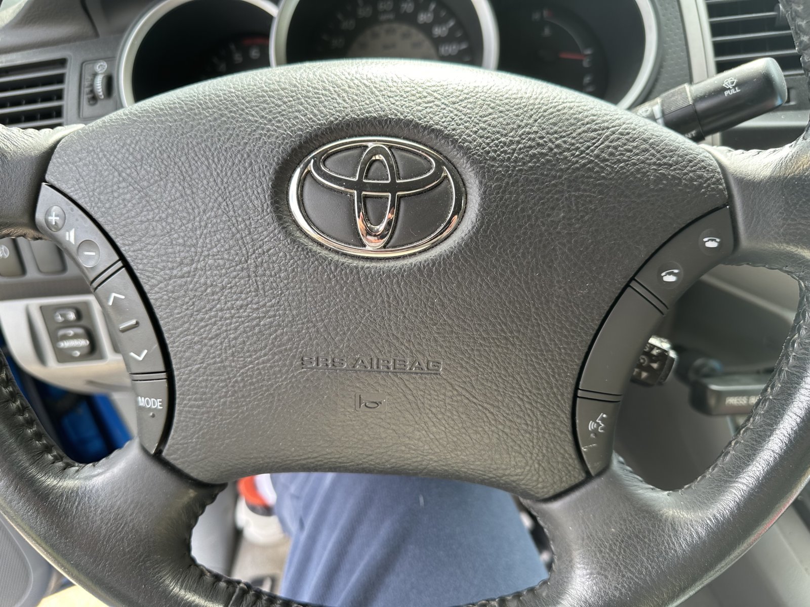

    A quick tightening of the Torx bolts and replacing the side covers meant I was done:
    I reconnected the battery, and the Tacoma is ready to go.
