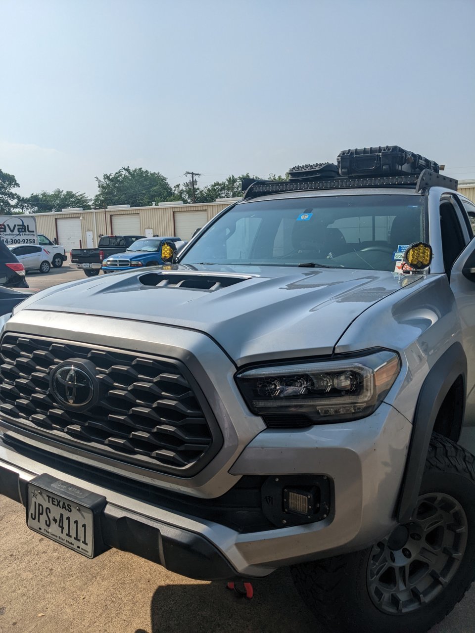

    Has anyone changed their DRLs to amber? Can it be changed with the light still installed? 3rd gen
  9. May 22, 2022 at 7:10 AM
    #189
    Tacospike
    Nov 19, 2018
    #273198
    14,420
    512
    Two Trucks
    Yes people have. The halogen headlight or the OEM led headlight? Which one are you asking about? It has been done to both
    Zsaenz1[QUOTED] likes this.
  10. May 22, 2022 at 7:47 AM
    #190
    Zsaenz1
    Zsaenz1 Member
    May 25, 2017
    #219945
    15
    2017 Silver Tacoma TRD Off road 4x4
    Weathertech floor mats, ridgid fog light kit
    I have the projector type. Not sure if you have to access the connector on the bottom of the assembly and have to Uninstall the light or if it's in one of the two other access holes.
  11. May 22, 2022 at 7:50 AM
    #191
    Zsaenz1
    Zsaenz1 Member
    May 25, 2017
    #219945
    15
    Here's mine
