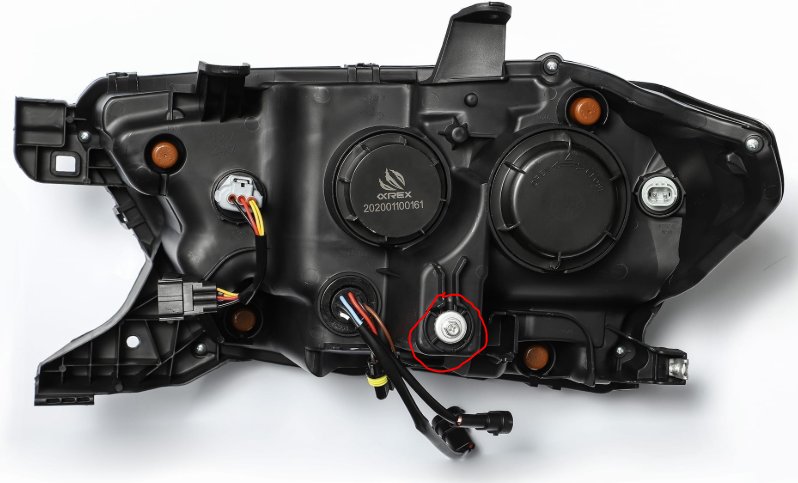

    I just looked at the brand website, definitely looks like there is an adjustment screw on each light. If you can’t get them adjusted you should definitely get something that you can adjust or fix the mounting tab.

    There's got to be adjusters on the rear of the lamps. If not, contact the manufacturer for a refund.

    As others have mentioned there should be a vertical adjuster on the back, it looks to be in the same spot the OEM one is in.
