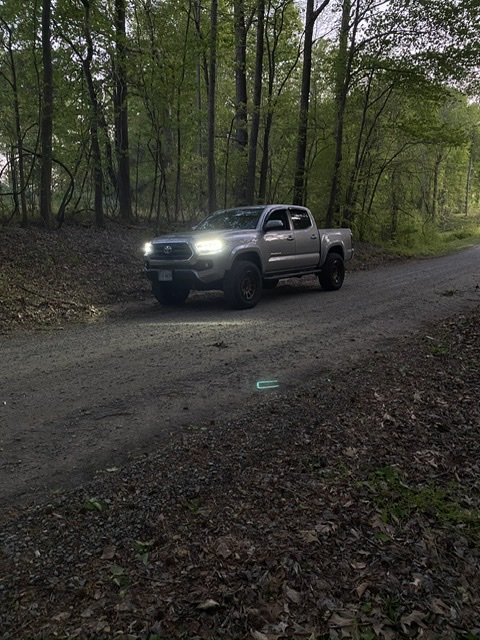

    6168DB8B-F37B-4334-A112-DAA3844BE57B.jpg this is just the DRL on....

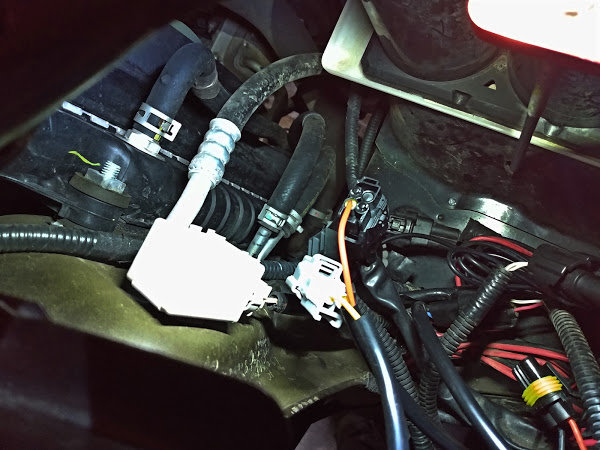

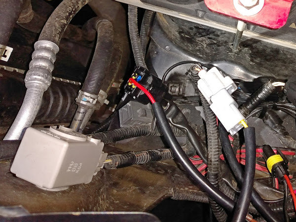

    The Alpharex converter harness needed for TRD trucks had two cut wires with exposed conductors. According to Alpharex, it's the result of a last-minute rework at the factory.
    rDB2hEq_8PYjKfCJTfQUF-GHsUd9wp5PwQRlWUPW_c964474c3a50fb4037fab9012de852f5eef1c27d.jpg
    I potted the connector with some liquid electrical tape, Gardner Bender P/N LTB-400
