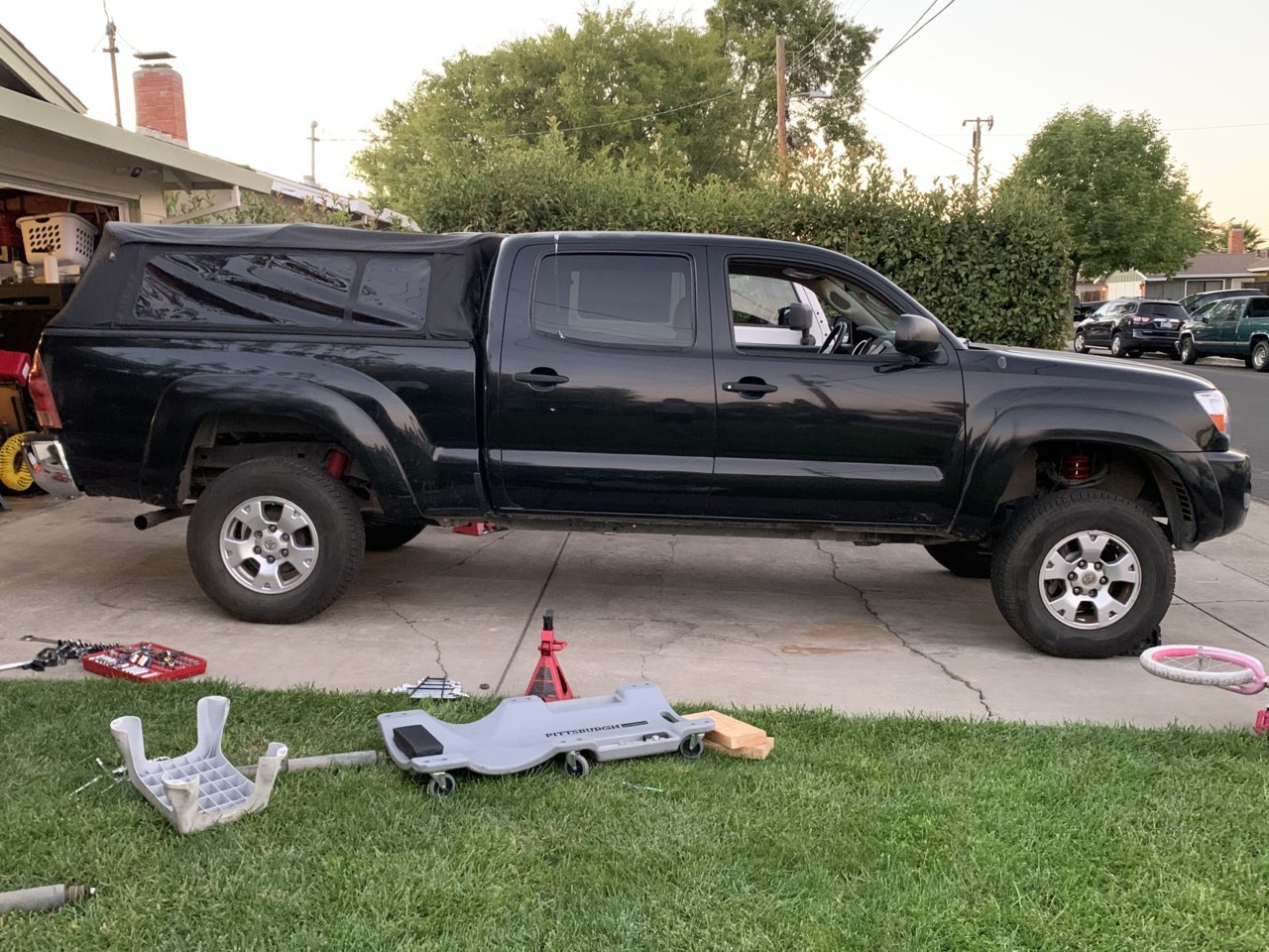

    As title says. Installed Trd pro fox shocks with a 1inch spacer in front and 1 inch block in the rear. Feeling nose high.
    One option. Take out spacer up front
    Option two. Do a rear leaf pack in the back for maybe 2 inch?
    probably should get upper control arm for the fronts.
    Only a 2 wheel drive. Which won’t see any trails or anything crazy.
    What do you guys recommend?

    It’s on the driveway but I still feel it’s nose high

    Personally, I'd get rid of the spacer.

    yea, ditch the spacer. those coilovers were designed without the spacer and it will defeat the purpose of that tuned shocks

    What leaf pack are you running?

    Stock
