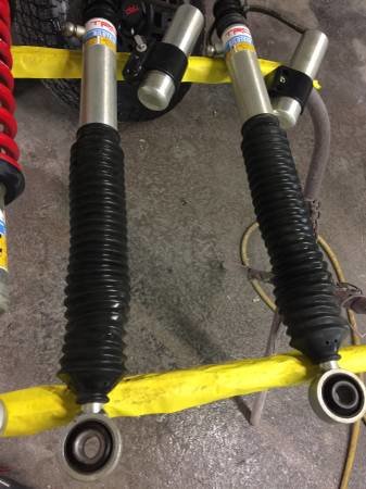

    Here's what I installed on the front
    Here is what was supposed to go on the rear plus a 3 leaf AAL from Headstrong

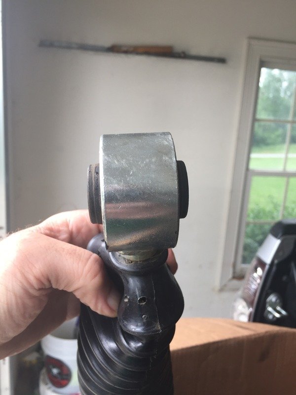

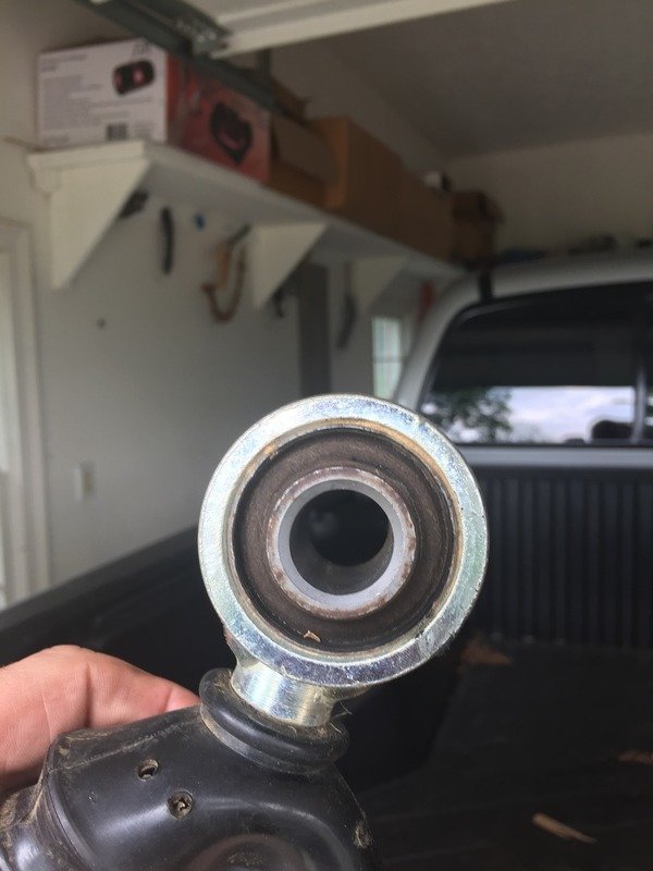

    the bottom of the rear shocks were too wide to fit into the mount and the bolt holes in the shock were bigger than the truck holes. What can I do to get them installed, if anything? Is there a bracket that one can buy that will fit between the shock and mount to accommodate the size difference?
    The next issue is the front coil/shock pack which was supposed to give me 1 3/4" lift didn't give me any lift and the AAL in the rear gave me about a 2" lift. So the front is 20.5" center of hub to fender and the rear is 23.5".
    Needless to say I am a little disappointed.

    Grind down the shock eyes and find a bushing at the LHS that fits between the bolt and the eye.

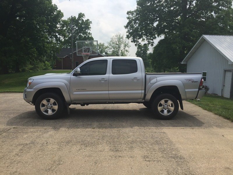

    Actually I had spacers on the front and they measured 22" before the swap, now the front is 20.5". That's a 3" rake, is that too much?

    Here it is now

    Cycle = run the suspension up/down through its travel then measure at its resting position.
    I don't think it looks too bad. Put some weight in the back and call it good. That rear AAL will probably settle a bit and you'll end up with less rake. It's not going to adversely affect anything, it's just whether you can live with how it looks.

    Taco lean

    Sine there's obviously at least 2 snap ring grooves, is there any chance that there's 4, like the 5100s?

    Is the rear lower shock mount only a little bit too narrow? That happened to me with my 5100s. I just took a monkey wrench and bent the tabs outwards to get it to fit. Then lightly tapped it in with a rubber mallet. Haven't had any issues.
