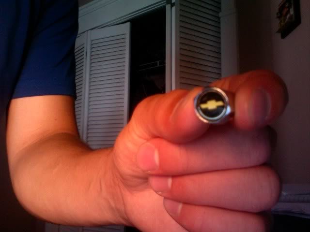

    Hey Guys,
    I installed these TRD valve stem caps (with locking nut) that I bought from a member here, and now months later my TPMS went off. I just refilled all my from 30 to 33 psi, and it still is on. When I turn on the truck it turns on, then turns off for a second, then turns back on and stays steady.
    The valve stem caps are the only things I have changed in a while and when I came back home I took off the caps and put on the original ones and reset the battery for 20 minutes hoping that it would reset the tpms... however the light is still on.
    Anyone have the same issue? Any advice on what I can do to get this fixed? I attached a pic of the stem I installed.
    Thanks

    Be careful with those valve caps.... One of my cap's logo came off and it looks like this:
